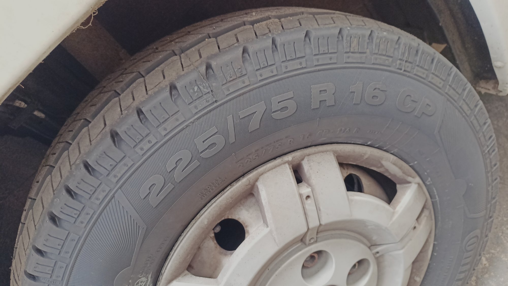

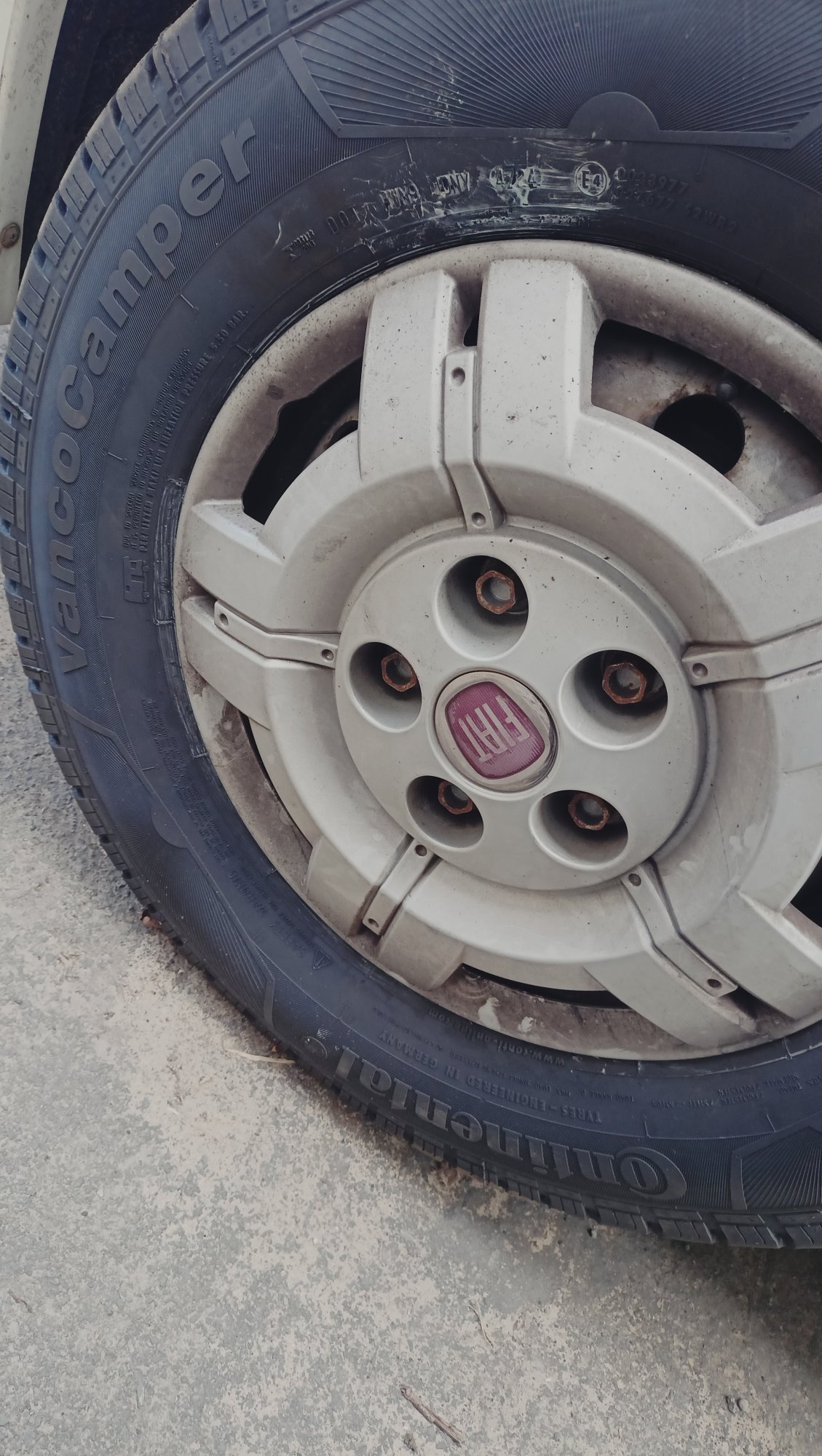

They are actually 116 load rating if you look at the pics.

Strange, the only camper tyre on their site is the VanContactCamper.They are actually 116 load rating if you look at the pics.
View attachment 141379View attachment 141380View attachment 141381
Guess that has replaced the VancoCamper.
Nice clean wheels there . Rest of the van is , think , being held together by the paint .Get yer wheels cleaned.![]()

Still a decent bit of tread on thatBecause they have to cover their arses ....

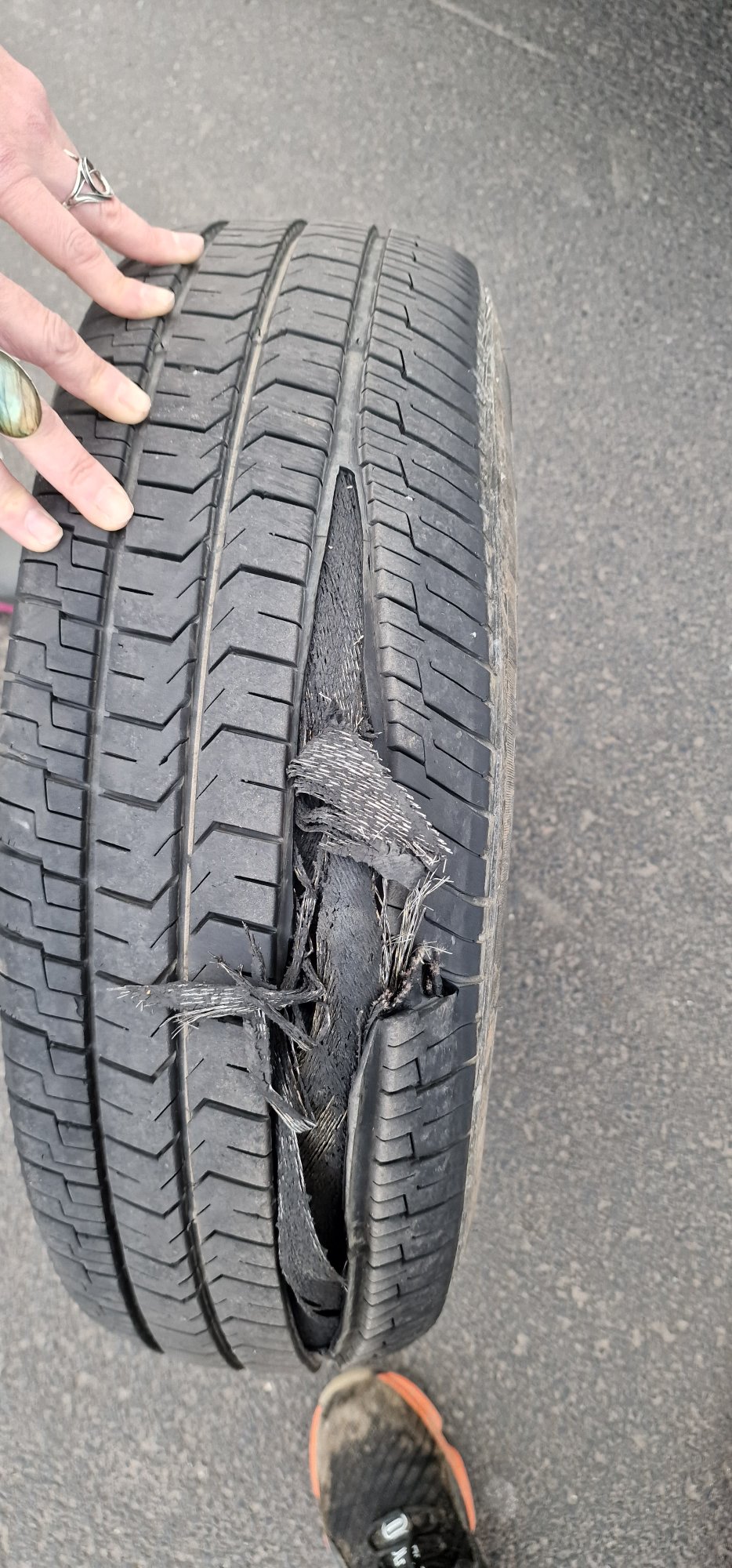

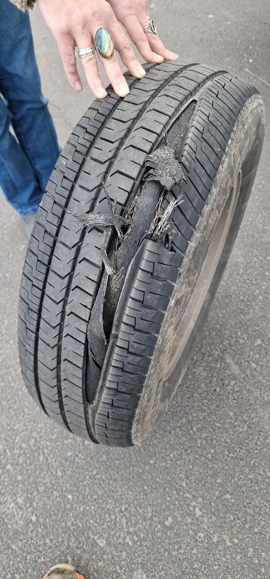

I'd rather not chance a tyre failing on us like it did on the way back from Wales a while back ....
Fortunately low speed and not on the largely 60mph twisty descent from Trawsfndd to Bala road .

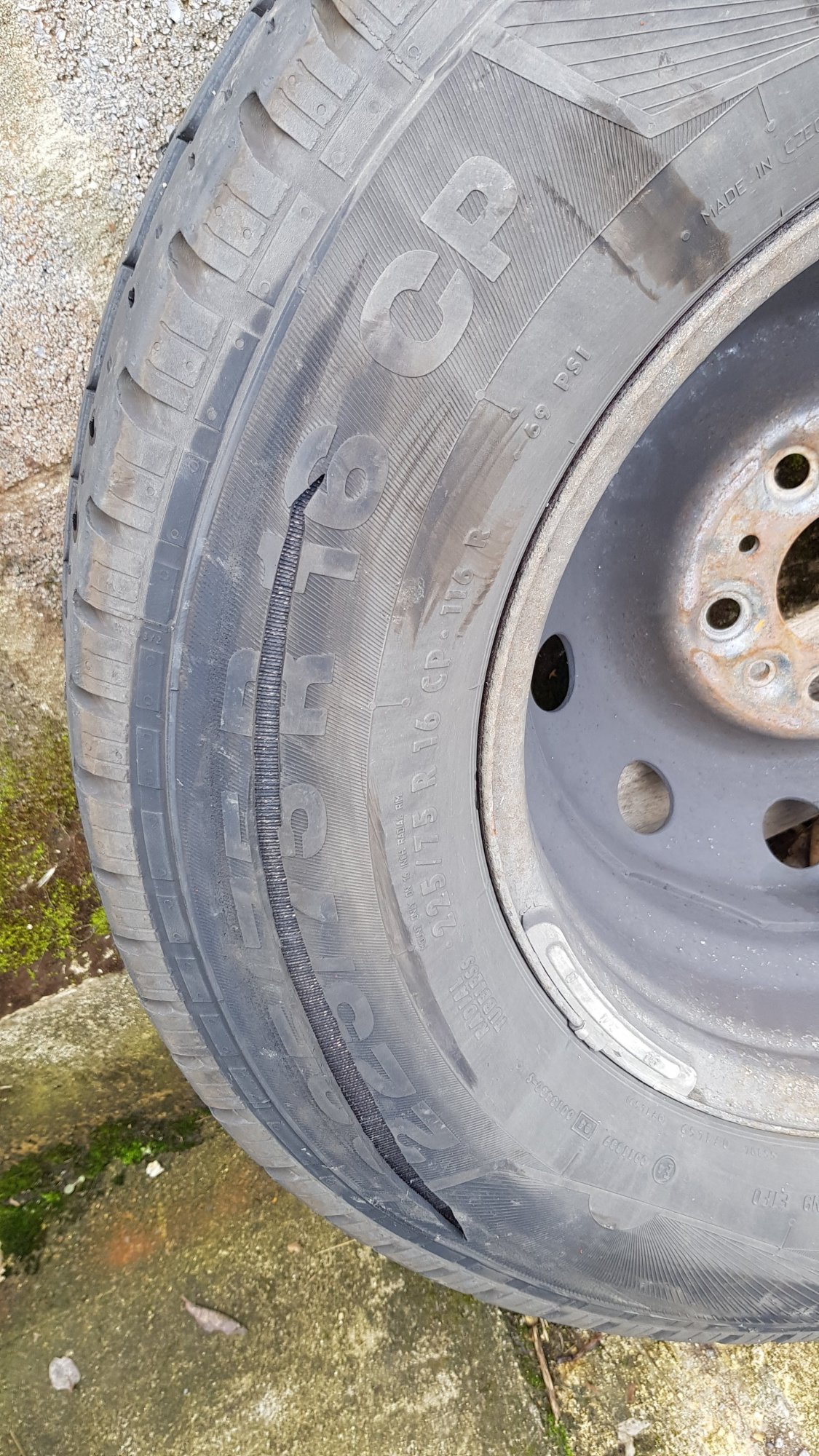

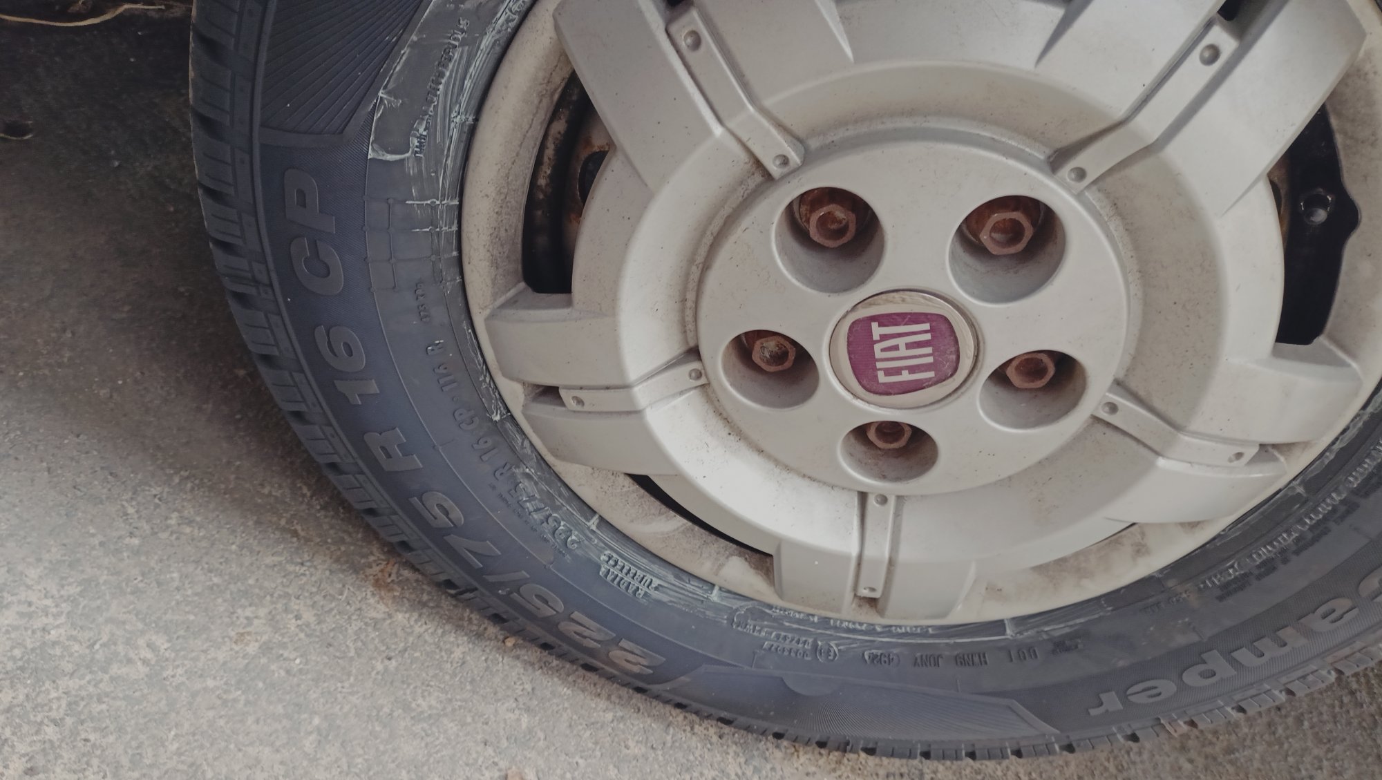

These CP tyres do split 116 load rating, replaced with 120 L.R. for extra safety with ain the garage.View attachment 141388
The load index is 116, that tells you what they are rated too, the replacement 121 load index tyres I'm guessing will not have a CP mark and not be 'official' camping tyres as the exceed the maximum allowed for CP construction.How did that happen and how old is it with it being in PSI? I Notice it also says 69 PSI. They are 5.5 bar or 80 PSI on mine. They are rated to 2400kg aren't they?
If your ride is comfortable at 80psi then keep it at that, I found that it was too high when I had campingcar tyres but my van is only 3500kg, I used 55psi front and 60psi rears which I found ideal for me.
