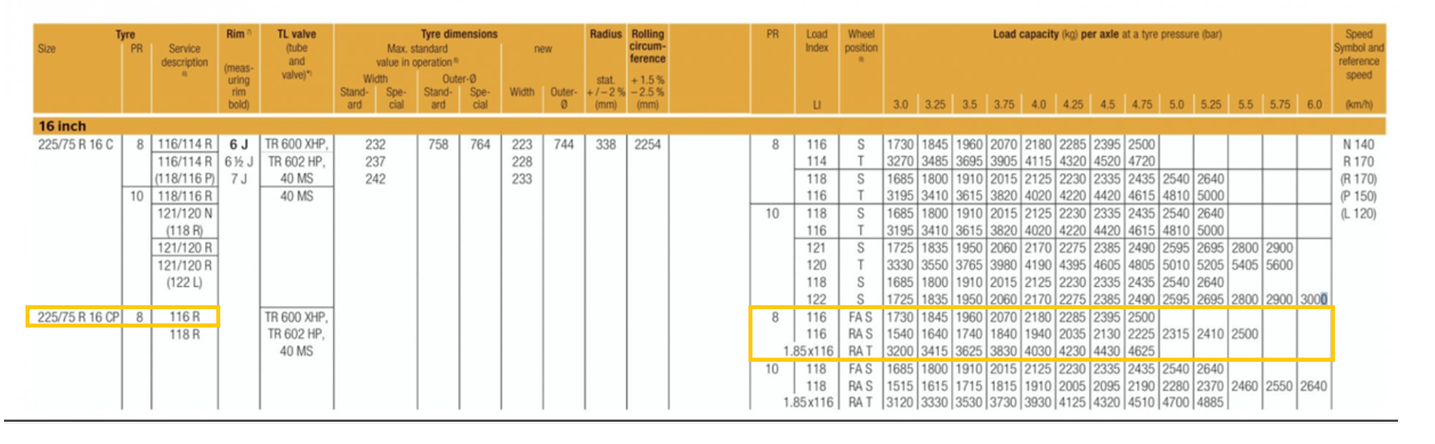

I have had a reply from Conti. My email last night must have prompted them to look at my previous email and request for advice.
This is there reply.
Based on the 225/75 R16 CP 116R and providing that the weights given are the maximum axle weight you will be subjecting the tyre to; the inflation pressure guidance is:
Front: 1800kgs- 3.25 bar (47.1 psi)
Rear (Single fitment): 2200kgs- 4.75bar (79 psi)
Rear (Twin Fitment): 2200kgs- 3.0bar (43.5psi)
I have highlighted the info you should refer to in yellow and then look at the top of the page for the inflation pressure in bar.
Also, you need to know that,
FA S means Front axle single fitment.
RA S means Rear axle single fitment.
RA T means Rear axle with twin tyre fitment.
There are some variations in pressures given from different sources. The reason for the confusion and higher pressure from some sources on the rear is because the ETRTO (European Tyre & Rim Technical Organisation) in their standards manual have a paragraph that suggests all CP type tyres fitted as single fitment rear tyres on a camper should be inflated to a minimum of 5.5 bar (79 psi), even if the load on the axle is such that the inflation requirement based on the standard ETRTO tables and manufacturer data is lower. This advice is because of the likelihood of overloading or uneven load distribution in camper applications and the need to compensate for this with a higher inflation pressure.
Our current stance remains unchanged when calculating recommended pressures which is directly calculated from the given loads provided by yourself against the pressure recommendations in the technical data book and this is the information we provide.
However, given the information in the ETRTO manual we give this pressure as a guide and should only be used on the understanding that no single tyre will be overloaded, and the axle loads given will not be exceeded.
If you have any questions, please do not hesitate to call or email.
I also emailed my garage who fitted the tyres and they just said they go on the guidance recommended by Kimberley Caravans but would not recommend going down to anything under 75 psi all round.
The ride is harsh but by the sound of it I shouldnt lower the PSI on the rear but the jury is out on the front.
