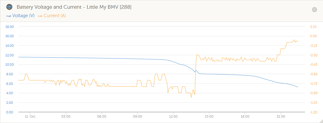

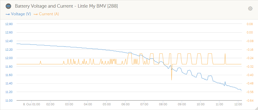

Tell you guys what? I can't wait for those new batteries to arrive at Alpha Batteries!
Check out what my excessive power use is doing to the "200Ah" Battery Bank!!
Down from 12.33V to 11.23V after drawing a maximum current of 0.3A - that is just 3.6Ah in the last 12 hours!

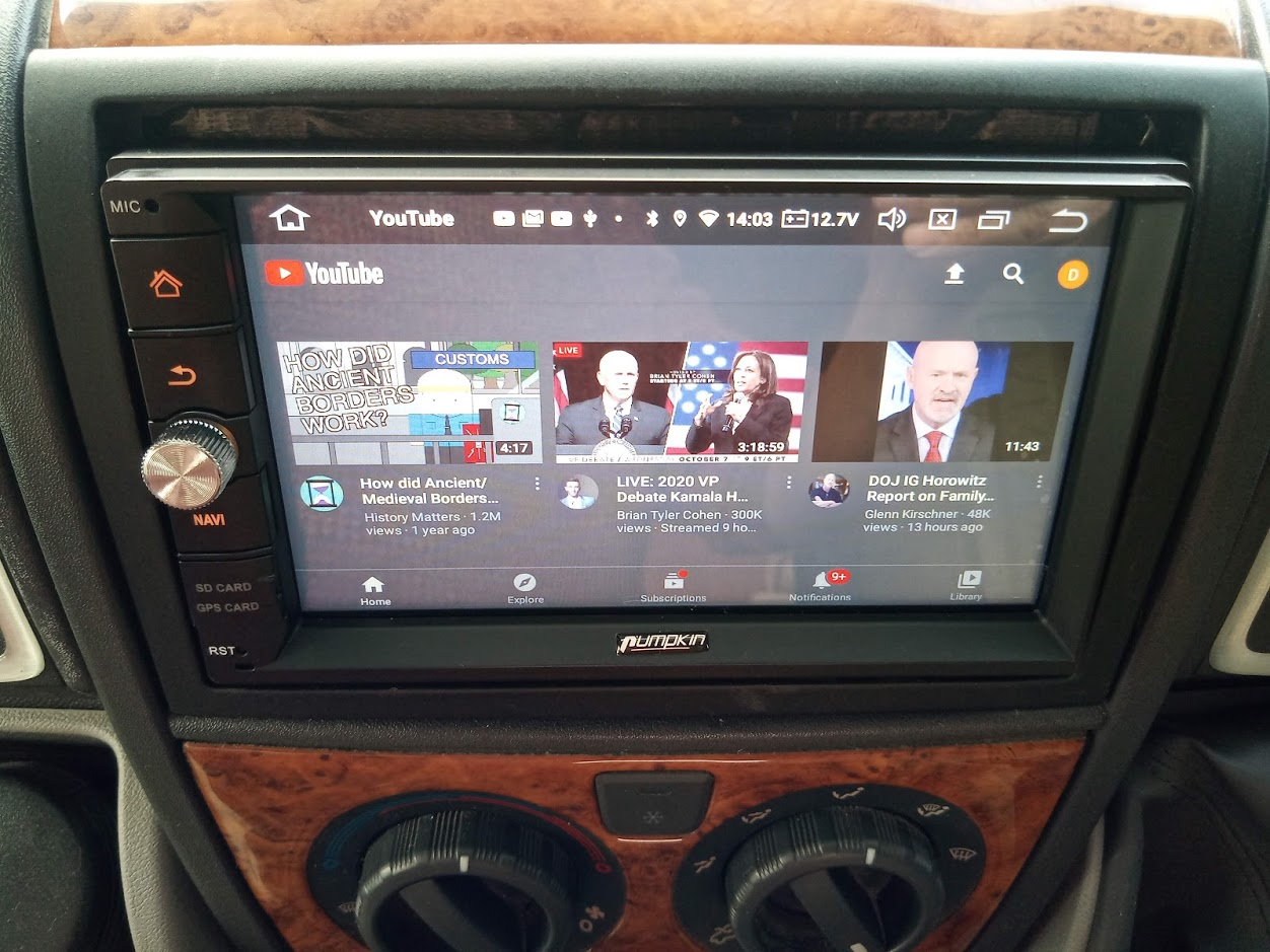

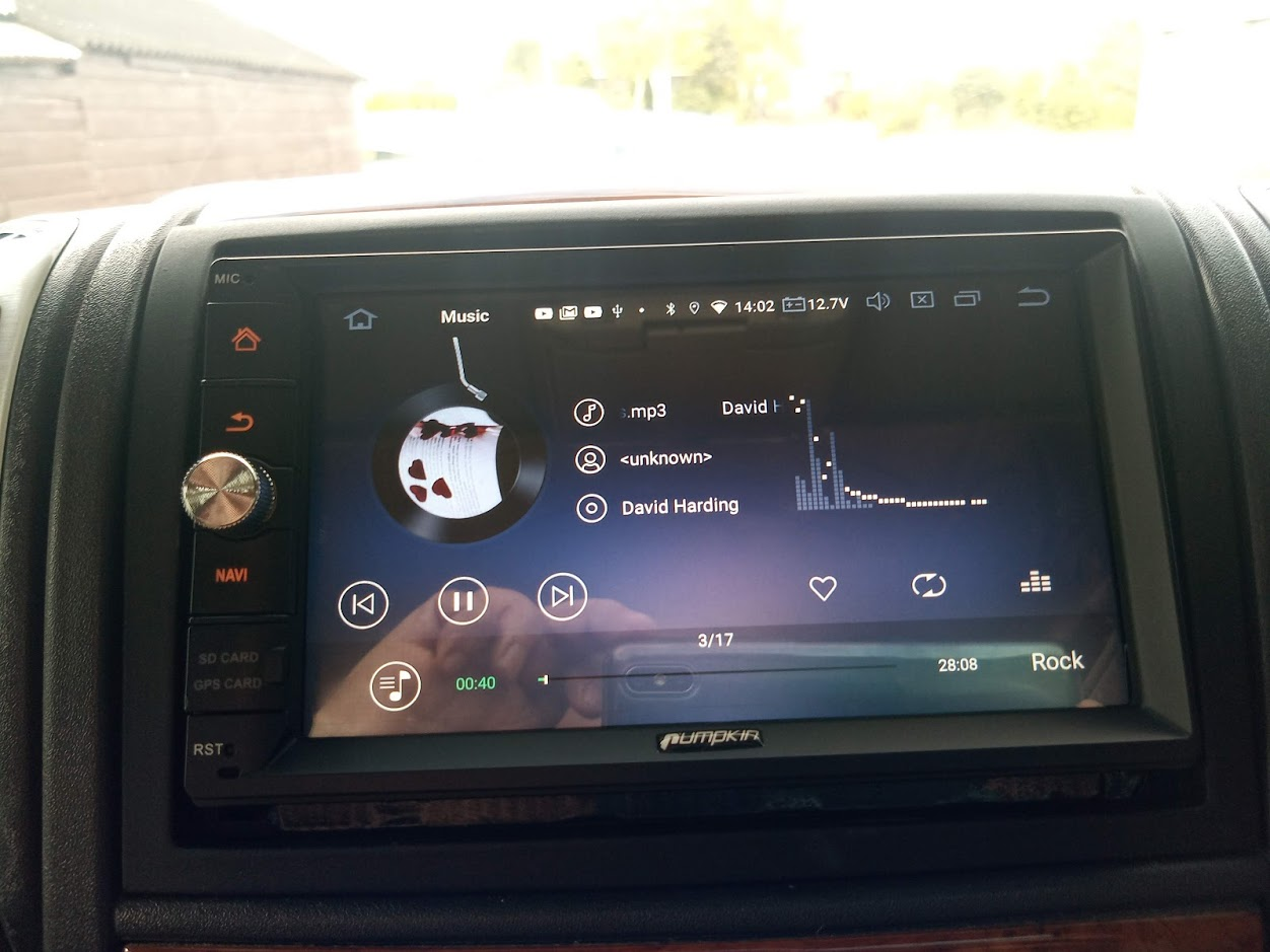

Continued the Audio installation today.
The Ducato Centre Console is a bit of a weird size - width wise it is a standard DIN size, but height is a bit taller than a Double-Din.

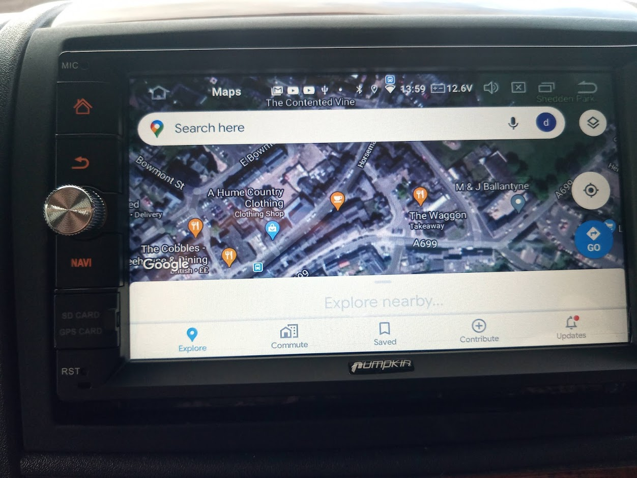

So installed an Adapter Kit (https://amzn.to/3dadTXs) and fitted a 'Pumpkin' Android based Full Screen Head Unit
Still need to adapt the panel that is designed to fill in between the radio bezel and the fascia (the radio frontage is a bit oversize than 2-Din) to tidy the gap but nice and secure.

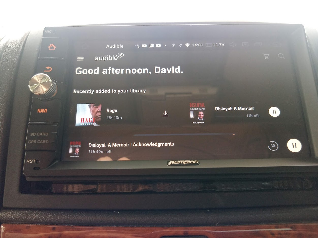

Pleased with the unit. Got Sat Nav via Google maps (as shown above) and being essentially an Android Tablet can install the various apps from the Play Store. so for example got Audible for Audio Books, Amazon Music for music streaming as well as USB Connectivity, YouTube (only stationary use of course!).

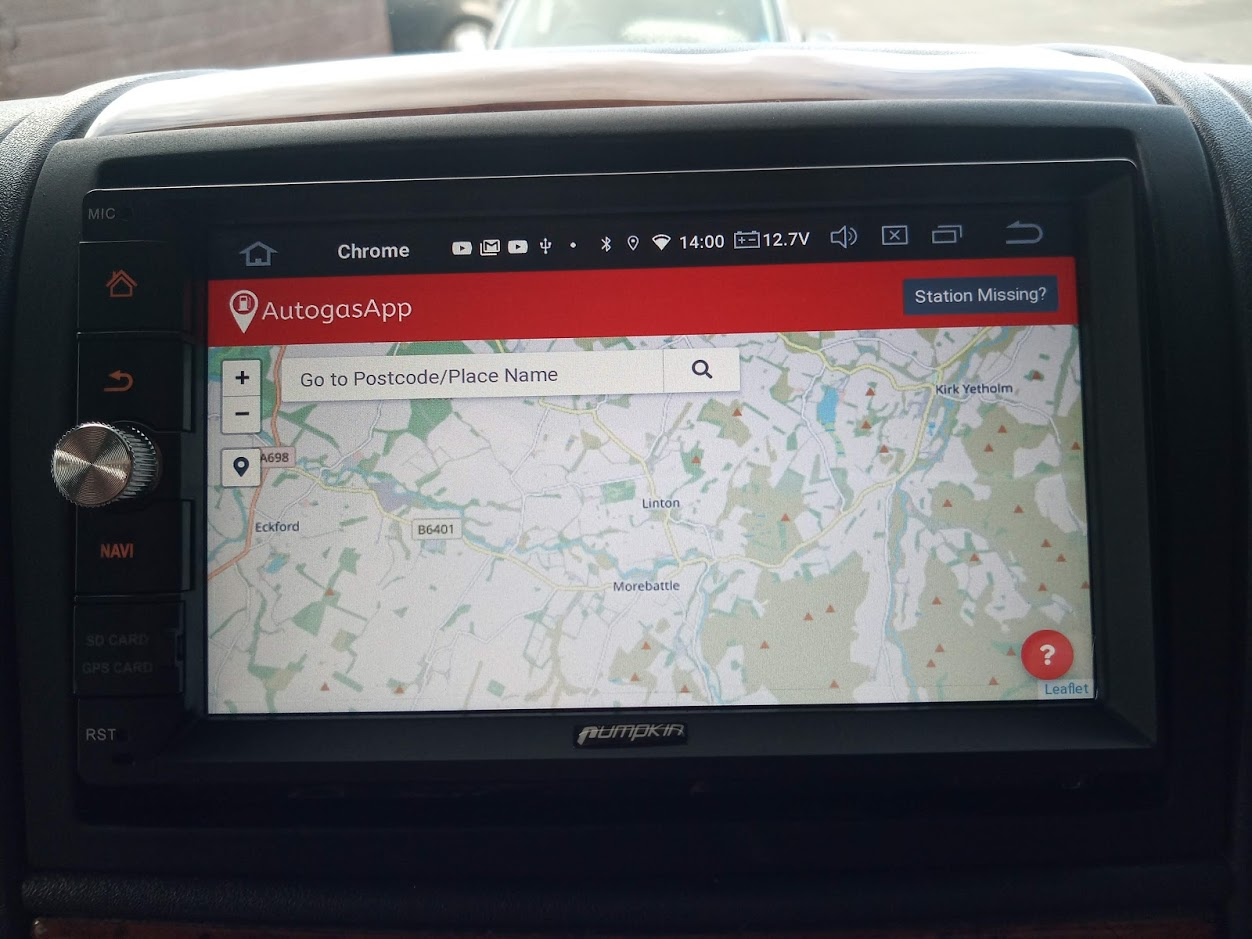

Another handy app is the AutoGas App. With this on the unit, can search for LPG and then navigate to an LPG station via the Nav program
Dead handy :)

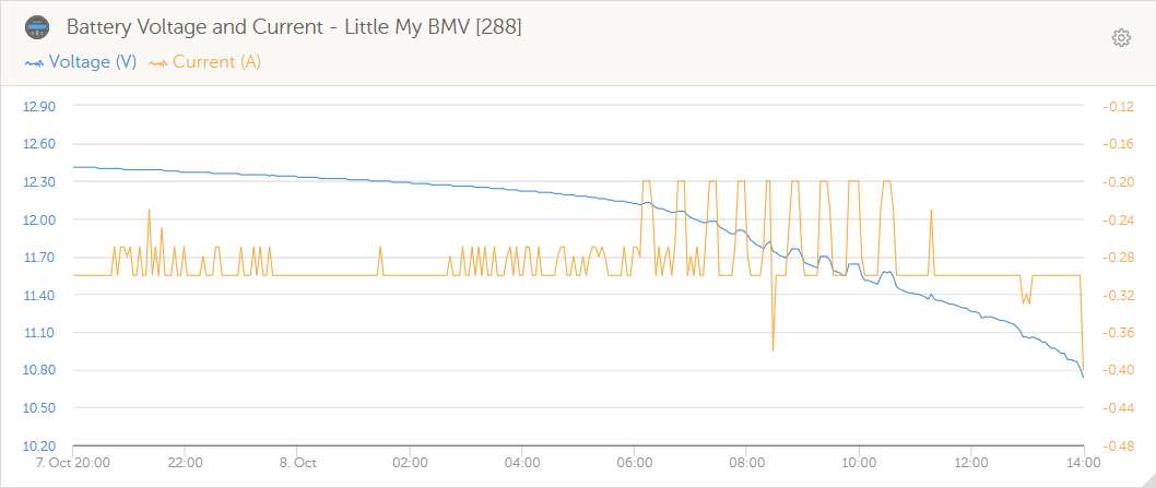

Changed my batteries and I *think* it is better, but not a lot! moved from "knackered" to "slightly less knackered"
This is the original 2 x 100Ah AGM Battery Bank
Voltage dropping from 12.4V to 10.7V in 18 Hours with an average current draw of under 0.3A.
Seemed pointless keeping those in so took out and in their place put in a 75Ah SLA (Sealed Wet Cell) Varta battery and charged it up ...
Same kind of current use (basically this is the Raspberry Pi and MiFi charger)
Voltage dropped from 12.23V to 12.01V, so while still pretty poor, would seem to be noticably better.
You might think there is some other current draw that is not being recorded for this kind of drop, but the battery is connected via the BMV Shunt to the rest of the system, so unless the BMV is dodgy, that is the actual current (and there is nothing running inside so pretty sure it is just that).
