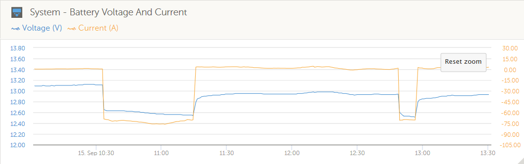

Moved onto checking the power usage of the Water Heater today :geek:

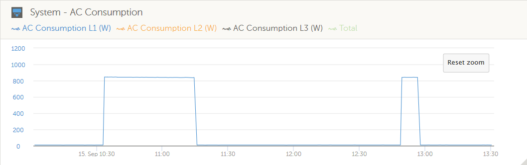

The Cheyenne is fitted with the Truma Ultrastor Water Boiler. This is a 10L capacity system that can work on Gas (where you set the temp you want to heat to) or Electric through a 850W 240V AC Element (and water temp fixed at 70 Celcius).
I charged the batteries overnight and turned off the Fridge this morning so the Boiler would be the only load to monitor ....
Very similar to the pattern of my 10L 2kW Water Heater in the camper van, except of course that 2kW Heater will be faster to get to temp.
So initial heating up, then heater element cuts out once up to temperature, followed by a quick power burst as the stored hot water cools down a few degrees
I'll show the voltage/current graph to allow comparision to the Fridge data - you can see how the Voltage drops with the high current draw.

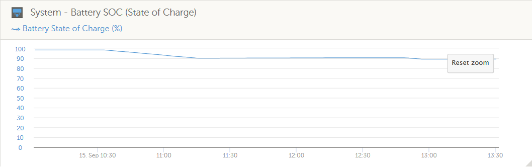

A much shorter duty cycle than the fridge, but over 4 times the power - so what does the SOC look like?
The main water heating took 8% of the batteries energy, and the later boost took 1.3%. Converting to a more typical 200Ah bank, that first 8% equates to be 24% of a bank that size for that initial heating session - so half the available energy of a Lead Acid bank.
Because the energy use is more focussed, using a battery bank is feasible if the timing is right (for example, you know you will be driving later or it is a sunny summers day.

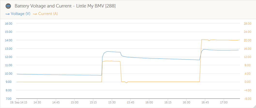

OK ... I like a little graph so here we go ....
Upto 15:20, parked up and voltage rather low!
15:20 to 15:35 was the engine running and the 'split-charge' system kicking (limping?) in with 10Amps of charge.
16:40 onwards is the Victron IP22 20A Mains Charger in recondition mode - voltage is creeping up (currently at 13.0V) and a pretty constant 20Amps whilst in bulk mode.
I thought the Sargents split-charge system (think it is just a relay controlled by the D+ signal) would have been better than just 10A? But the connection does only have a 20A fuse, so would be very unlikely to be better than 15A anyway.

Recharging with the Victron in Recon mode and since the batteries have flagged as being at 100% (charge put back + efficiency factor = charge out since last 100% reset), they have accepted an additional 26Ah and are still charging at 7A in at the moment, so I think I will be able to get a handy amount of charge capacity recovered (y)

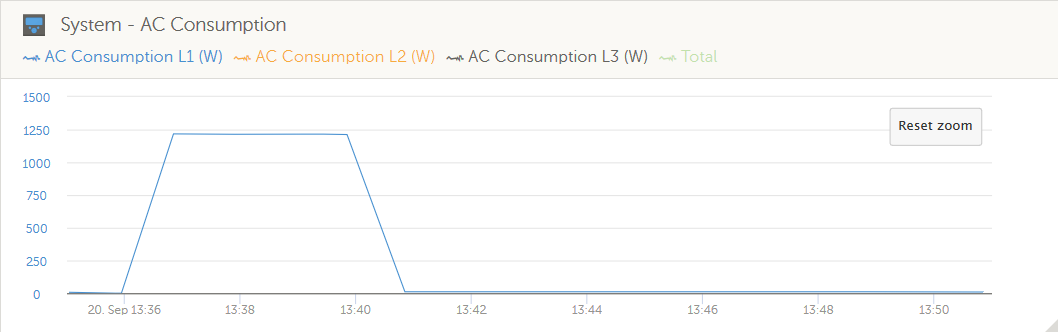

Took out the 800W Microwave out the kitchen to check how it fits in the cupboard for space, and also how much power it uses when running. I know it is more than the stated power of course, but not actually checked before just how much more. I've posted a graph (of course ;) ) below to show how much power for this specific microwave, heating up a large bowl of water for abut 5 minutes ...
Microwave is 800W model. When in use it actually draws 1214W of AC Power (so around 5A at 240V AC)
When off-grid and on the Inverter (which is something I am wanting to be able to do), there is the overhead/conversion losses to be considered of course. So while the 800W Microwave is running, we are actually pulling 1420W out the batteries (equates to around 110A-120A current draw depending on battery bank voltage).
So if getting a Victron Inverter, probably need to be looking at the smallest at the 12/2000 model (which is a 1600W Inverter. the 12/1600 is too close to the edge at 1300W).
