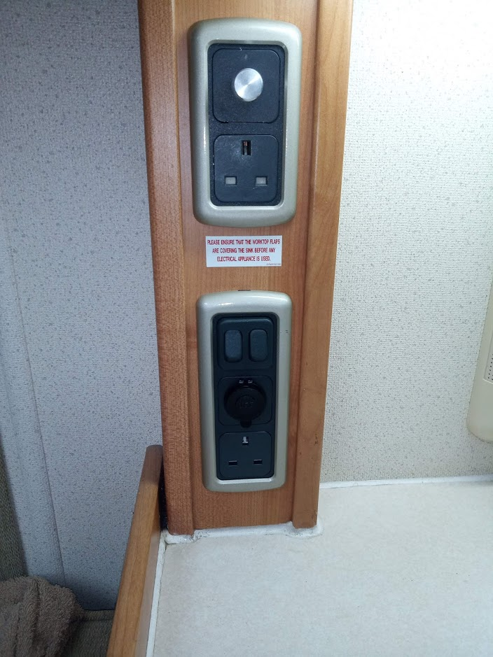

My first real alteration was carried out today in the Motorhome :D
I forgot to take a photo before the dismantling of the standard fitting at the top, so there is the cabling, plus some pen markings added lower down
This pillar is right at the side of the kitchen with a sofa on the other side of the upstand. I needed to add some USB Sockets to plug in Phones and Tablets to charge (this is fairly urgent for usability so needed to get done!).
I also wanted to add another 240V Socket on a different circuit to the one in the top block (I plan to make one of them a little "intelligent" and live depending on battery SOC, and the other one normal).
So a bit of work with my Bosch Multitool (couldn't risk using the hole saw as cables were running behind where I will be cutting), then some wiring and we end up with this ....
So at the top it is still standard, with a 240V socket plus a dimmer control for the 240V lighting.
And the bottom set is the new 240V at the bottom, a Twin USB in the middle, and a pair of switches at the top - the left turning the USB on and off, and the right turning the 240V on and off.
Pleased with this as it does look like it could have been a factory install (I really like the interior so trying to do stuff within that style where possible)

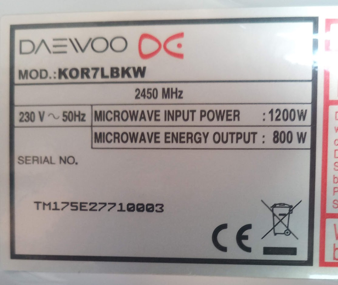

Hmmm, I thought they were supposed to pull more on initial start then drop to or below rated watts. No can they call that an 800W model?
So I looked at the back ....
The input power measured matches very well the label input power (y)
But I don't recollect EVER seeing the real power consumption quoted on any microwave specs quoted by on-line vendors such as Amazon or Argos :(
I bet if you went to a shop and asked the staff "how much power does that 800W microwave use", I bet they would look at you as if you were an idiot and say "800W of course. There's the label" pointing to the front.

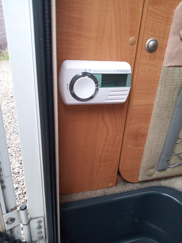

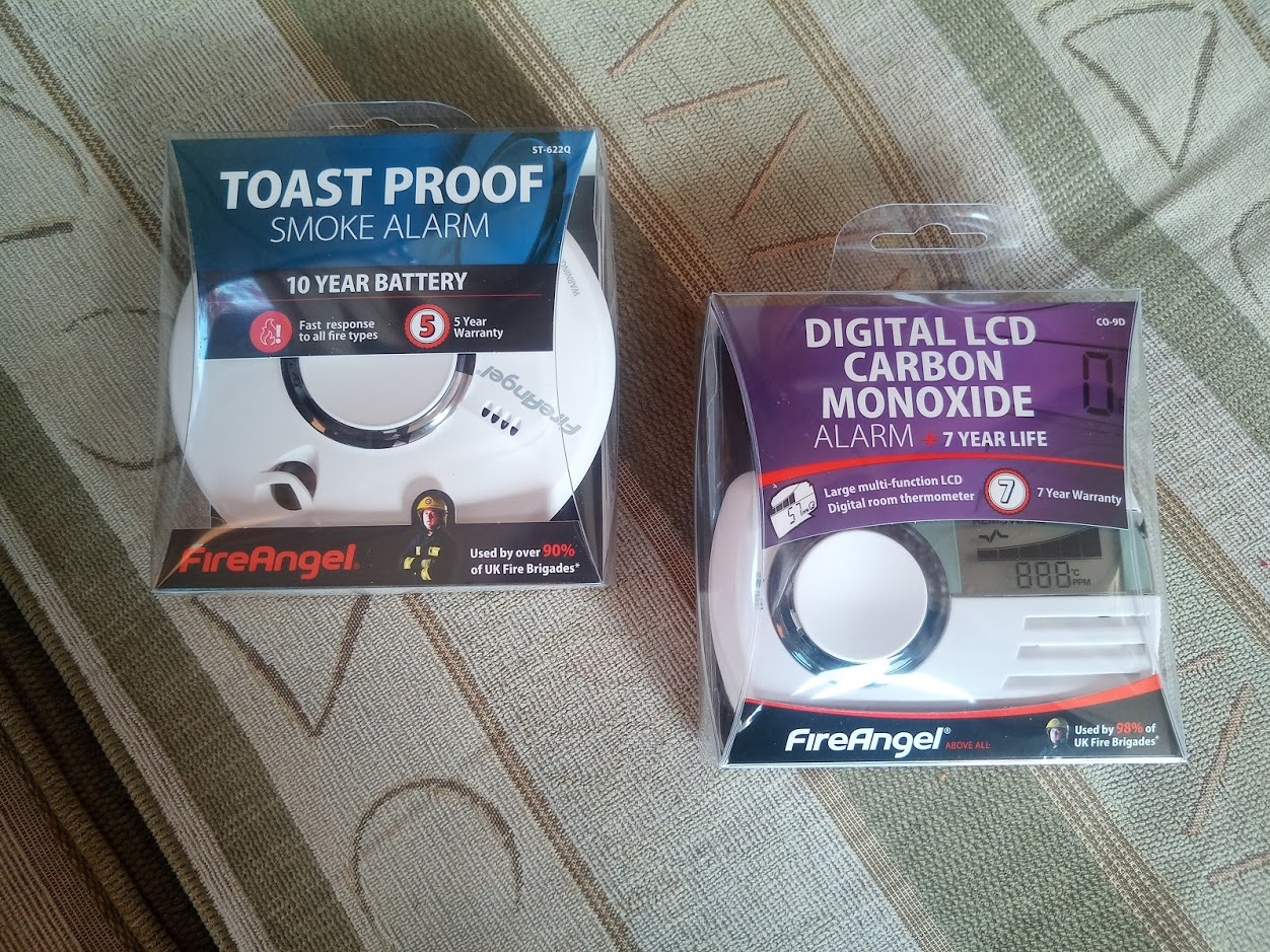

Well, no point in having alarms if they are not fitted :)
So one task for today was to do just that!
First was the CO detector. Understand these are meant to be fitted fairly low down, so chose a place that is also fairly close to the fire and fridge (hope it is not TOO close?)

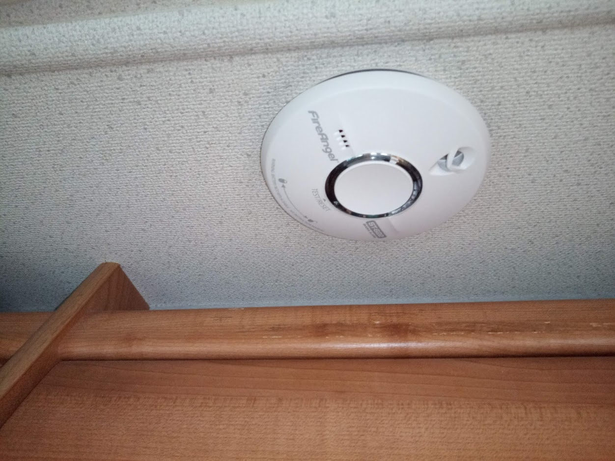

Next was the Smoke Alarm. Just used the same place as the old one. Fairly close to the sleeping area.
Did a test and it is extremely loud! Could be heard in the house which could be handy as well :)

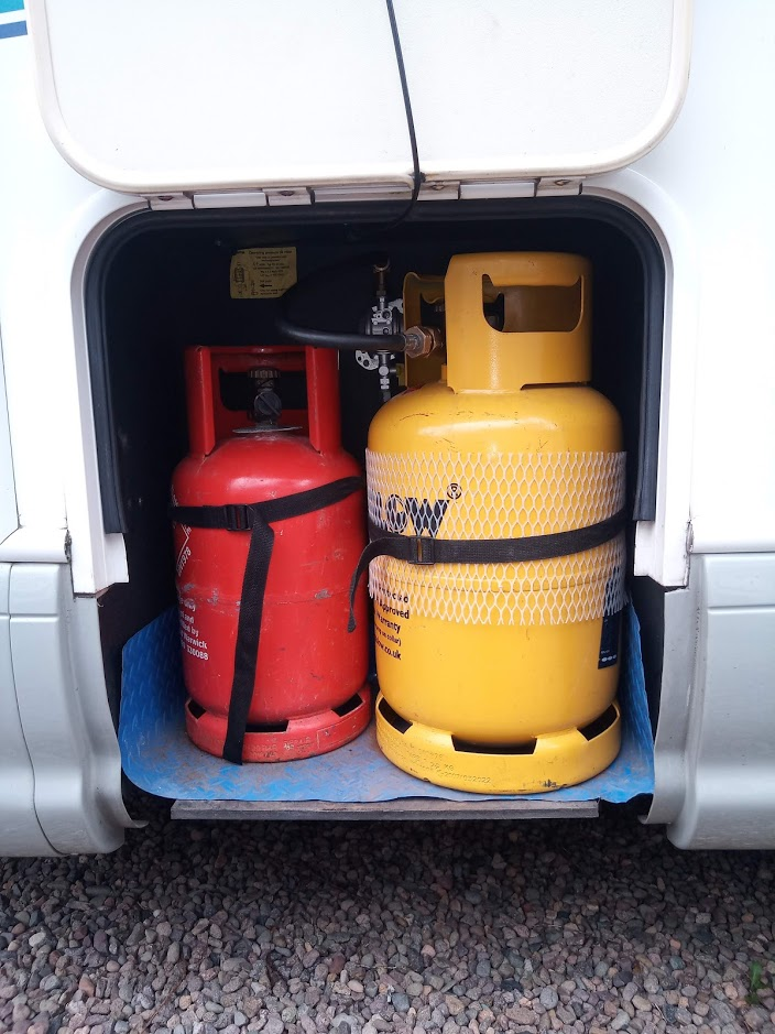

Just getting a bit familiar with the Motorhome and checking out the Fridges automatic energy switchover from Mains to Gas.... nope :( Goes to try gas and the light just flashes and little spanner comes up.
So being a gas virgin, thought I would just check if there is gas still! (although everything seemed to work fine at the Kelso meet). Gas knob off; Undid bottle connection and turned knob back on. Empty! No idea how much started with though.
Plan is to switch to refillable anyway so at least I won't be wasting any part-filled Calor Bottles :D
Thought I may as well do the first step and put the Gaslow bottle in seeing as there is some gas in there (again, no idea how much).
The External Gaslow filler kit is arriving tomorrow and need to decide if I fit it tomorrow or wait until the weekend. Might be an idea to fit seeing as a) I don't know how much gas I have; and b) I am going away on Thursday for an overnighter and not 100% sure the pitch on the campsite has hookup (I would expect so, but good to have a backup plan).
I do have the small Calor bottle there still which has gas when I open the valve, but just like the two bigger ones, no idea how much so a bit of an unknown backup plan on that one.

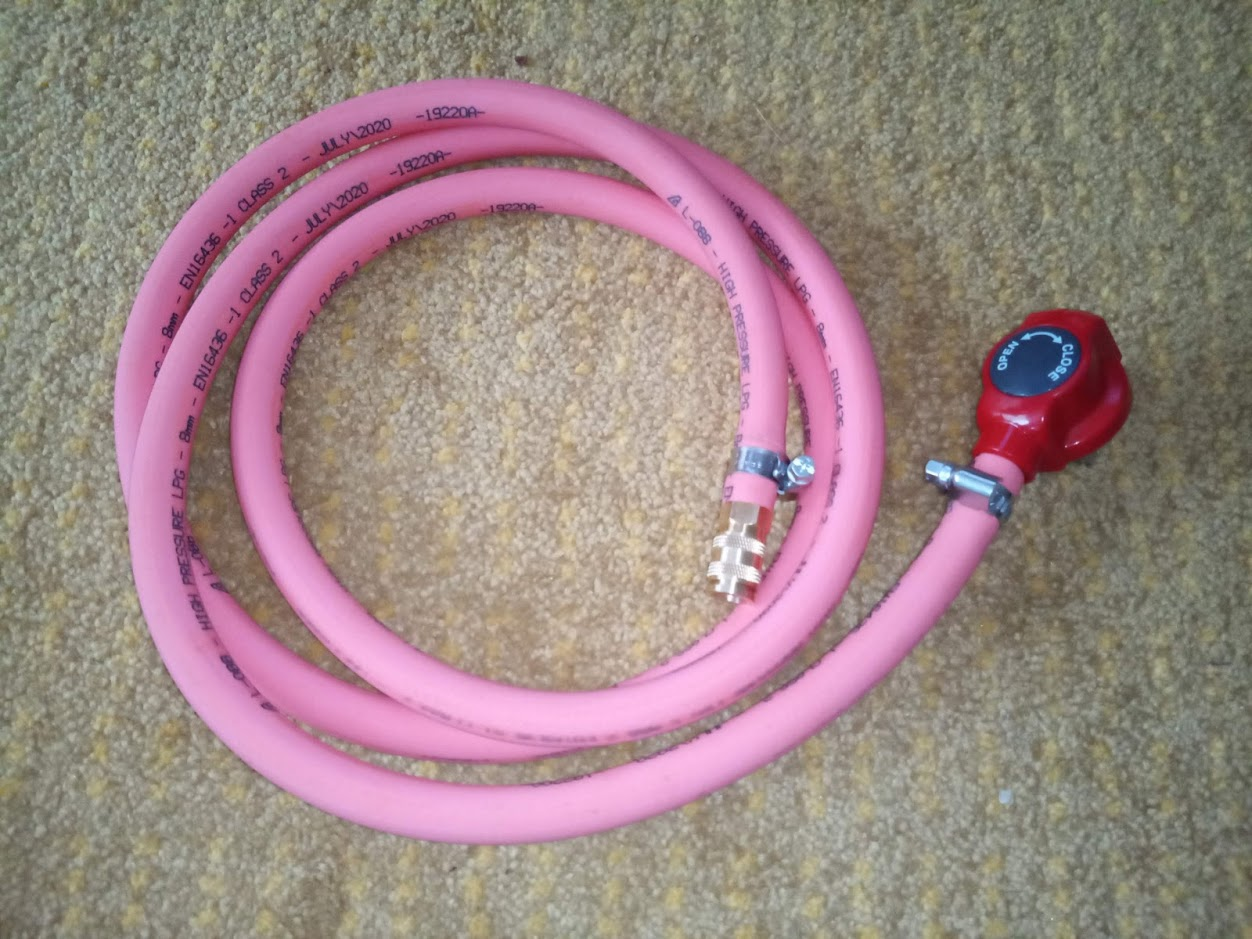

Made up the pipe so I can use the Cadac Safari Chef on the outside BBQ point.
Bullfinch Connector for the Motorhome side and I got the Cadac Quick-Release connector kit for the other end.
For some reason they come with two device and one pipe fittings - so you could set up two different BBQs to use Quick-Connect and so chose which to use from the BBQ Gas Point.
Do many people carry two different Cadac BBQs? To me, it would make a lot more sense to have one Device and TWO Pipe fittings, so you can use the BBQ either BY the van with the plumbed in Gas Point OR AWAY from the Van with its own bottle.
Hopefully will get some use out of this before Winter!

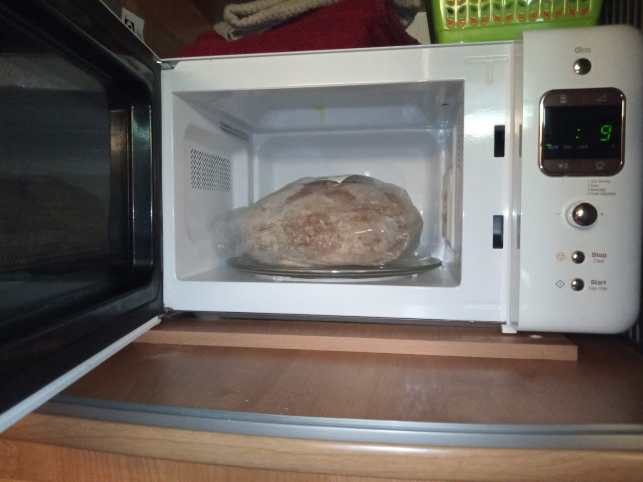

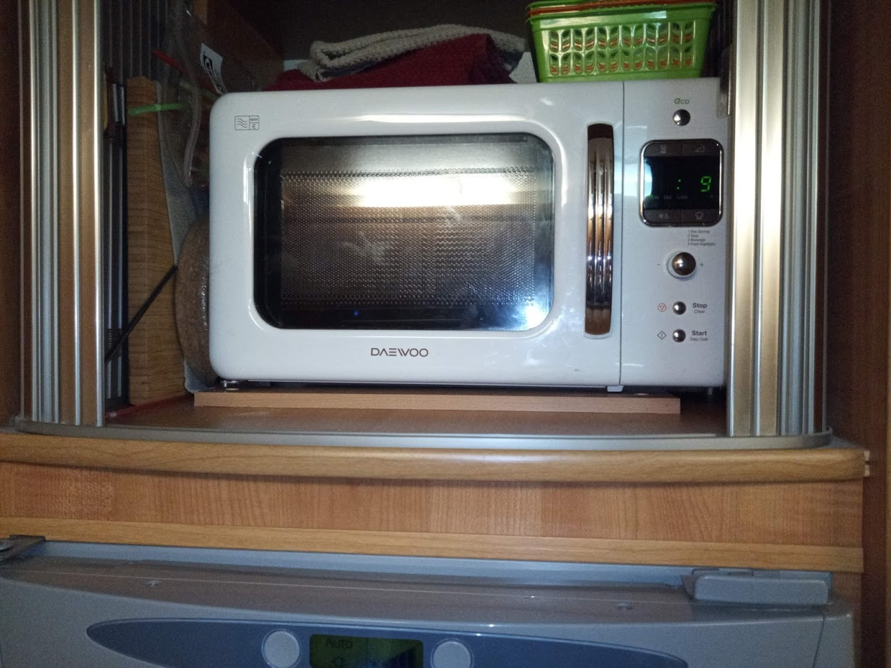

Back to doing some power tests to check on what I need for the Electrics update in terms of Inverters ....
Something I do want to have in the Motorhome is an Electronic Breadbin. "What is that?", I hear you ask" Why do you want an 'electronic breadbin'?"
Well... they seem to be a 'breadbin' for many folk when in their Motorhome, but they usually go by the alternative name of 'Microwave Oven' :)
So I have installed the Microwave in the Motorhome
Or have I? When I come to open it, it has turned into an Electronic Breadbin!
:D :p :geek: :D 🦓

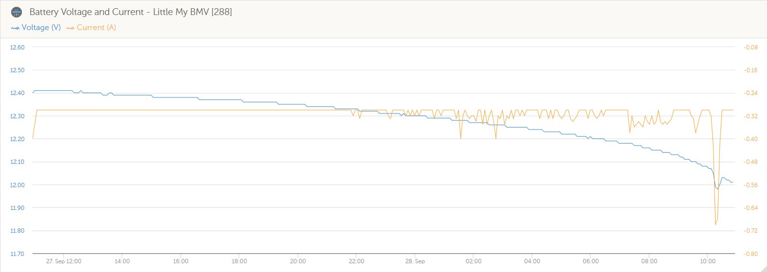

Well, I hope the new Poweroad Lithium Batteries from Alpha Batteries are available soon!
Just looked at my battery data after turning on the GAS Heater and switching the fan on to circulate the air ... that extra 0.5A is a killer!
Batteries down to 12.02V - so under 50% effectively, but should be (if they still had the quoted capacity) at over 90% with the total Ahs drawn since last full charge.
I think I should have kept hold of that 100Ah Lithium Battery I had a couple more months longer instead of selling it a couple of weeks ago :(
