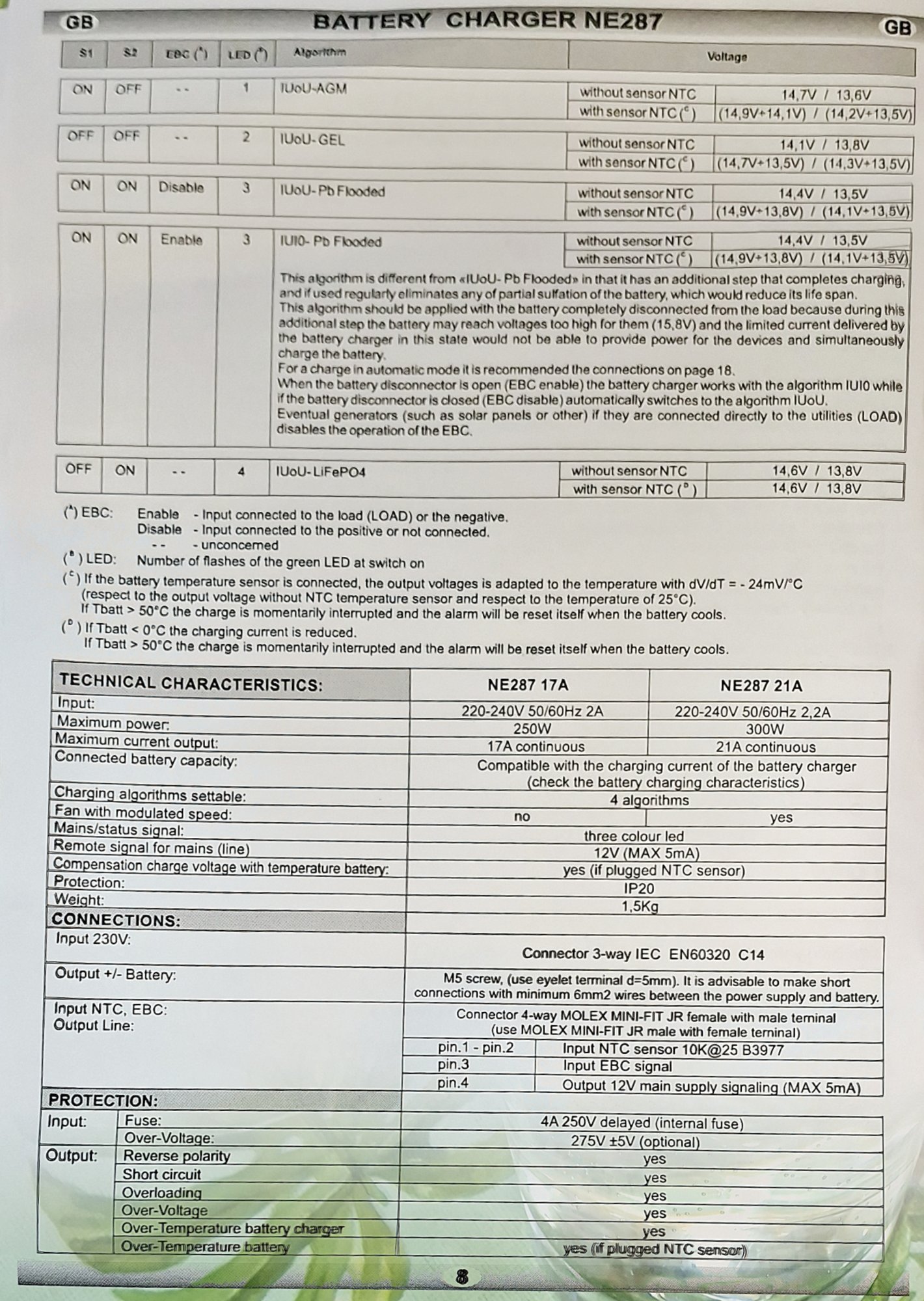

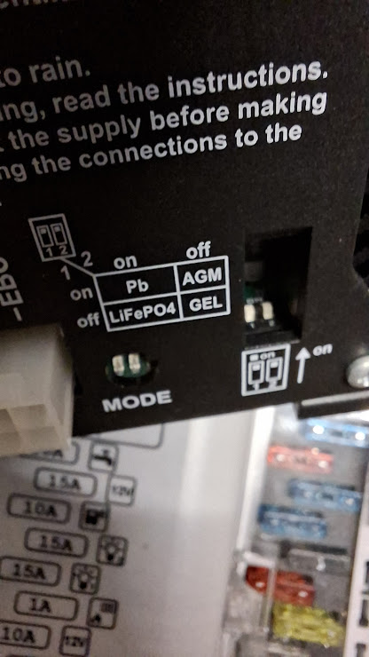

I have the above ac charger fitted in my van and am changing the existing AGM battery to a RENOGY Core Series12.8V 300Ah .
The Nordeletronica has Li charge setting @14.6v available so I'll move the dip switches accordingly (But should be 14.4v, I think) but what is a EBC setting for/needed there is nothing connected to it enable disable it ?? Please

I can't see any voltages specified in the manual linked to. Can't see mention of Lithium either.
As far as preferred charge voltage for Lithium, 14.6V is too high and will usually certainly result in a BMS over-voltage error and battery disconnection. 14.4V might be ok but personally I like 14.2V :)
According to the Renogy manual, it will accept upto 15V voltage before a disconnection which is very high for a Lithium (be high for a Lead for that matter) but if the Renogy info is right you can use the charger you have.
Going by the manual linked to, you can set the unit into a "Power Supply" mode which will cause it to output 13.5V. Dubious use as a battery charger on Lithium but it will allow you to plug into an EHU hookup without knocking out the battery, but I would recommend you need a new charger.
Where have you got the Nord charge voltage figures from Julian? I can't see anything in the info you linked to?
Assuming the BMS tolerates the upper charge voltage which according to their literature it will, what I'd do personally is this.
Fully charge the lithium battery, let it stand for a couple of hours and then measure it's resting fully charged voltage. Let's take 13.5v as an example.
Look at the Nord profile info and see if you can choose a charge profile which has a float voltage setting that's slightly lower than 13.5v, It'll probably be the flooded lead acid setting. Doing this will ensure the lifepo4 battery doesn't sit being float charged. The actual voltages produced by chargers can be inaccurate so best to check the actual float voltage output with your meter.
The EBC on the Nord chargers is an option which applies a desulphation charge. It shouldn't be used with lithium anyway so if you've got the required signal terminal connected to the charger you should remove it and/or make sure it's not toggled on.
Having said all of the above long term tests show that the harm done to Lifepo4 by floating is actually very small. If you leave it floating at a high voltage for months and months on end you'll probably start to reduce its capacity slightly but if you only float it for a few hours every so often the 'harm' is actually insignificant. For instance floating at 16V (yes 16V not a misprint!) for 10,000 hours causes about 12% loss of capacity.

Page 12 of the Renogy Battery manual shows 12.4v charge.

Yep, third one down looks promising. Flooded lead acid WITHOUT the EBC.👍
Check the actual voltages you get Julian but personally the flooded LA without EBC looks better than the lithium settings that Nord have chosen.
