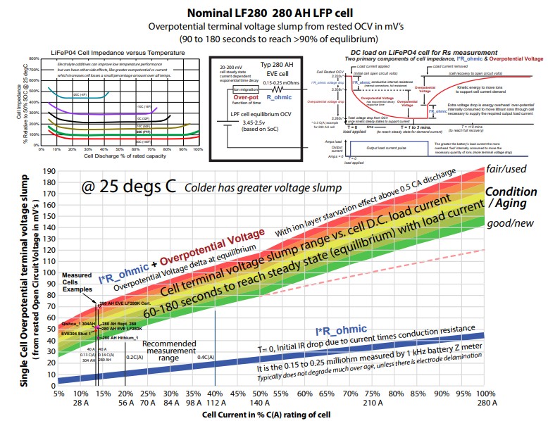

During charging overpotential is the additional voltage that needs to be applied to the battery in order to drive the chemical process of charging and you can't get a charge current unless the overpotential is overcome first. Overpotential thus limits current instantly.
