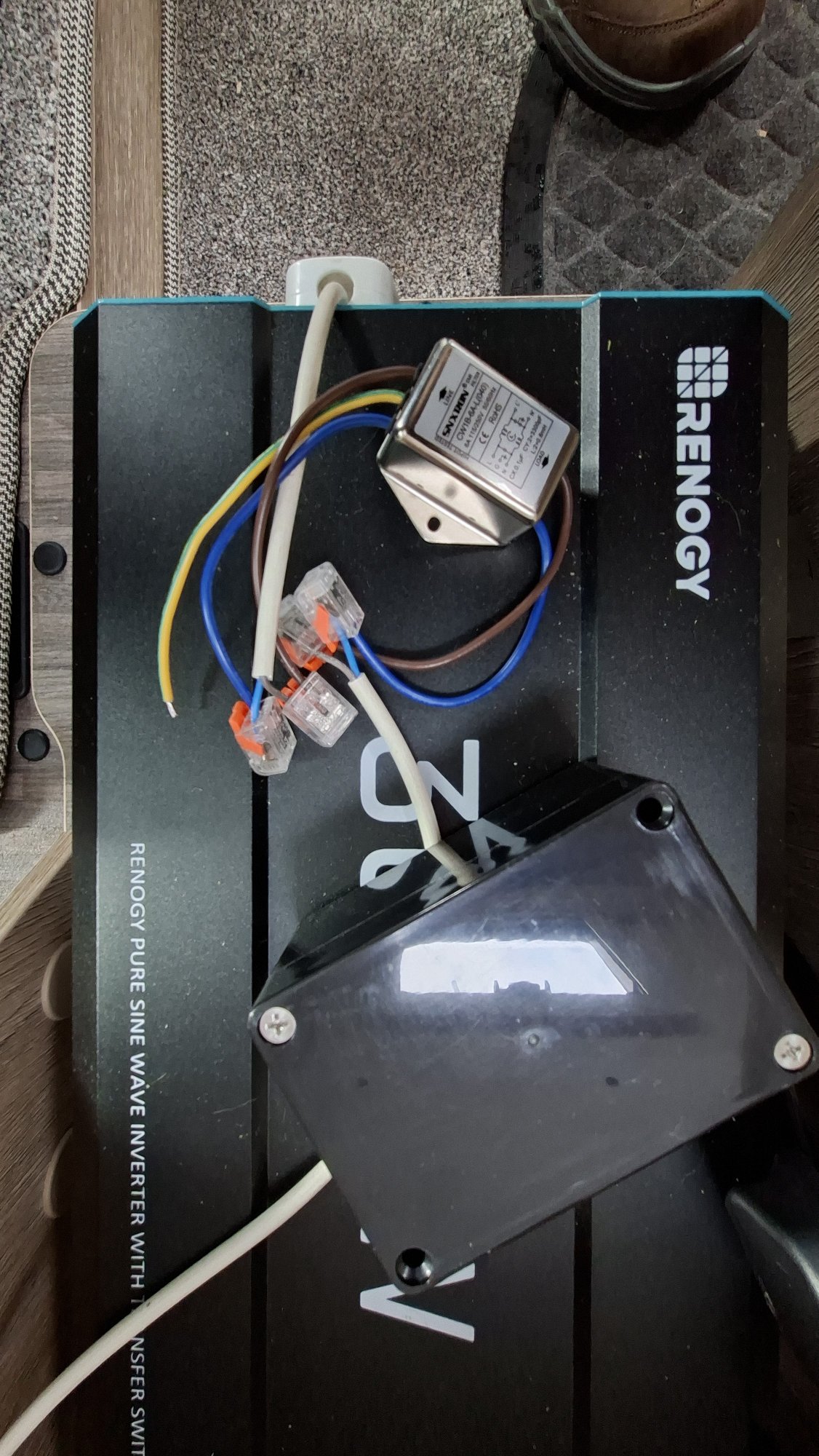

I have a new LG TV 230v which was powered by a very cheap ciggy plug in inverter when off grid, however I have now upgraded the OE equipment with a 300ah Li battery and Renogy 3kw inverter. This works fine and tested to 2.5kw without issues on heating/cooking appliances
So plugged in the TV and can't get it to turn on with the remote, pressing actual button on TV and on it comes BUT the R/C wont work or do anything. Plug TV in grid mains or cheapo inverter and works perfectly ☹️.
I'm assuming its RFI or similar from the inverter, however even if I keep the inverter powered on but power the TV by another source it doesn't have a R/C problem, so the interference must be transmitted into the TV by the inverter supply ??
I have bought and waiting delivery of a Power Filter for Interference Attenuation in Electrical Appliances.

I would try fitting ferrite baluns onto the wires going in and out of the inverter. Their inductance might suppress the RF being broadcast down the cables.
Not guaranteed to work, but cheap and an easy DIY job.
Yes! That's solved it, (everybody likes an update 😁) just pop it in the project box and sorted, though annoying that this was required in the first place.

Very disappointed with C.S. Tec support response time, having to take the DIY approach 😢😉😀. Was a strange one, I contacted the TV supplier as it was 'broken' and was about to return it, then I tested R/C with the phone camara saw it was working and back tracked what changes I'd made. The power supply! I read elsewhere someone else had a similar problem with a Renogy Inverter and LG TV combo which was reassuring in a strange way.

Renogy official (like many) censor bad press, they removed my post about this problem. Also after a week of the LG TV working OK with the RF in line filter, it Stopped working again 😫. So I have swapped the TV with our house bedroom Samsung TV which is fine. I'll have a look at Jonty's group 👍He is KEEN!
