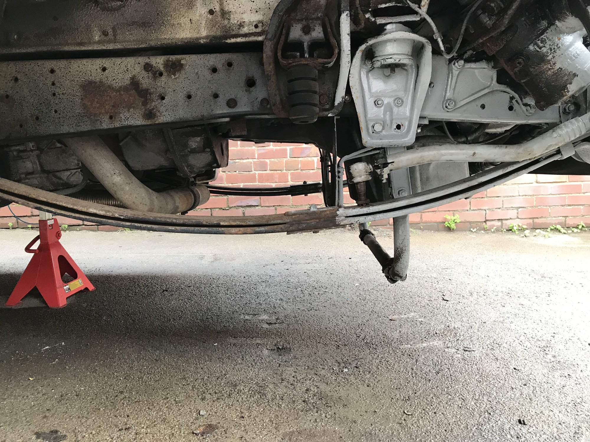

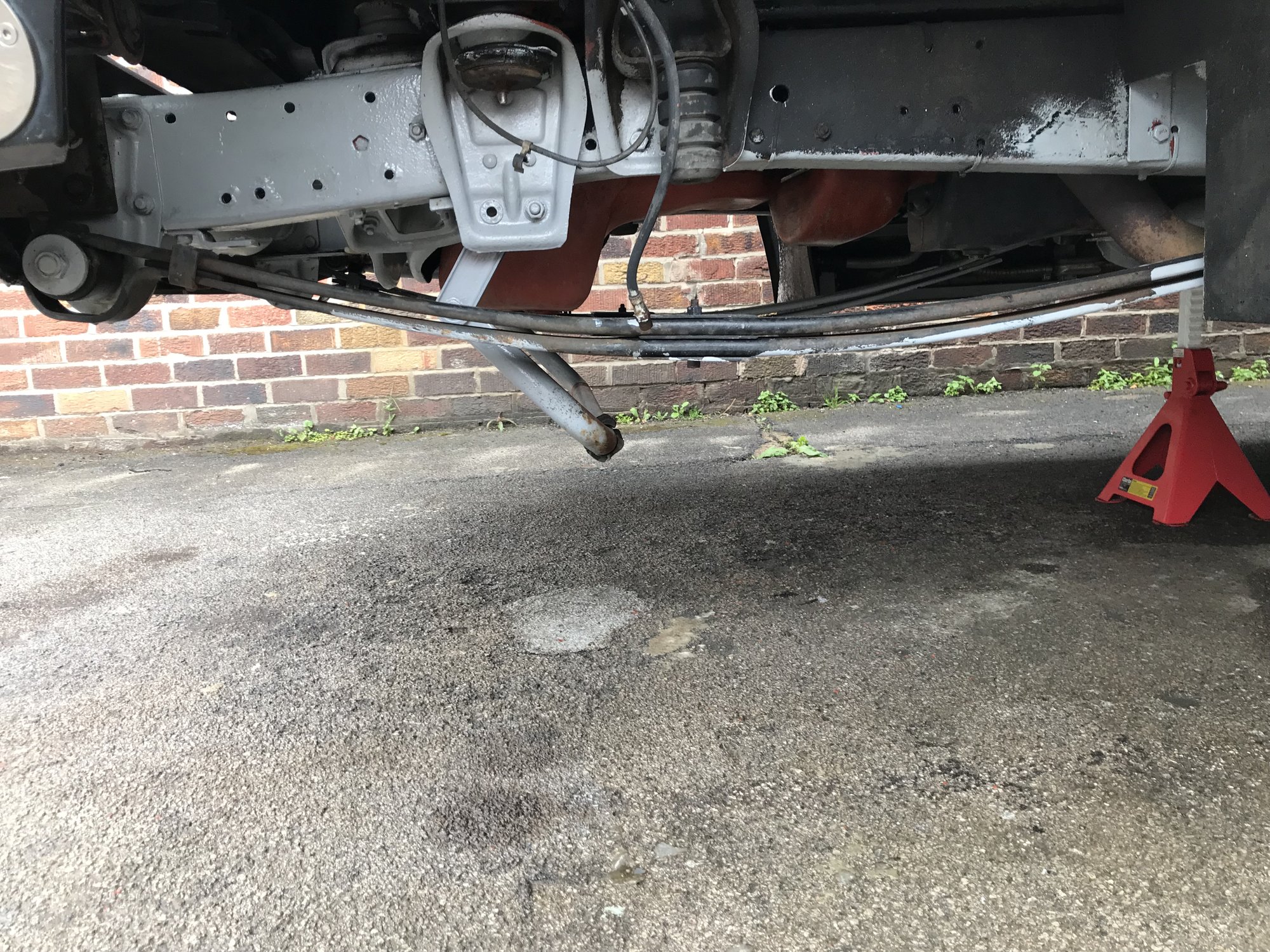

Think there is more rust on my 2008 TransitMurky and Betty both devoid of axles. I pointed out to Anita how much easier it would be to clean, repair and paint now. Yes it doesn't take much imagination to guess the response!
Murky was much easier to strip and the front leaf springs were replaced a few years back. Mercedes genuine again as the pattern ones wouldn't take the weight.
Whilst taking advantage of this situation, it's better to just check everything and replace as necessary.
Stiff sliders and pistons were found on Murky's front brake calipers, so they will be treated to a seal kit.
Strangely many things have been found that could have contributed to the failure. Not one that can be positively pointed at.
The only thing that I hadn't had any experience of was the wheel bearing grease, donated by a local garage as we were out of stock.
The springs will be removed from Betty to replace the bushes, much easier to do now.
