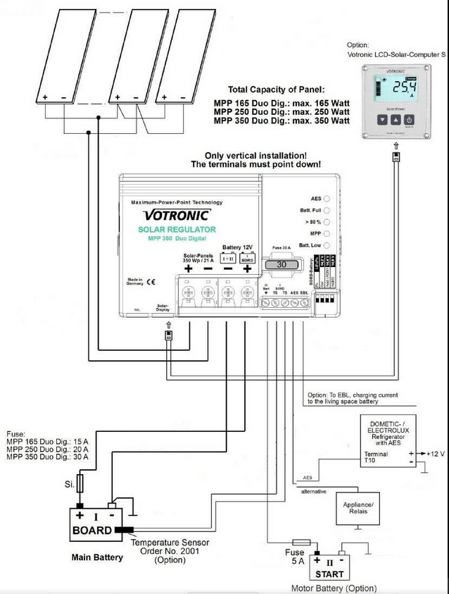

No charging for starter battery if van left standing a while.Good call. That looks nice and straight forward.
Young Trevor, why on earth do I need extra charging ? The 'van is parked on my drive and connected to a maintenance trickle charger, when driving it charges itself, I also have jump leads should the vehicle come over all menopausal and we also have power pack booster, so yes in many ways I'm thick, but don't regard me as stupid please.No charging for starter battery if van left standing a while.
Simple though, bit like me.![]()
Never said you were stupid cause i now you are not, the reason is it saves electric charging, & if away and by accedent you left lights on then the panels will boost s battery up again, on my weagon i have a heavery duty battery cable and 200ah relay and switch, this is handy as if starter battery low you can connect up to less batts and get going, happened to me once in portrush and boy was i a happy bunney when she fired up, hope all works out for you.Young Trevor, why on earth do I need extra charging ? The 'van is parked on my drive and connected to a maintenance trickle charger, when driving it charges itself, I also have jump leads should the vehicle come over all menopausal and we also have power pack booster, so yes in many ways I'm thick, but don't regard me as stupid please.
They're good (I have one) but I think I'd suggest a Victron (have one of them too) one even if you ignore the bluetooth. A Victron 100/20 is only about £55.Votronic mppt which charges hab and strter battery. 175w 250 or 350w, all depends on s panel size, me i have a 250 with 200w of solar.View attachment 143806View attachment 143807
