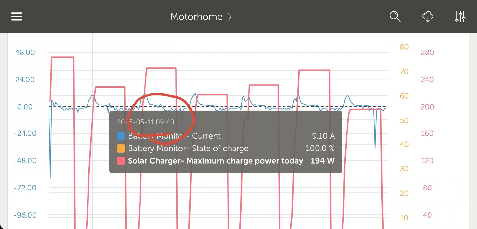

As you can see batteries are back up to 100% by 9am most days
