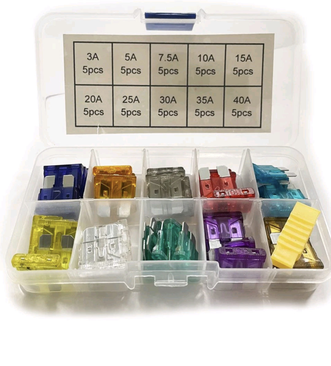

I previously purchased a cheap multi pack from eBay and threw them away after testing a few myself. They were rubbish and the value was simply embossed into the end and hard to read like this cheap eBay set of 50 for £4.99.
When you say "you pay more" how much more exactly? I don't like over paying myself but It's pennies Trev and simply Not worth the risk.
