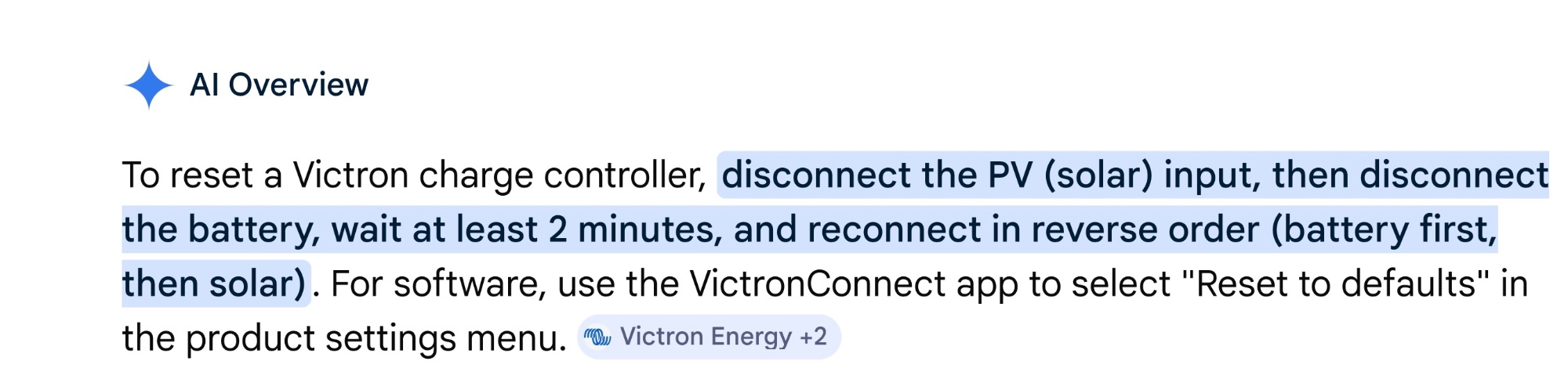

no profession of knowledge but i had a victron permanently on float and we also had the same problem with alan a couple of weeks ago , jeff told me how to reboot it and we also found the same information on victron’s site
Cheers Jeff. I've reset the solar controller like ken posted and it's now on absorption which is hasn't done before so that part might be sorted . I've deleted and reinstalled the ecoworthy app which is now showing 90%soc at 13.4 amps does that sound right?
Sounds good to me, keep your eye on it and I will give it the once over at the Rolls Royce rally

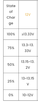

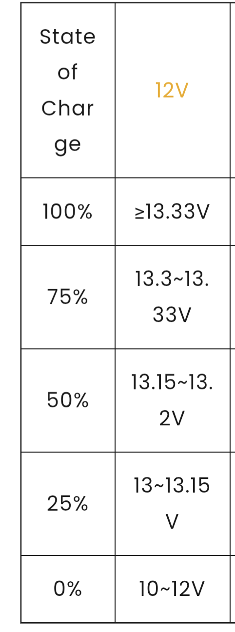

In future you can cross check what the app says you have left in percentage against the voltage by using the chart below. Be aware that the figures are RESTING voltages, IE when the battery isn't being used or charged. If it's been heavily used say by an inverter or charged then let it sit for half an hour or so to settle before using the voltage readings.
