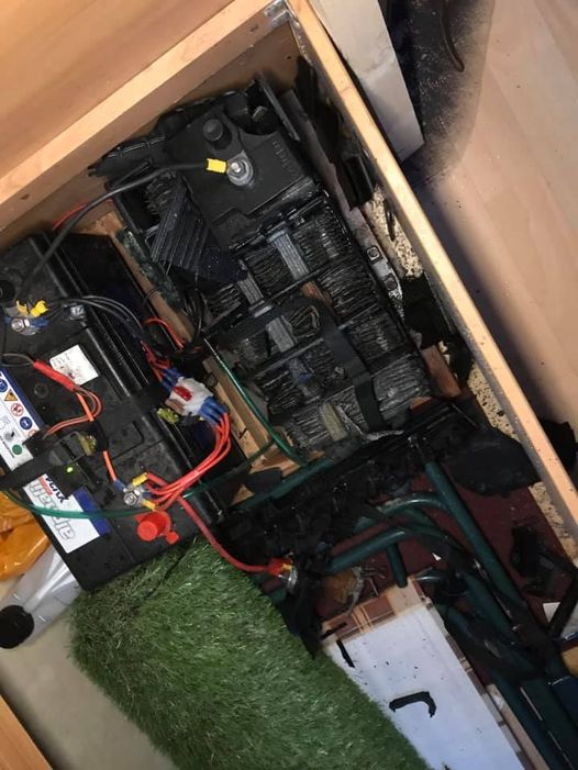

I'm an electrician by trade and i see alot of amateur jobs that haven't come to harm by sheer luck. There's quite alot that can go wrong with a
battery, even though 12v is not enough to drive current through skin, a
battery is quite capable of releasing in excess of 500 amps if shorted, enough to send a spanner or the base of a van seat red hot in a very short space of time, let alone a thin piece of cable. All cables should be protected against overload and short circuit by at least one method, ideally 2. (IE insulation AND fuses /max demand calc etc) I'd size a cable according to ohms law and power equations, looking at how much it may reasonably draw in either fault or operational conditions to avoid overheating/melting. A 12v 2400w
