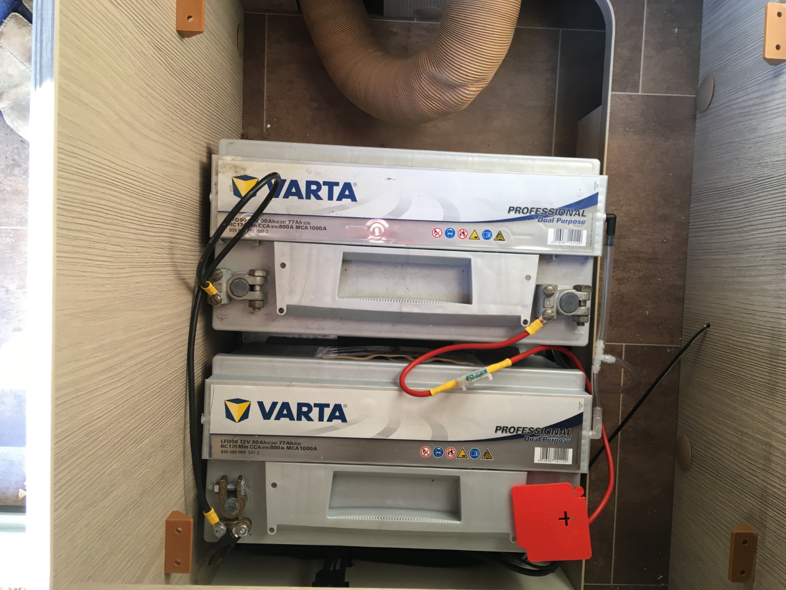

My brother ordered an optional 2nd battery with his brand new Burstner, and this is how the dealer fitted it. To me, the wire seems far too thin, and the take off is from the original battery only.
. A poor job in my opinion, and an example to the OP of how not to do it!
My brother ordered an optional 2nd battery with his brand new Burstner, and this is how the dealer fitted it. To me, the wire seems far too thin, and the take off is from the original battery only. View attachment 91118. A poor job in my opinion, and an example to the OP of how not to do it!
I have seen a few of these why are the positive terminal uncovered on the second battery, far more risk. :mad:
The patch leads are protected via a 15 amp fuse. Don’t forget the main vehicle battery leads are 16mm to cope with starting loads of 120 amp or so. The leads from the first battery would probably be 10 mm to allow for volt drop over the length. To run a 15 amp load would be quite high as the batteries would be sharing this load. The cables look like about 6 mm which could take a higher amperage than the fuse. Therefore it seems safe and workable. Things are not always as they seem. I hope this helps in your worries. 😀 You can buy loops from eBay that are complete with fusecarrier quite cheaply.

It may be worth investing in battery terminal covers to be safer. These are probably covered by a timber seat cover or such. So are normally not accessible without tools.
