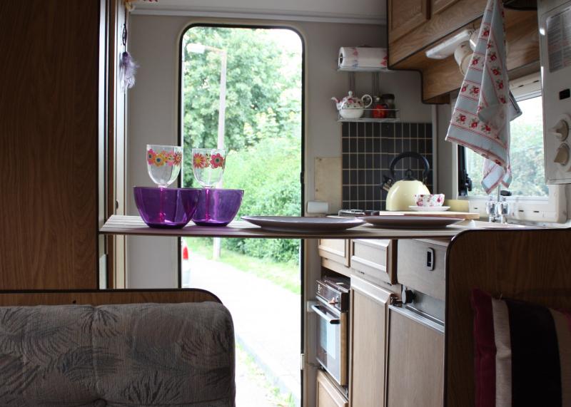

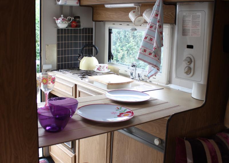

Ok I have made a complete cock up :scared:...I have bought the wrong wood a puff of wind and this will blow down BUT ......with a stronger piece of wood this is going to work. It can slide behind the cushion when not in use or can sit in the cupboard it leans on. It doubles up as a gate so the dog can stay in kitchen bit on those wet days until he dries. Loads of work top space only downfall is I cant open kitchen drawer for cutlery so would make sure have everthing out I need beforehand. IMG_5044.jpg IMG_5045.jpg. Going to get himbenny to screw in a peice of batten on the door for it to securely sit on and of course stronger wood but hey presto ...this is fab ............thanks everyone for your invaluable ideas.
Glue & pin a couple of 1"x2" battens underneath the board to strengthen it without greatly increasing the weight. A thicker piece of wood may increase the weight quite a bit. Another option is to get another identical board & glue them together to stiffen it.
:lol-053: Its not right It could do with being a bit narrower ...but will let you know the finished result. From what I tried today it could work really well for us. Hey I even put a shelf up as well to put coffee and tea stuff up out the way...Oooo get me :hammer:
