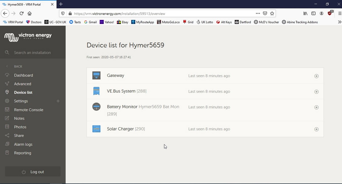

Doing a different test with my new battery which means the connections are different, but still getting dropouts ....
The BMV is connected with a DIY Cable to the unpowered hub, and then that hub is now connected to a genuine Victron Venus GX USB port. Been like this since noon today and had two disconnects already.
Rebooting the Venus GX got it recognised again (rebooting the Pi had the same result as well)
So this maybe eliminates the Pi as a causal effect?
What I have added into the mix however is a 5 Metre long USB Extension lead to let me plug in the BMV, and I am dubious about a USB Cable that long TBH?
I really am thinking whatever is in the dongle in the Victron Lead is there for a reason! going to try to find a shorter USB Lead to use instead. I have previously used a Logitech Mouse dongle extension when I used the Pi on a live system (but with the Victron VE.Direct-USB Lead) and they are around 1.5 or 2M long, which would be plenty for me. Might also see if I can find the genuine Dongle VE.D-USB lead as well to use with the long extension.
