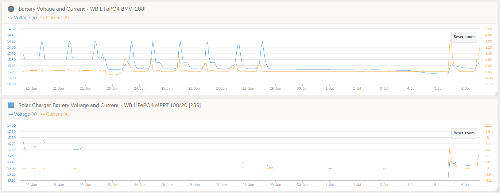

I can see the times the connection was lost by the sudden lost data in VRM, but there is no pattern or apparent logic to the occurances.
The top is BMV - data all the time from 20 June. The bottom is the MPPT - no lines means no comms. Only returns when I reboot.
Happens at any time (for example, just looked as typing this and it lost comms 13 minutes ago and will not be back until I remote reboot the Pi)

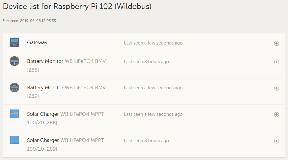

This is what I currently have ....
I have decided to not delete the old IDs so I can keep a track better.
So 8 hours ago was when I switched the VE.Direct plugs over. Since then the MPPT has stayed connected but the BMV has lost connection twice - so by a process of elimination, it looks like I have a bad cable there
