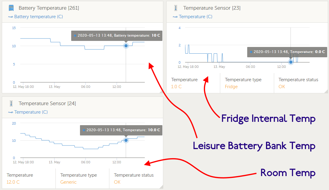

I'm just hoping for someone to write the code in to the Pi so that you can hook temperature sensors up to it and have it graphed in VRM...
I cannot deny ... this is one of the reasons I decided to change to a Venus GX ...
And you can set an alarm if a temp goes above or below a chosen temp (so warning you if say the room temp dropped to a level you could have water freezing for example)
