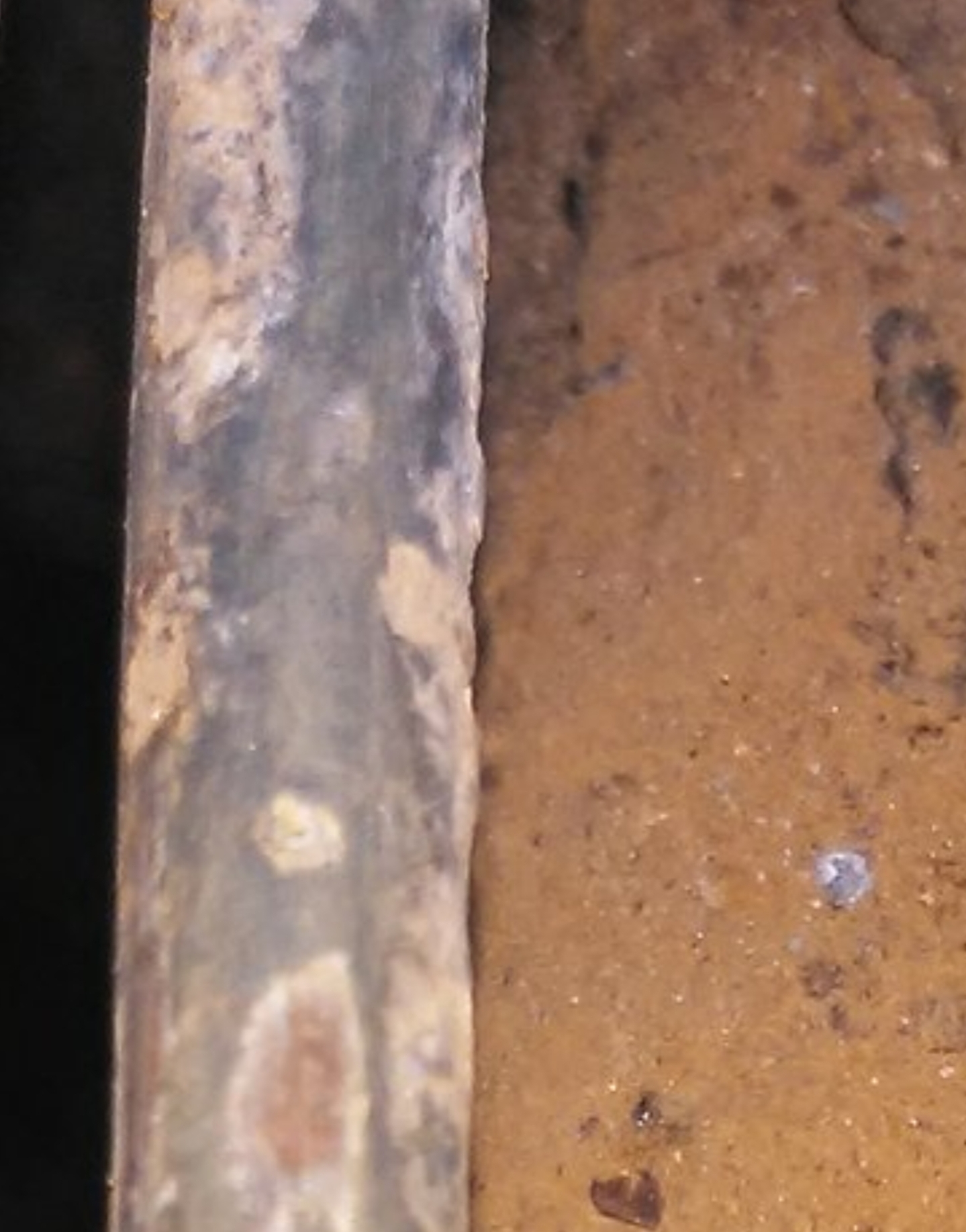

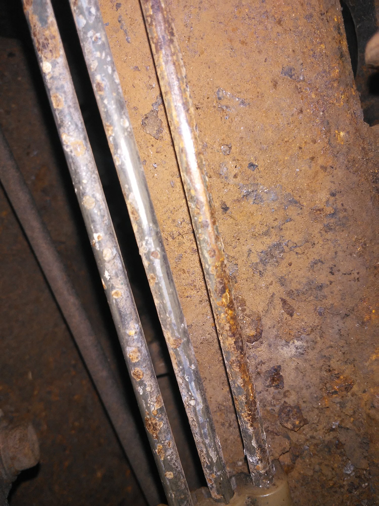

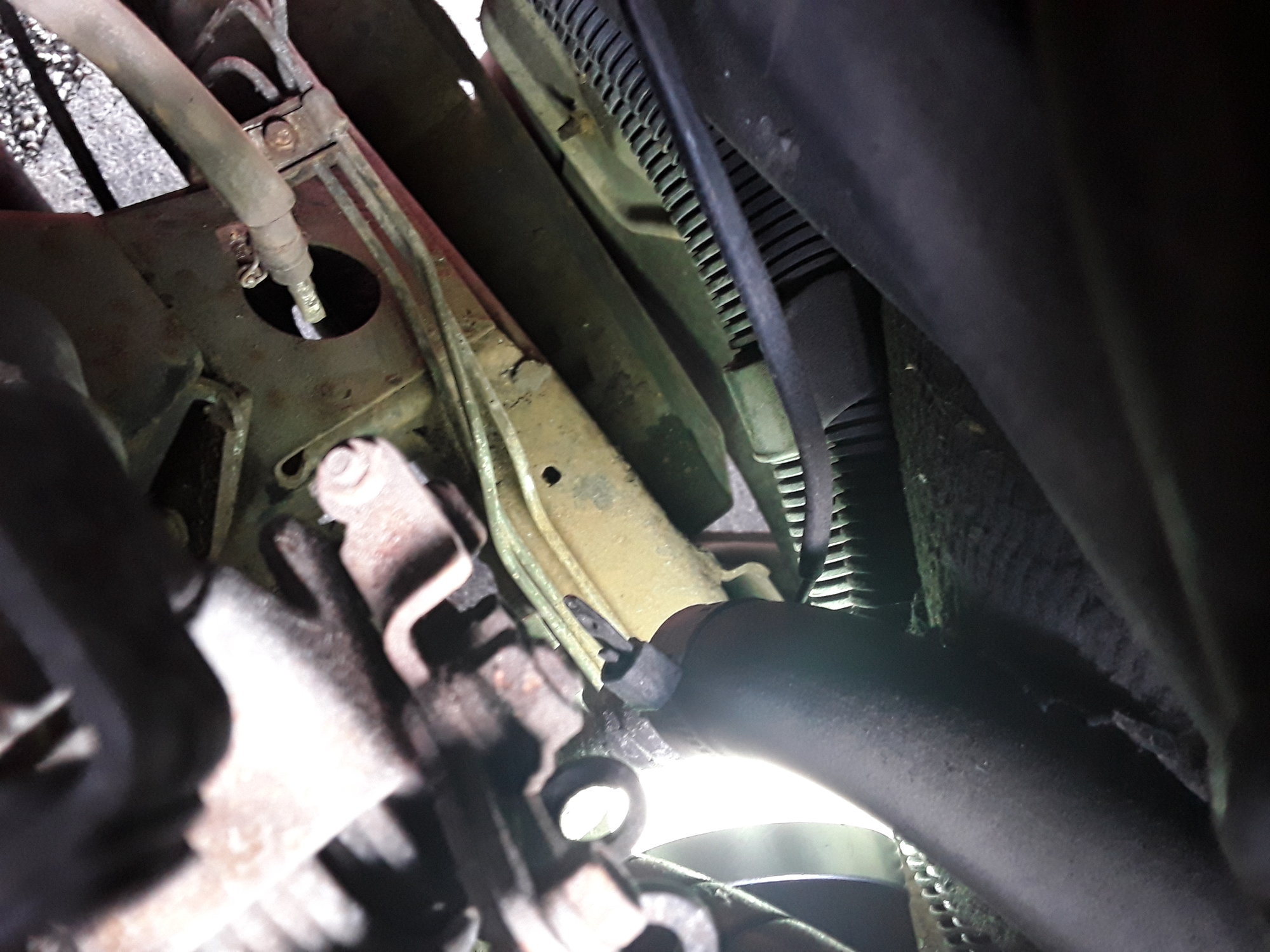

I'm new to engine work;
Photos show brake pipes that were showing corrosion so I tidied them with 800 emery paper. I've bought some engine paint spray but I'm hoping for advice on how to treat the underside of the pipes please as I cant spray. Is a little paintbrush my only option?

If break pipes are corroded, replacement is best option.
Painting means they will look good in the accident photos.
And means they won't be checked at mot time....due to being coated (it'll be an advisory note to the effect of being unable to check)
Frankly IF original factory steel brake lines show signs of corrosion...
Just replace/have them replaced with copper/kunifer and have peace of mind....
After all its only your own and others safety at risk.
I'm pretty sure they are galvanised so rubbing them down is going to remove the protective zinc coat. I'm with Trevskoda here re waxoyl. I check mine every year and recoat with waxoyl as needed. If you don't fancy keeping a regular eye on them then replacement is for the best.

They definitely needed a rub so they could be properly inspected, I don't know what the lifespan of a zinc cost is but these pipes are in there 23rd year. I have made the decision to leave them untreated and therefore completely visible until someone at a garage inspects them

For what it's worth....
IF there is anything like pitting on them (highly likely after 23 years of exposure to road salt/etc)
Then even IF the only raise an advisory at mot time...
Replace them....
It's not an horribly expensive job....
And without being overly dramatic....
The time when you need the brakes the most, really isn't the time to discover that any pitting was deeper than anyone could see.
As you lose brake pressure on one circuit because a brake line has let go when you pretty much had both feet on the pedal trying to stop.
Brakes really really aren't something to leave to chance (an I have seen steel brake pipes let go that were passed with just an advisory on)
Your choice BUT I deff wouldn't leave things to chance and have it on my conscience.

Better photos

This picture would concern me...
As their is obvious wasting on side of it (let alone the possibility of what's going on behind it)

I would definitely replace them. As others have said it not the bits you can see but the bits you can’t. The pitting is deeper than you think and it only takes a pin hole for you to lose your brakes. 23years is a long time in brake pipe life. I had to replace most of the pipes on my pickup 2years ago and it’s a 2011. It’s not something you should be doing yourself and not overly expensive for a garage to do.
