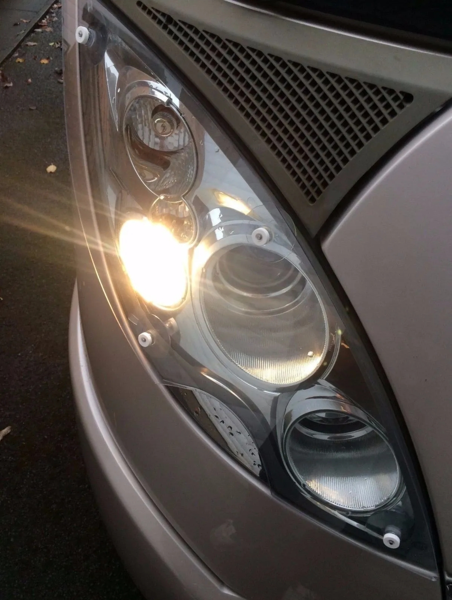

No.Would it be possible to get stone damage repaired on a headlight just like a windscreen You can buy repair kits on ebay so diy possible
On some headlights yes ....if its just a chip and you want to stop it turning into a goldfish bowl ....Would it be possible to get stone damage repaired on a headlight just like a windscreen You can buy repair kits on ebay so diy possible
IF it was me facing this issue ...
I'd buy 2 sets of headlamp protectors ....
Then remove the mounts from one ...
Seperate the broken glass from the damaged headlight unit and clean the sealant ...
Trial fit the protector and adjust if necessary THEN
Bond on with sikaflex etc and
THEN fit the second protector on top
A to prevent future damage
B to hide the redundant mounting holes in the one you've used as a lens .
Might be a mad idea BUT it might just work .
