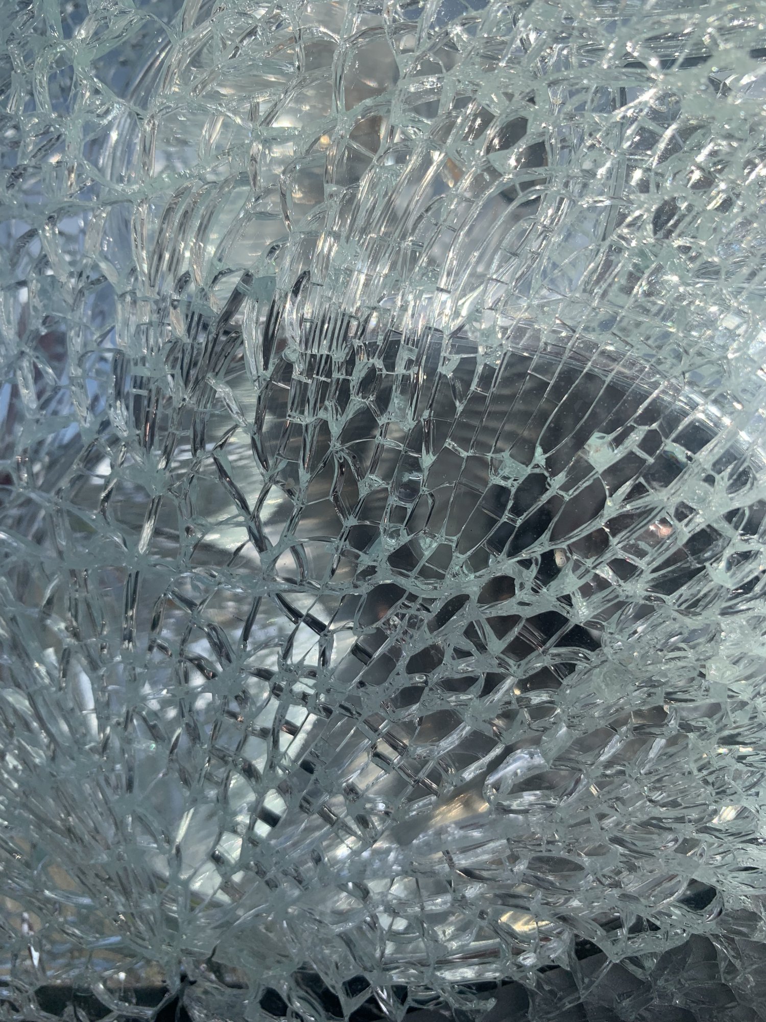

the headlight on my hymer had a little impact mark where obviously a stone had come up & hit it they are fancy cats eyes style so i thought that’s gonna hurt £3/500 or so got the quote back from travelworld l!!! **** it’s only a piece of tempered glass stuck on with double sided tape but oh no got to buy the whole unit, the modern ones apparently are polycarbonate ,
! luckily my insurers saga have accepted it as a claim ,

The price of headlights and potential cost of windscreen replacement nearly put me off a Hymer A class, but we bit the bullet anyway. Had a windscreen replaced which was about €2200 back in 2017.
I am sure you are aware of the debate regarding the shattering of headlamp glass. Hella and Hymer claim stone chips damage the lens and refuse claims of bad design. Owners blame A few potential causes. 1. Hot daylight running lights ( I changed mine to LEDs) 2. Distortion of the unit which has 2 standard bolts, but the third is a three part bolt which can stress the unit if not set correctly. I also changed the headlight bulbs to led.
I have had polycarbonate shields made by a local sign maker, who working off my template, produced a set of 2 covers for £18. These are held in place by suckers and cable ties for extra security.
There is lots of info on this issue on the hymer owners group Facebook page (sadly they don’t have a proper forum). You need to request a join, but there is some good info on the group along with loads of dross and wrong advice, but on balance it is helpful.

gwaygway on here used to make replacement covers & he told me about the stressing issue and i eased off the offending adjustment but in this case there as a definite impact point when i first noticed it later the whole glass crazed , i am a member on the facebook group hog‘s and have read about the protective shields & thought i’m all right now i’ve done the destressing ! expensive lesson, as you say much discussion about design faults etc significant that later designs are polycarbonate and it’s also the fact that you have to renew the whole unit when the glass part is just secured with double sided tape if it was possible to get that it would take about 30 mins to replace
Take the lamp out and remove the lens, then get a sheet of poly glass, cut it to shape then bend and bond on, not rocket science.

I took the precautions that I listed in my previous post. The bulb holders for the DRLs were discoloured brown with heat, so this seemed like a potential cause. Adjusted the bolts holding the unit, and had the polycarbonate protectors made as a defence against stone chip to try and cover all eventualities. Even the new windscreen has a few tiny chips in it. Quite a few of the reported crazing of headlamp units seemed to occur when the vehicle was parked. My first windscreen was a victim of this scenario. There were lots of cases of the windscreen cracking due to stress.
Anyway, onwards and upwards. I will be interested to hear if your insurance company raise your premium over the next few years.
Trev,
there is (or was) a guy on the Hymer Facebook group who offered to replace the crazed lens which is just plain polycarbonate without any refractive moulds. So repairs seem to be feasible.
