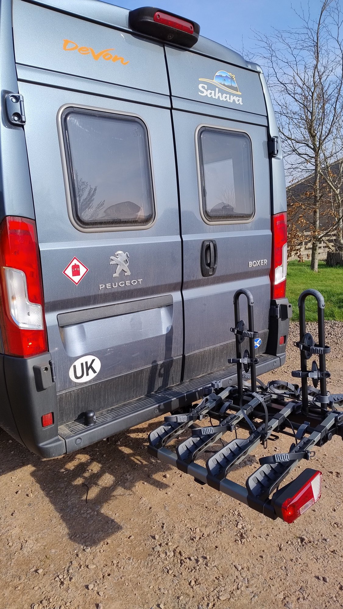

Had the removable towbar fitted at home today by Stewart of MVA Towbars. http://www.mvatowbars.co.uk/
I'd thoroughly recommended him for this kind of work in central and southern Scotland.
Perfect for the 4 bike carrier from buzzracks
