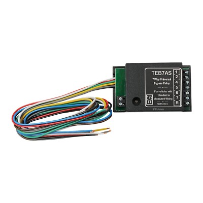

I think it was a TEB7AS Relay I used for the last towbar I fitted (to my VW LT aka Sprinter). A good unit I thought and better than the really basic relays.
One benefit on the TEB7AS as I recall is that it is not a regular towing relay that just connects an IN to an OUT (so for example a left indicator on a lighting board is powered by the same circuit as the left indicator on the vehicle) but instead you power the TEB7AS with a connection to the battery and while the various outputs are activated by the various inputs, they are actually powered by the Battery directly - this stops complications with a vehicles Canbus system seemingly detecting incorrect loads as the activation load is minimal.
