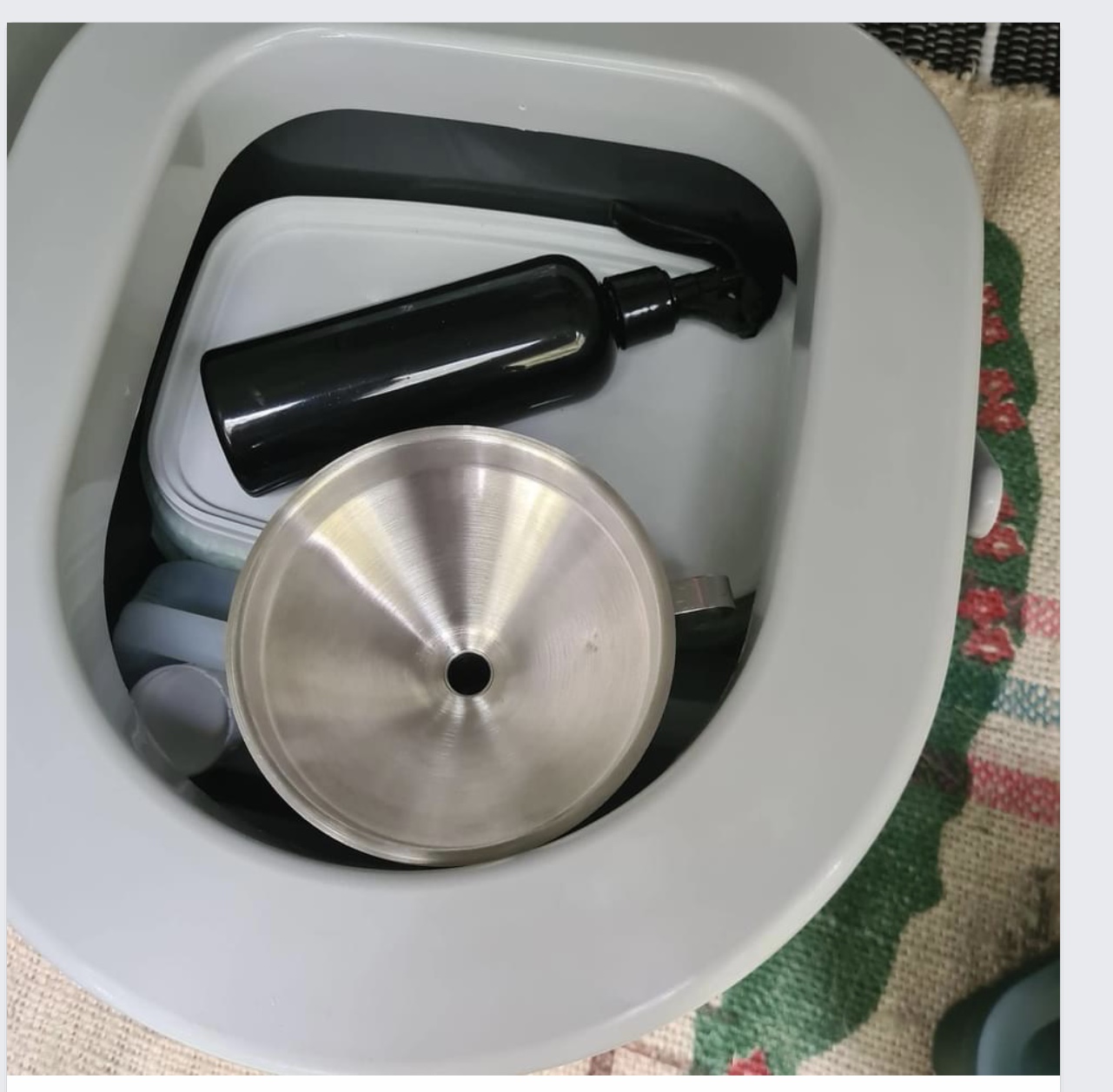

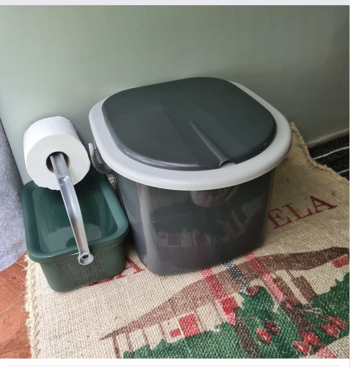

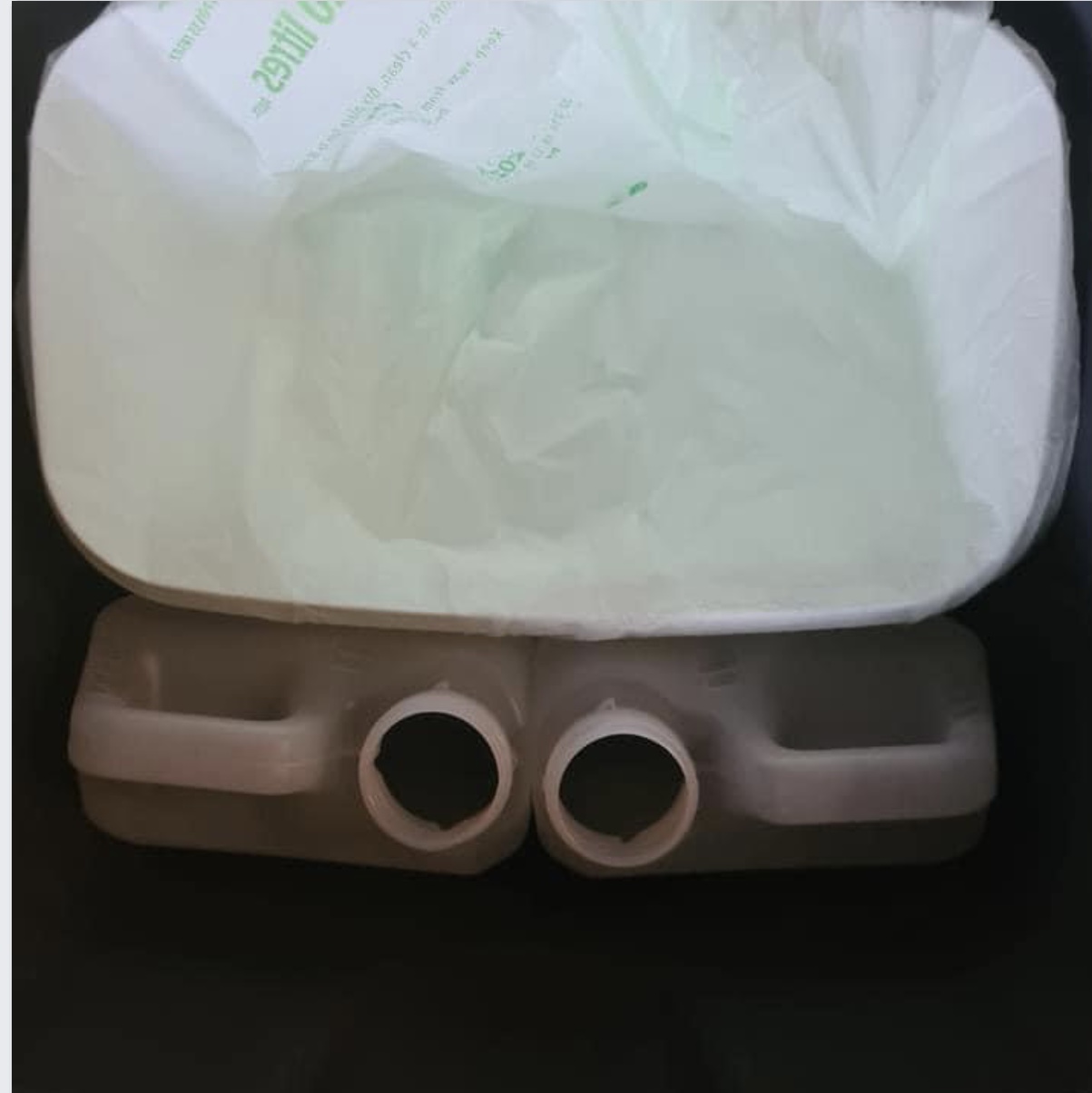

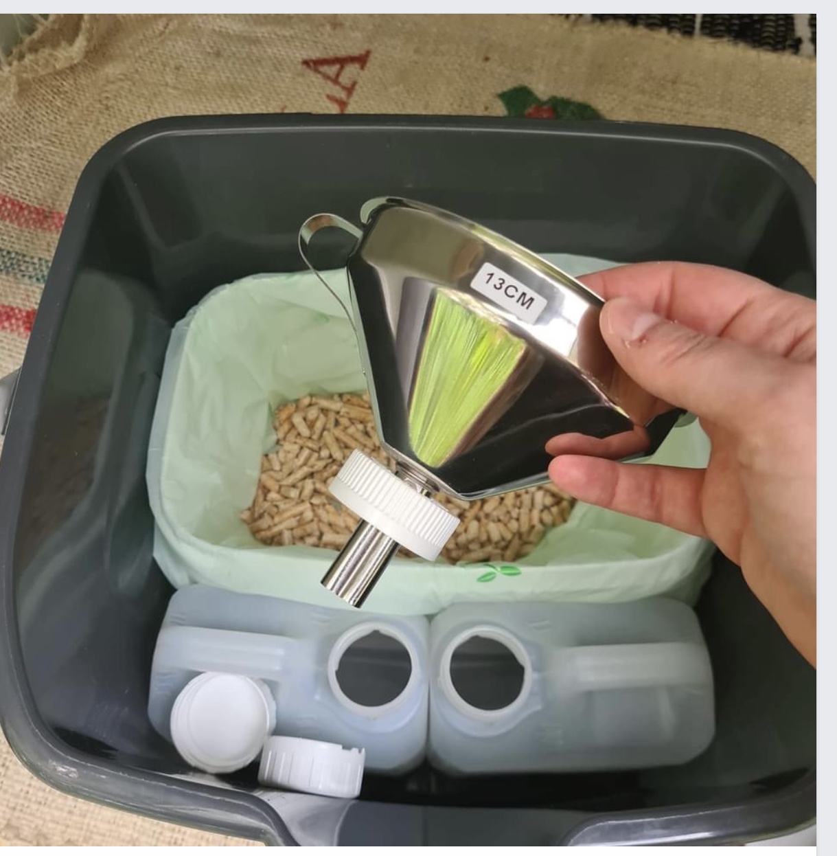

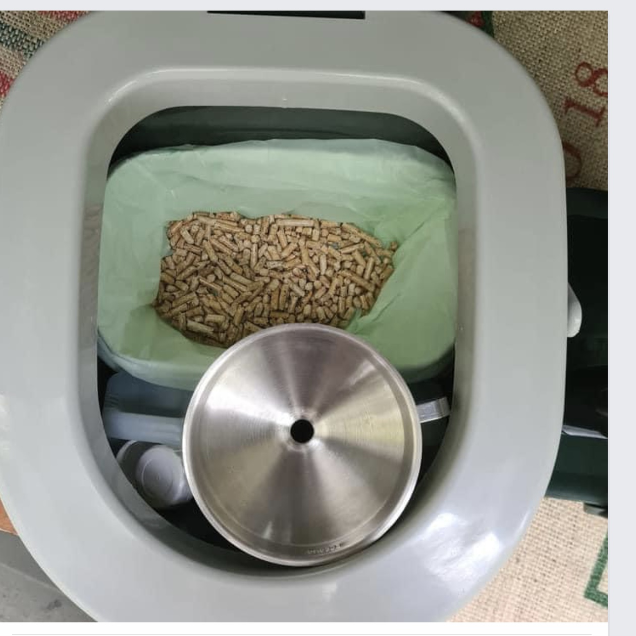

Mini Separating Toilet by Kayley Miles
Kayley says…
“This might help someone knock up a tiny and relatively cheap toilet. We have one in the boat already, this is for an equally tiny campervan, and will mostly be used for short weekend trips.
I couldn't find one this small and portable on the market. This setup was less than the cost of a separator.
I got the 15.5L toilet bucket for £13 on ebay but it appears to have sold out now. The same bucket is available on amazon.
The 13cm funnel is also from amazon. I've added a screenshot of the exact one.
Both the 1L bottles and 2.5L plastic tub are from H&O plastics https://buybuckets.co.uk/product/1l-light-weight-jerry-cans-with-cap/
The bottles and bucket fit perfectly. To secure the funnel and stop it wobbling about I found a cap that would fit the bottle (from a vitamin bottle in this instance) and drilled a hole to match the funnel.

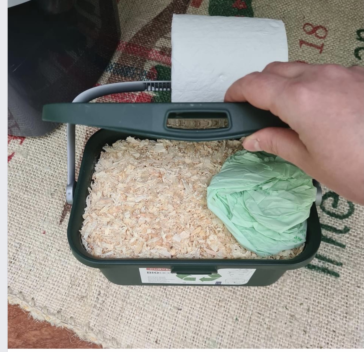

The toilet roll/ sawdust holder was a bucket I initially planned to use for solids, but was too big. At least I found a use for it!”
*Vickys note: the small rectangular bucket is relatively expensive when you factor in postage and I can’t find them anywhere else at the moment, the 1litre liquid bottles are easy to find on eBay. The containers really are quite small.
