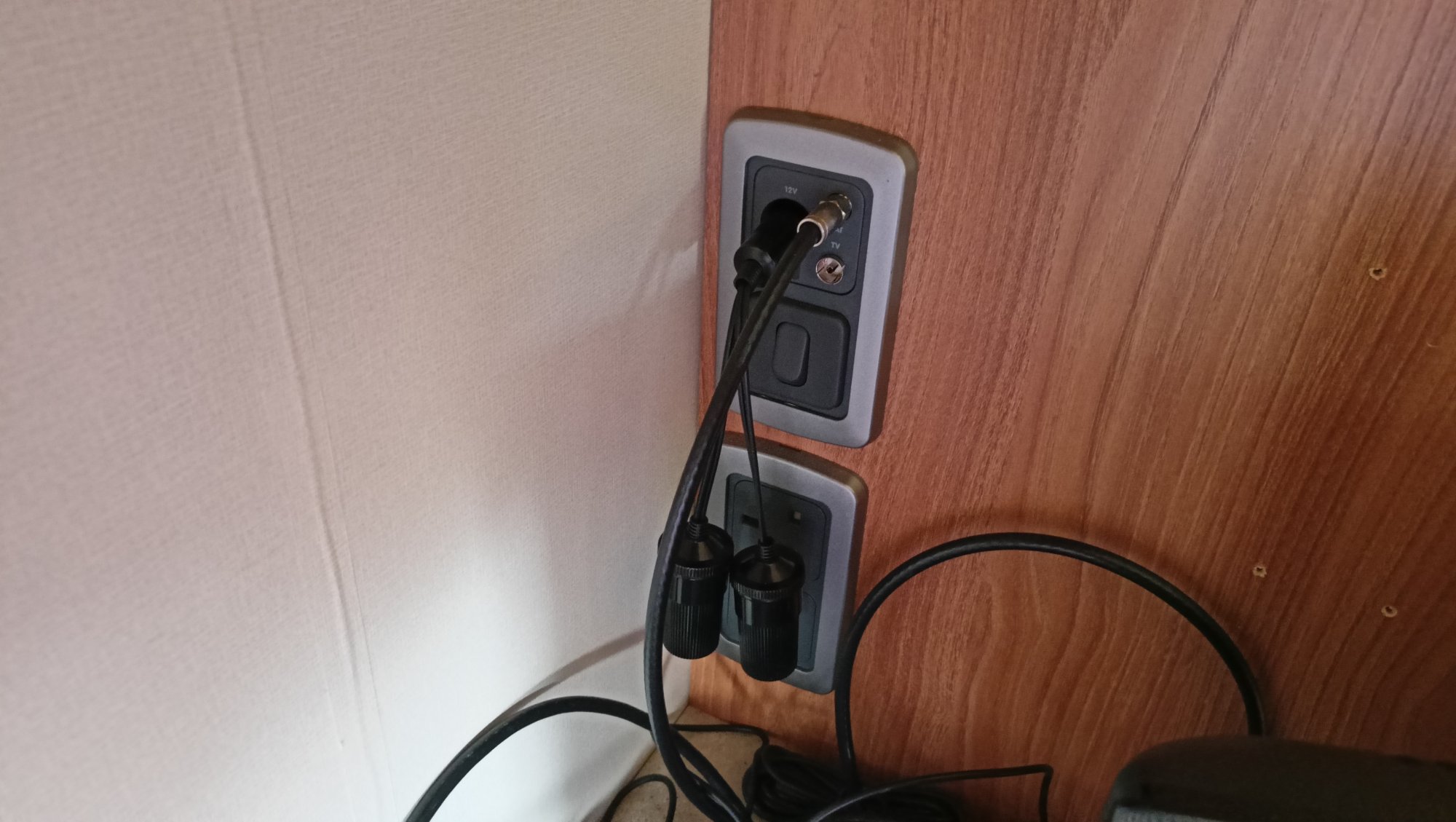

I have had similar problems in the past.Back briefly. I have another issue now. Well it's been ongoing for a couple of days. The only 12v socket on this van which is I think the one Swift fitted keeps blowing fuse 6 on the panel. It's fine with just the TV and the Freeview sat box plugged in and it was fine with the little 300w inverter for phone charging but the inverter threw up a fault yesterday and I heard the double adaptor spark. Fuse blew so I replaced it. Not used the inverter since but I just plugged a single usb adapter in (off the sat nav I think just now and it blew again. Replaced it and it's working through TV and Freeview box ok now. Not that we can watch it for long.
I can't decide if there is a fault with the double adaptor cable, the original socket or the control box. What it has brought to light though is how dependent we are on just one 12v outlet. I really need a couple more coming straight off the battery with an inline fuse.View attachment 133416
In my case it was a poor quality cigarette lighter plug that caused the fuse to blow. I don't recommend this as a long term solution but you may find that pushing the suspect plug in very quickly will allow you to use that plug and the fuse won't blow.
These plugs are unreliable if attached to a cheap Chinese made product. I have a small Bestek pure sine wave inverter and the plug on that is excellent and totally reliable. A stark contrast!
