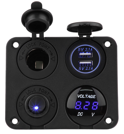

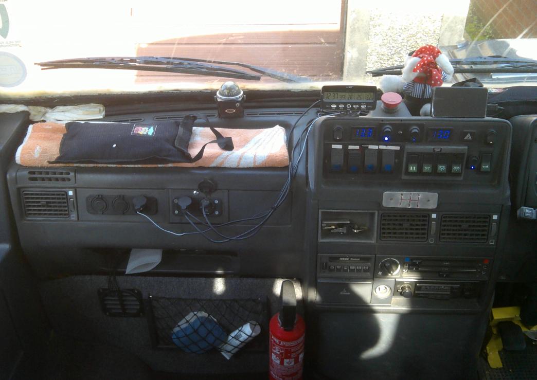

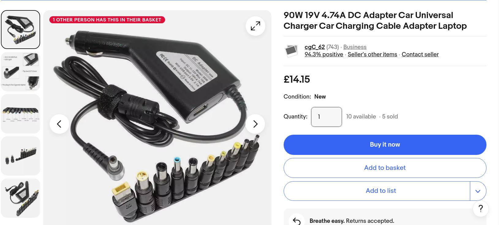

Why would anyone use a inverter to charge a mobile or laptop, usb and sockets all around.View attachment 134021View attachment 134022View attachment 134023View attachment 134024

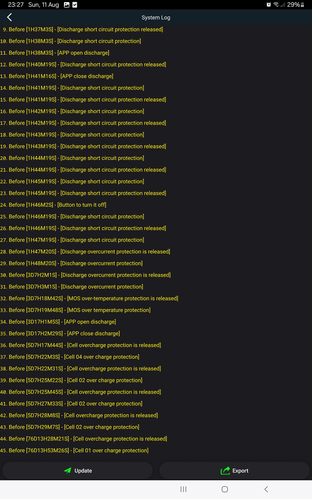

The bms cut in and shut down discharge on both jks.
Over current protection. 245 amps draw max 200.
That new water heater pulls continuously at 2000w untill reach and air fryer hadn't finished.
No bang ! But a nutter running around with shaving foam on face as they won't restart .
The invertor kept over loading bms on start up.
Needed help as black outside so no solar. Had to start van to boost the 12v system with b2b.
What would you have done ???
Lights on found razor started / finnest shaving.View attachment 134032
