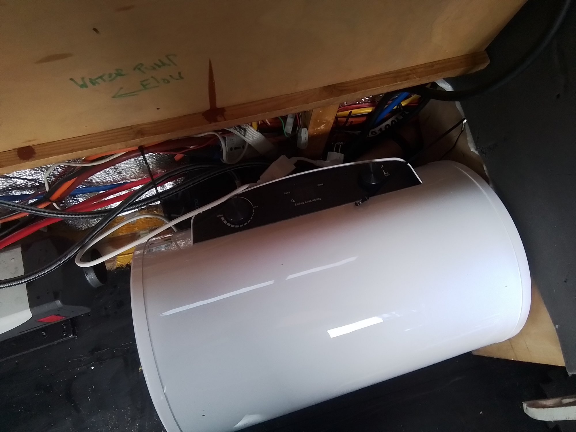

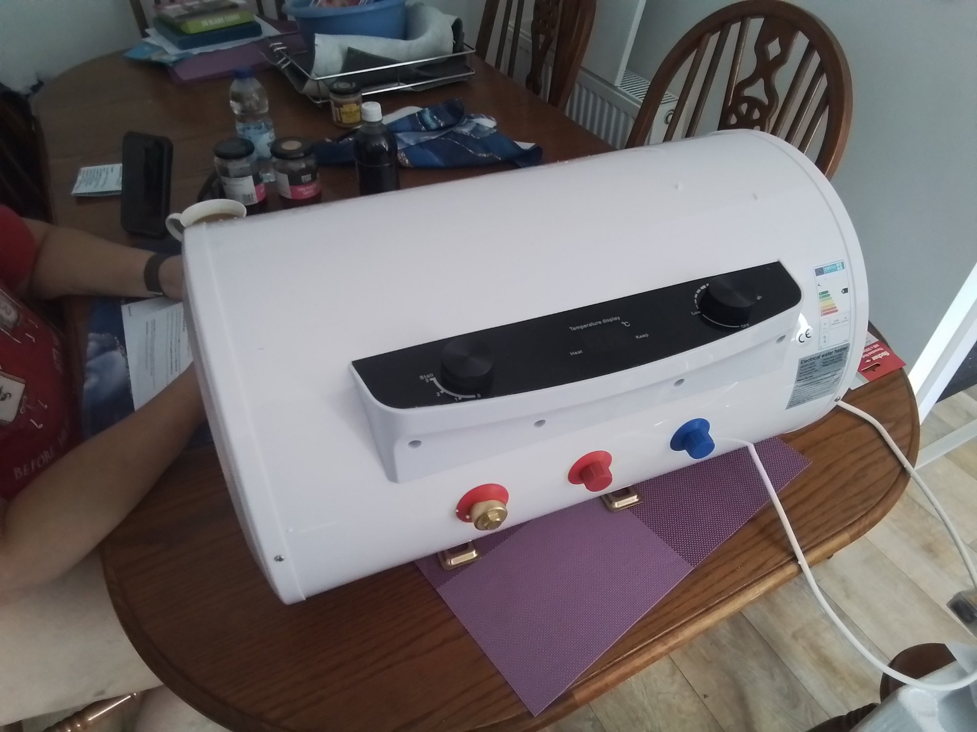

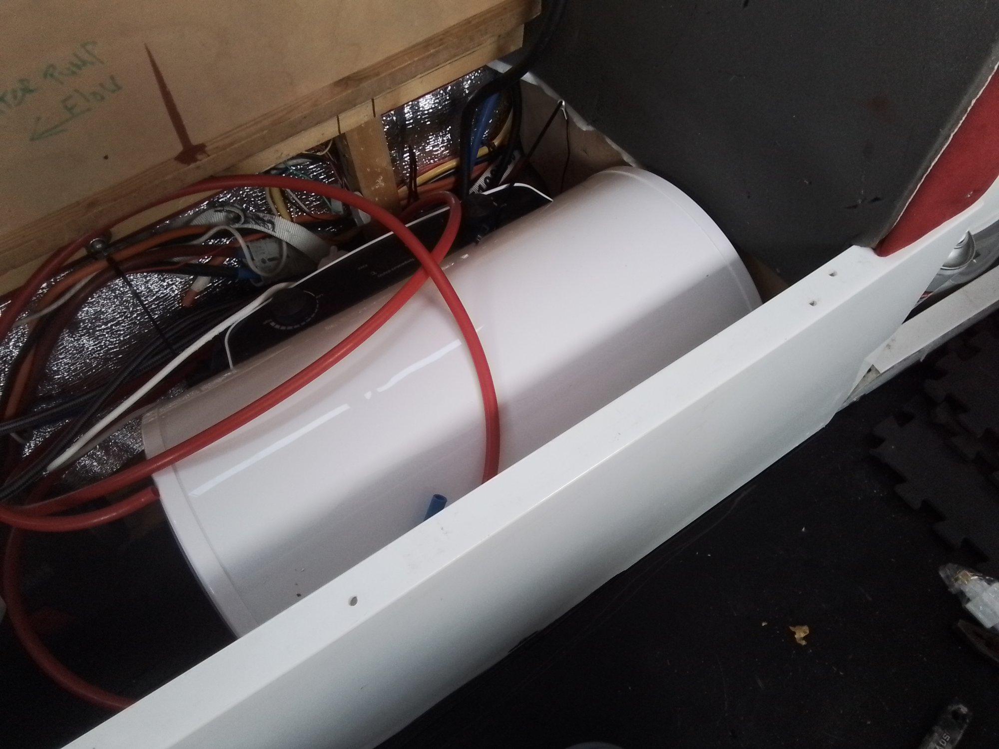

I just fitted a 30 ltr water heater @ 2000 watts lovley. Only four bolts and 2 pipes took all day. Lol
And a lagoon table thing. Im looking for top.

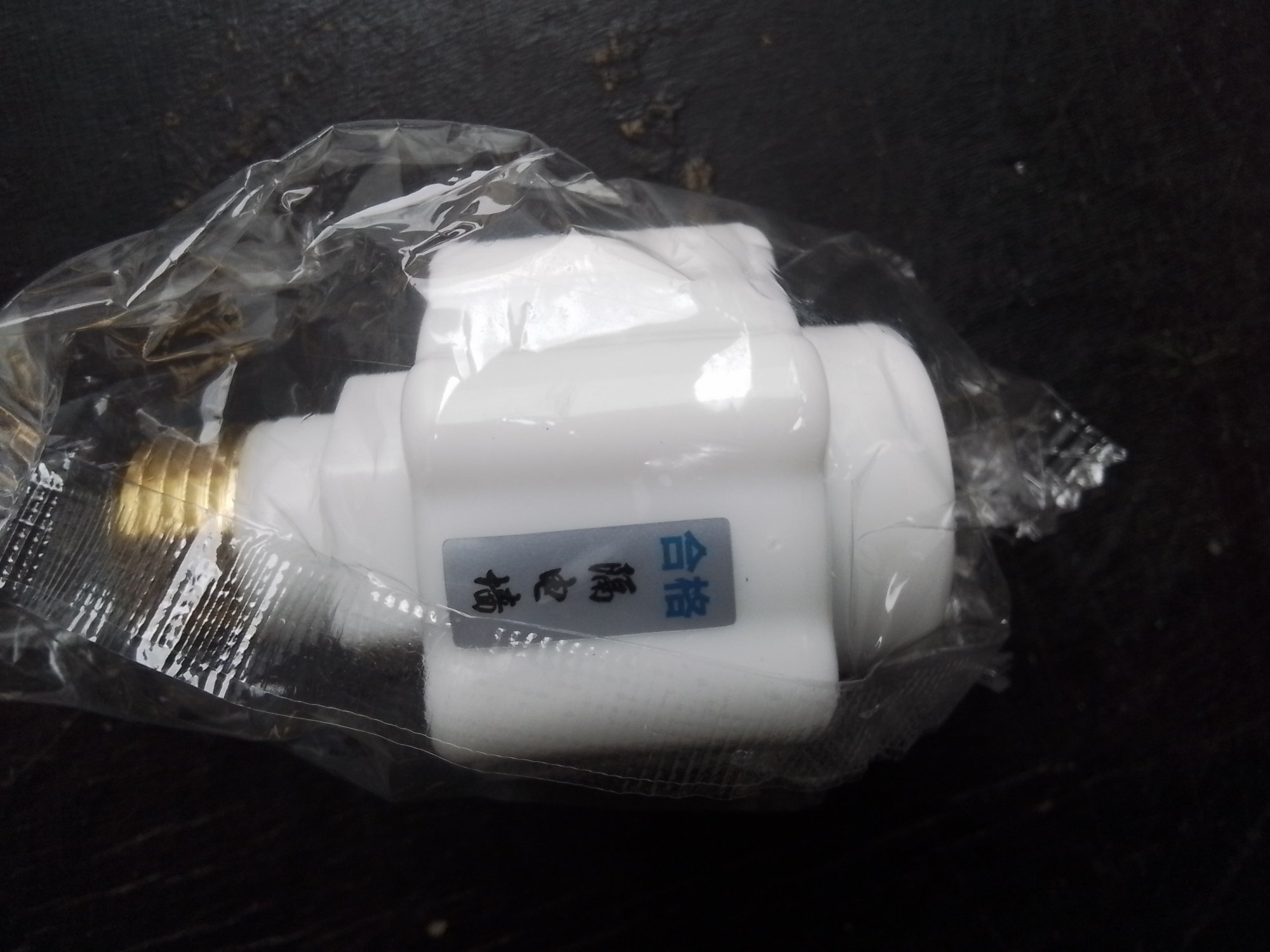

But what is this in the plastic bag there's 2 of them and you can blow both ways ?
Epic fail! :ROFLMAO:
