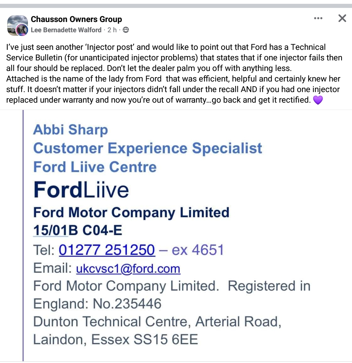

I don't do facebook so I'm safe there. I have a prejudice against people who use it, possibly unfair but I wouldn't take their criticisms of anything
A little harsh me thinks, but if you get injector problems this is who to contact
I dont hold grudges :D
Hope you dont get the fault but it's a ongoing thing with the panther engine.
