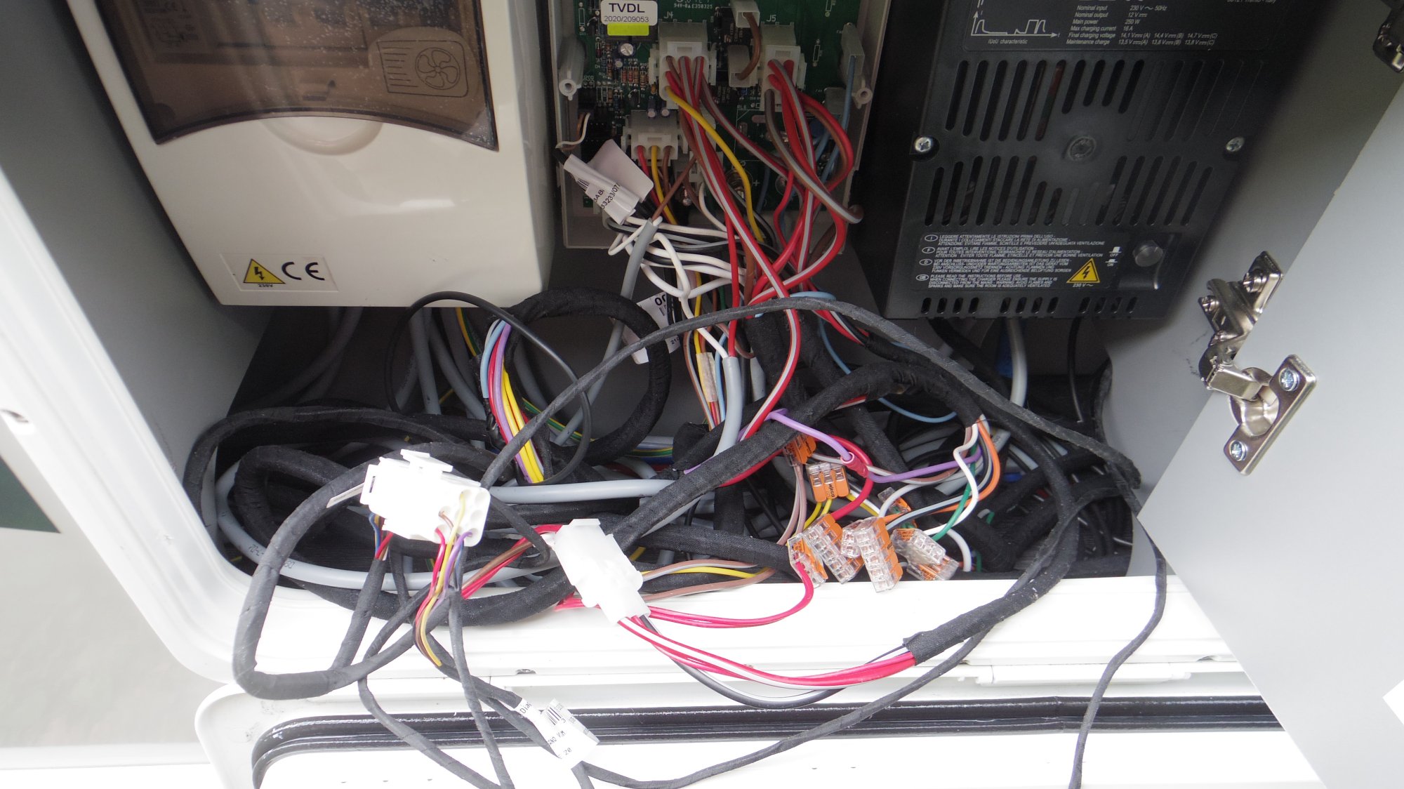

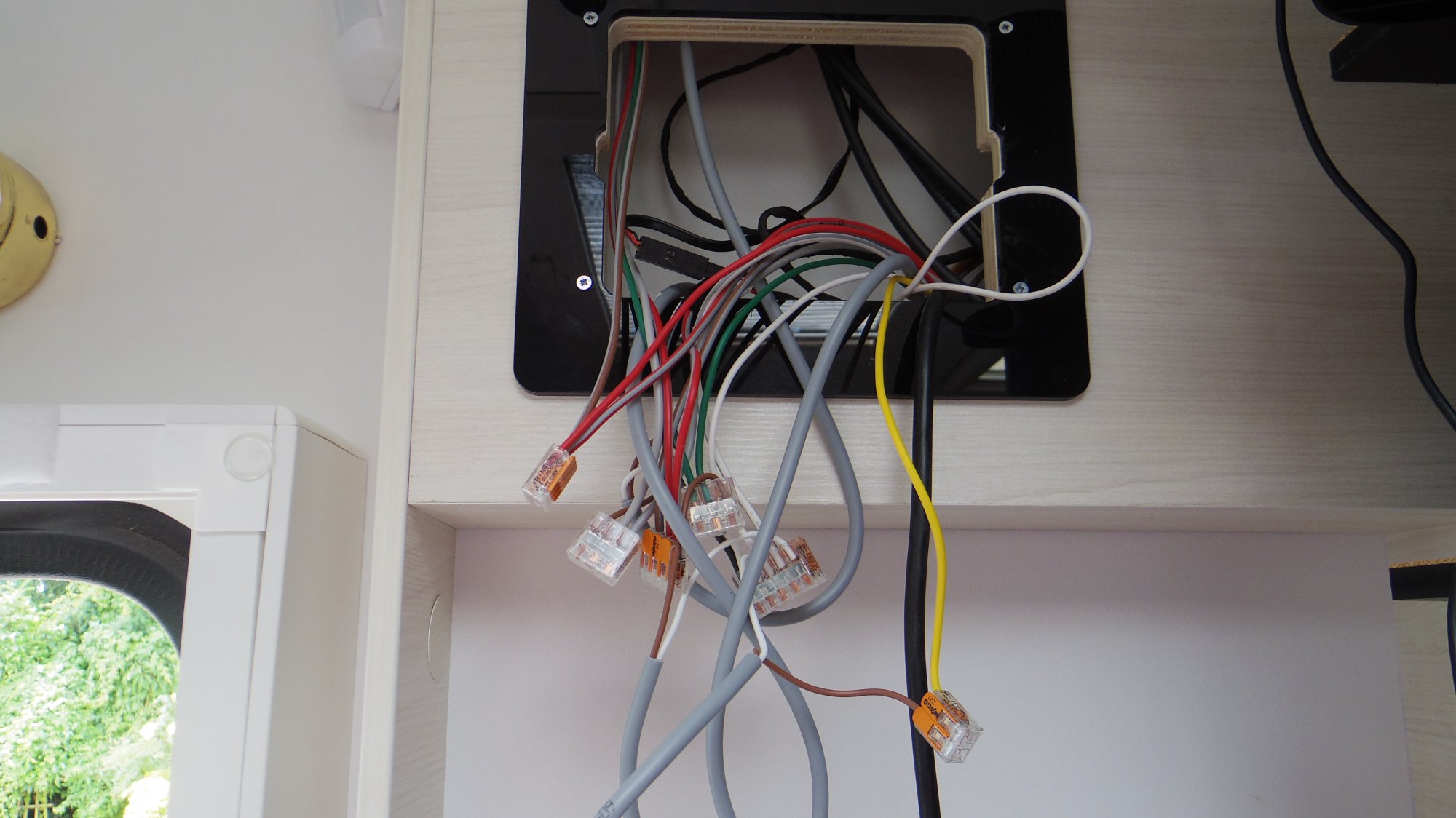

I've just bought a Transit based Chausson, one year old. The first job was to take the Transit to a Ford dealer and ask them to fix the rainwater pouring all over the engine electrics and the engine ECU. They said they can't, they are built liket that in the factory. So off to Wickes and bought some stuff and fixed that. An article will be sent to MMM.
Secondly the original dealer has fitted a lovely addition to the original electrics which were an additional LB, and one additional 120W solar panel. This is to run the diesel habitation heater, compressor fridge and all the lighting, water pump, and the electric bits of the water heater. So there's now 240W, a second 120AH leisure battery and a fancy aluminium charger box, and a MPPT regulator. All that, I am impressed with. What I am not impressed with is the letter printed by the original dealer, signed by them and by the first purchaser, to the effect that The Special Switch In The Wardrobe next to the MPPT regulator must be off when the engine is running. This is a simple one pole rocker switch. This will be forgotten while I own the vehicle so I have bought a change-over relay which with the engine off the solar panels will be connected, and when energised by the ignition on, will disconnect the solar panels. Apparently the poor diddums intelligent alternator (with an IQ of less than the idiots in Ford who designed the inbuilt waterfall over the electrics) can't cope with having solar panels so has to be separated from the panels further than a Prime Minister does from his partying friends.
I ordered the relay and some wire from Amazon, it came the next day, then we went away for a weekend and now I am back I can't find the relay and wire anywhere. The only way to find it is to order another one, and half a hour after ordering it, I will find the original.
Electric step: this Chausson comes with an electric step but no buzzer and no auto retract. So that will be the next electrical job, to make it retract when the ignition is on. I need a relay and a limit switch, and 12v on when ignition is on, and off once the step has retracted. So today's job is to find a wire with +12v when ignition is on, and 0v when ignition is off . .. . . . there are plenty of wires to choose from: :unsure:
Not turned the 12 volt off for over 10 years...
Gas fridge gave up though :ROFLMAO:
@gasgas Not sure you should blame the smart alternator for not being smart enough. It can probably cope very well with the one engine battery it is designed to cope with. Presumably there is a B2B fitted to charge the leisure battery without upsetting the smart alternator. With the alternator already isolated from the leisure battery by the B2B it is unlikely that the solar will be affecting that. My suspicion is the switch in the wardrobe is because the B2B can’t cope with the solar panels raising the voltage of the leisure battrey.
Your idea of a relay sound like a great solution. Shame the installer didn’t think of that.
View attachment 121083View attachment 121084
I'd get a B2B fitted as a priority, no need to faff with the relay AND both of the leisure batteries will charge properly so you'll have a greater battery capacity and they'll last longer.
I would expect a 1 year old Chausson to have a B2B as standard. The problem the switch/relay is dealing with is more likely to be the interaction between solar and B2B.
