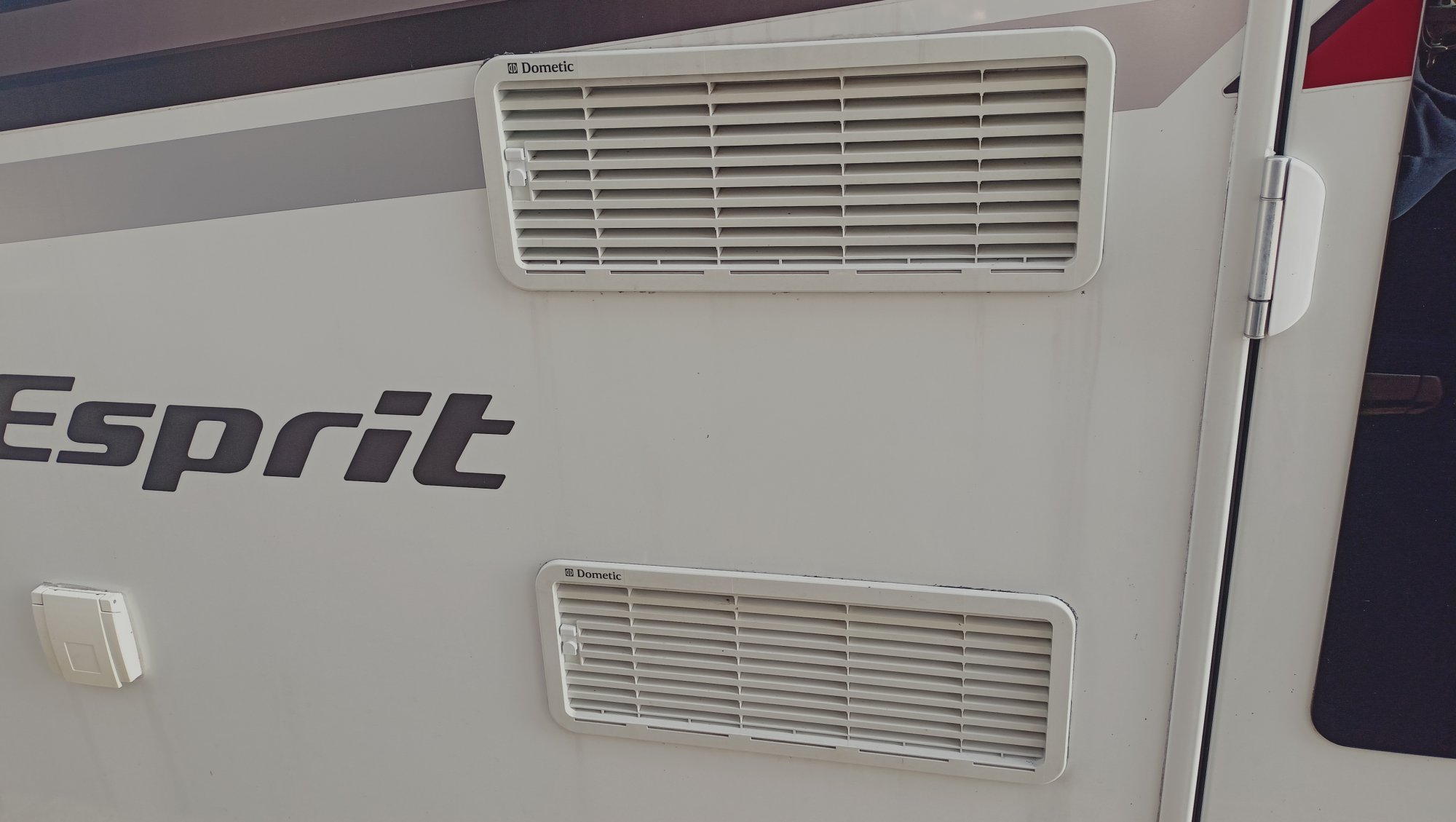

Anyone know where ill get some of these. Been reading up on them and its probably something we should have done on old Hank 1 to stop all the crud fouling up the jets and flue over winter but apparently they also should be used below 8c which of course it will be when we are away over winter. Some say just the bottom one is needed for use on hookup. I gather when its cold the fridge can struggle to keep stuff cold (I know its sounds daft) without the vents on.
Are they a standard fit size does anyone know? Best place to find them?

I'm still sure the top one is incorrect, if there is fridge flue behind there surely it would discolour over time
the clip picture looks perfectly right to me.
Kev, the top vent was like mine and the bottom vent goes full width.
The flue is metal and is behind the small piece on the right which is a seperate section.
If the fridge is running correctly it does not discolour the plastic, mine was over 17 years old when i sold it and the colour along with the rest of the fridge vent covers were only slightly different ( a little more cream than white ) from when it was new due to its age and the sun.

The item number was ideal cheers. I searched all over ebay but I couldnt find the bloody things. Maybe I got confused on all the model numbers. Anyway ordered now so thanks again.
