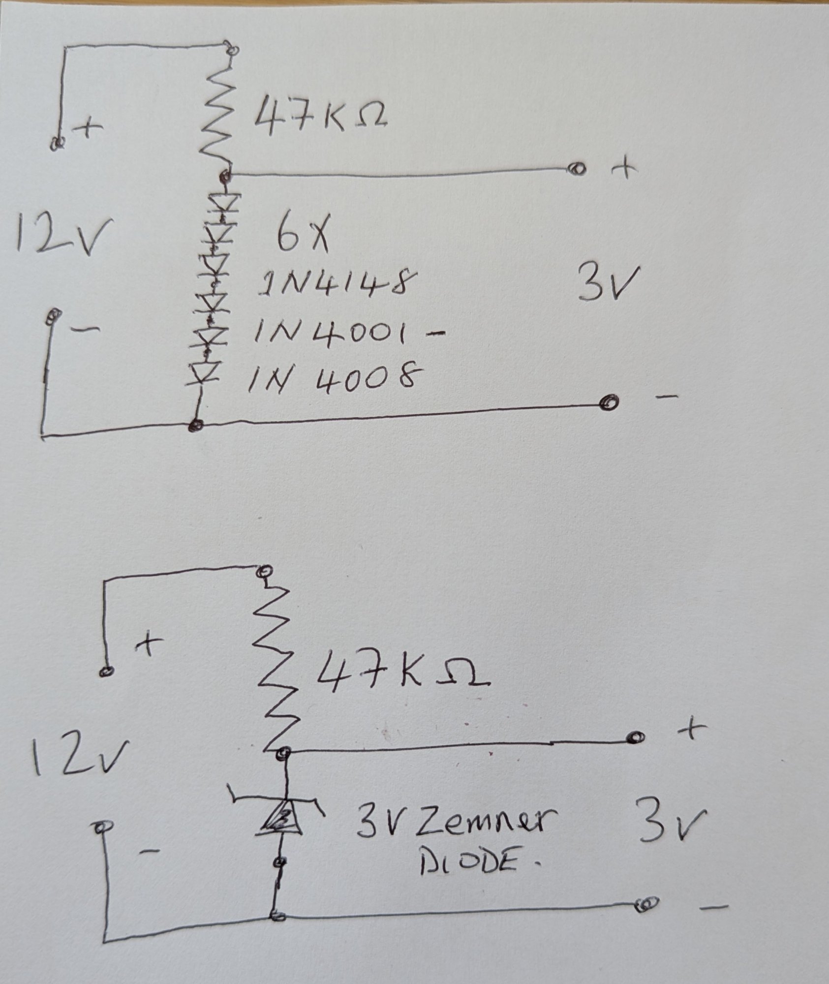

Yep, or scrap the batteries and the USB supply altogether and use a simple resistor (20k -100k) and a 3v zenner diode.I see that the display has a 3v supply using batteries. Rather than having to change the batteries it should be possible to use a USB power lead. In case 5v is too much voltage putting 2 or 3 diodes in the power lead would drop it down to a acceptable voltage.
Or substitute the 3v zenner for a string of 6 conventional diodes.
This would cost pence to build and would fit into the battery compartment.
EDIT.
You of course only need a string of 5 diodes not 6 as drawn to give 3v. Well done at the back!![]()

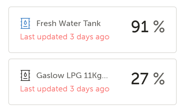

I'm guessing the Mopeka sensor is on the bottom of the tank? It looks like it reads ok through the plastic ok. So I have 4 Mopeka sensors, the 12V wired one on the top of the fresh tank, 2 on the Alugas cylinders and one on the waste tank. All work well apart from the one on waste tank which is a bit odd. Mopeka are sending me a spare but as I was a tight bu**er only to my original address in TN where I was working at the time. Fortunately an ex-colleague is out there this week.bit like my standard one, which goes by 25% increments.
The Mopeka is a bit more precise. This is my tank data (not up to date as my on-board router is off at the moment)
