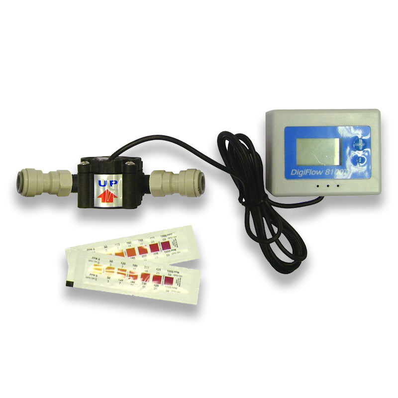

Fitted today.
Very simple job
Measures litres used
So when I fill the tank I reset and it then it counts down the litres.
I now know a full freshwater tank gives me 88 litres!
I like that Martin.
Wonder if they do similar with a round flush fit control unit - I'll look around as I have a hole to fill in my galley where my heater control was.
Thanks for the link - A great idea, I was going to make one (I even have the flow sensor), but at that price, its not worth it....
That is a nice solution :)

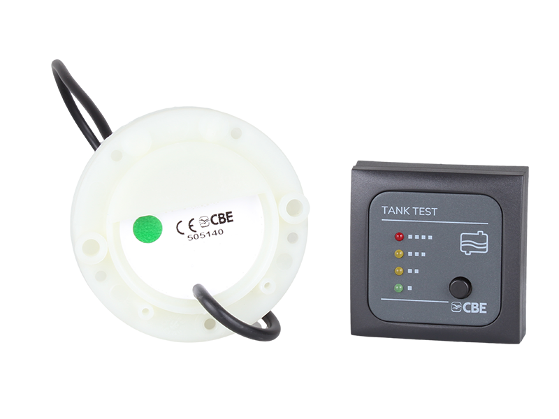

I see that CBE do a tank level display which would be a better fit in my galley, but it only shows as thirds of a tank so not as precise as Martin's solution.
The other thing with those is you need a tank that has a top filler :) Would be little use in the typical Autotrail Motorhome where the large filler is on the bottom and no access to the top of the tank at all.
Very true, would be easy to do on my van but it's too vague for me - 1/3ish, 2/3ish, fullish.
