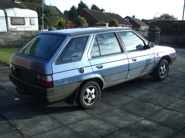

Only 80 th,here my old car at 314.000 & i flogged the tubes out of it,boot to the board.
