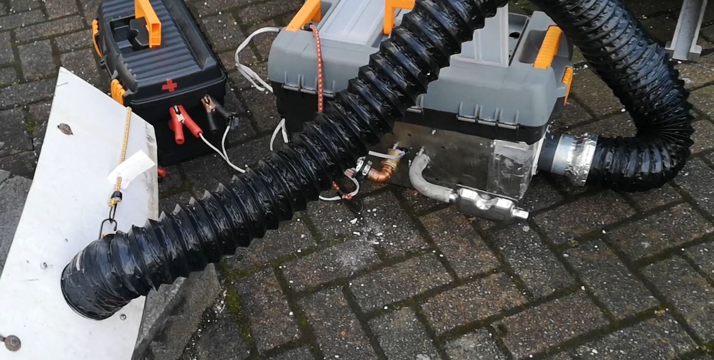

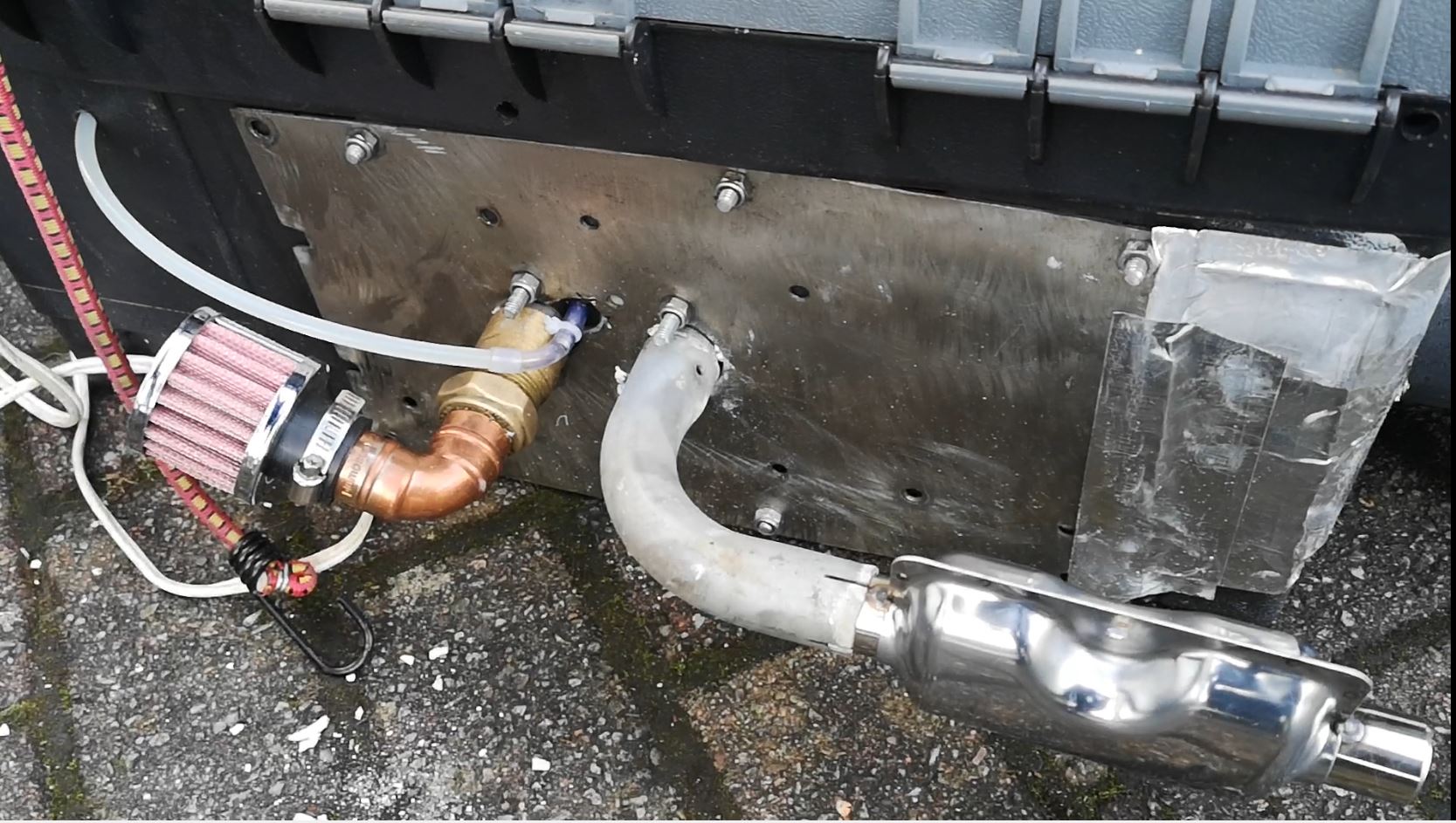

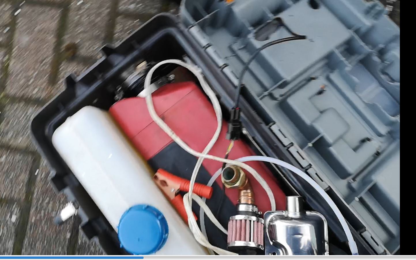

here is one i made up myself the ducting can be used on my caravan gazebo and the white sheet fixes in the rear window of my stealth camper car .
everything is outside and very quiet the only sound i hear is the hot air fan.
will have to get proper pictures but you get the idea

Do you find the silencer works OK i thought the optimum length of Exhaust pipe was about 1M mine is that and 2 silencers.

cant hear a thing in the van apart from the hot air fan .
tried 2 silencers couldn't hear the difference the motorcycle crankcase air filter makes a big difference
Its not particularly inside although if you fit it correctly with the proper thermostat the loud fan noise is cut by 75% the reason for the intake and exhaust silencer is to cut external noise for others
A run on kero now and again is a great idea as it can help clean the combustion chamber etc....
However I can't understand the obsession some folks have pfaffing with, separate tanks etc so they can run on red/kero as they use so little road diesel the savings are ridiculous....

Apparently the Chinese ones consume approximately 1 liter every 10 hours if kept running but I doubt if you'd be able to stand the heat so the thermostat will be turned down a bit which will make them more economical?
Most of the Chinese ones can be throttled back by reducing the pump pulse frequency...
But I'd still go for the 2kw version over the larger 5kw etc as 2kw is plenty.
