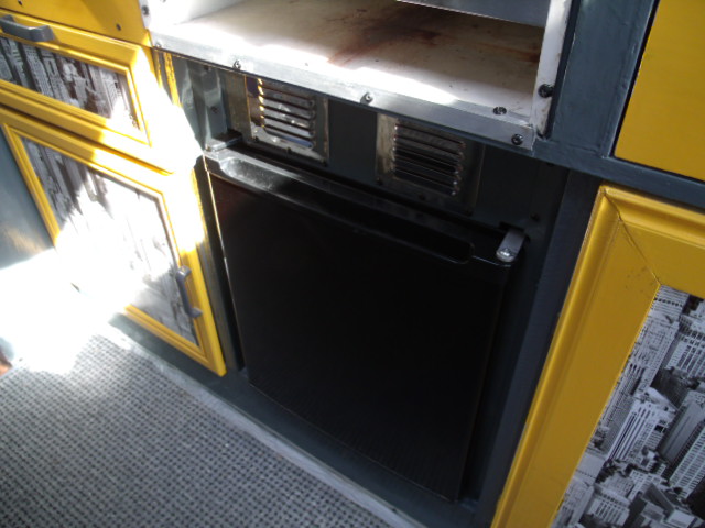

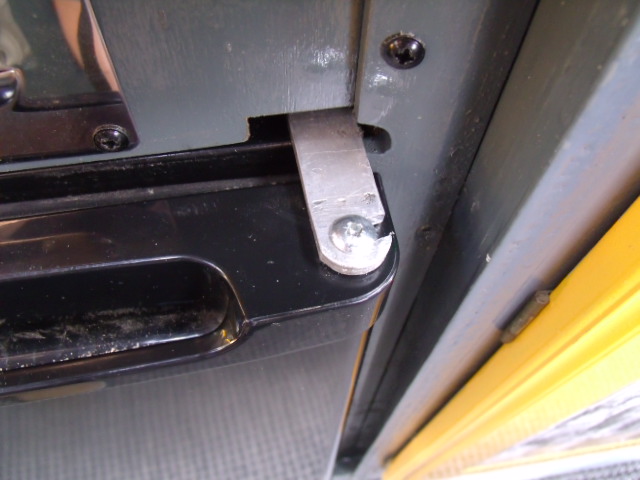

Can you recommend a fride? I have an inverter.
I have one of the small sealed units which will run 24 hrs 180 amp hrs batts on a smart soft start inverter, these fridges cost about £75 new, we got ours from facebook market place unboxed but not used for £50

I thank you for the very informative reply that has decided me on which way to go. Can I assume that you have no rear ventilatiom resulting on internal grills? Now on the lookout for a low powered 240v compressor fridge and hope I can get the same bargain.

I went the same way after getting fed up with wasting gas
The fridges temperamental ways (level/wind in wrong direction)
And having to empty the stuff out of it when we get home before heading off again a short while after.
Bought a cheap cheerful lowish consumption fridge via amazon @£100 (I was stuck on size and colour)
And a victron 12/800 inverter (I've already got other victron stuff so it made sense for it to tie in)
Already had 400w solar on the roof and 3 x 110ah AGM batteries.
A complete game changer
