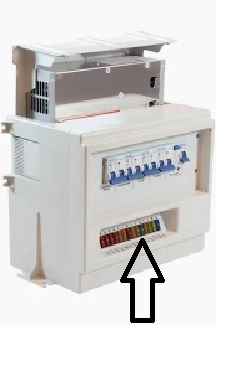

The fuse panel something like this but you may not see the wires like you can in the image, you're looking for a row, possibly 2 of coloured plastic strips,

Your picture is an under bonnet car / van fuse box which does not protect the motor home 12v devices.
MoHo devices are protected by separate fuses usually integrated in the PDU.
Yep, obviously NO idea what his 12v fuse setup will look like just trying to show the row of coloured plastic tops that the OP is looking for.

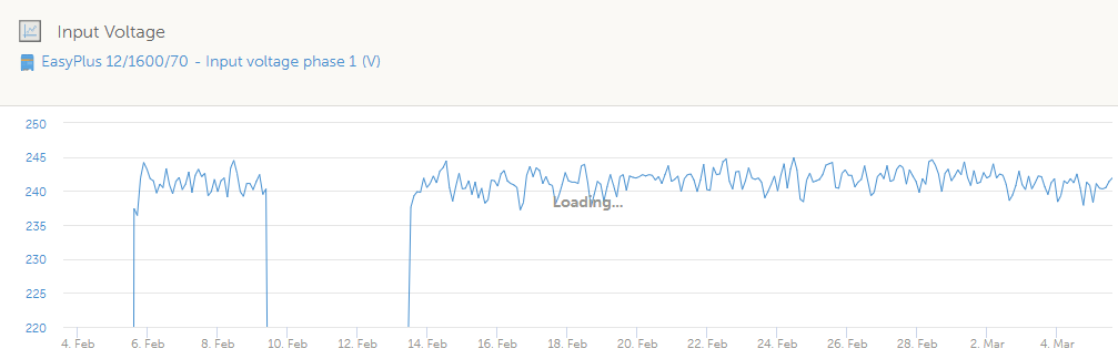

FWIW, the mains supply in my area is typically over 240V and often at 245V and I have only seen it go below 240V on very limited occasions and never down to 230V
Last 30 days ... Interestingly, it is dipping under the 240V more than I realised, going as low as 237V, but on average probably 242V?)
