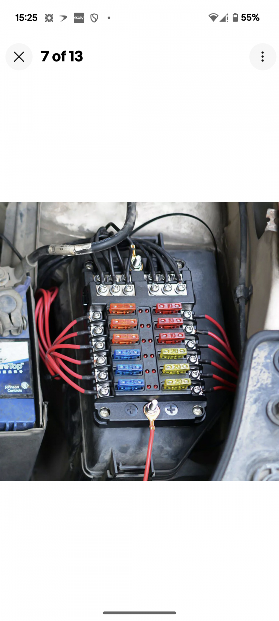

The fuse panel something like this but you may not see the wires like you can in the image, you're looking for a row, possibly 2 of coloured plastic strips,

Any chance of a photo.
