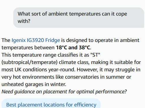

It's worked well in over 40c for 3 months last year and another couple of months at 35c plus this year... along with normal use

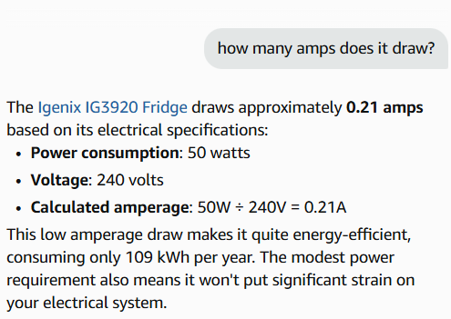

A 12V Compressor Fridge tends to be very pricey. A 240V Compressor Fridge is a lot more cost effective (as an example, my LEC 240V Fridge/Freezer I have had in the motorhome for the last 5 years was less money than I got for the 14 year old Thetford Fridge/Freezer I took out).

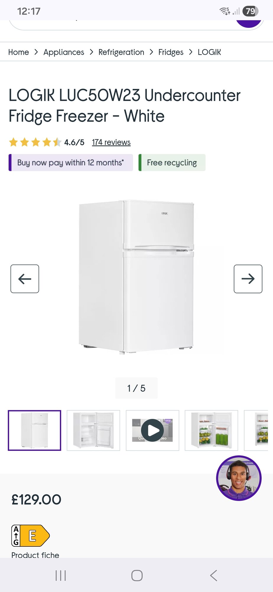

Size seems to be the main problem if going for 230v domestic ones.
Mine RM7360 is "supposed" to be H825 × W490 × D515; domestic ones seem to be around 840–850 high.
So can I ask which make/model you've fitted under counters with no mods to the van please?

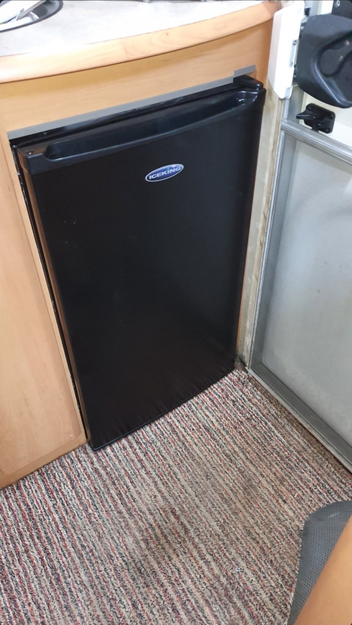

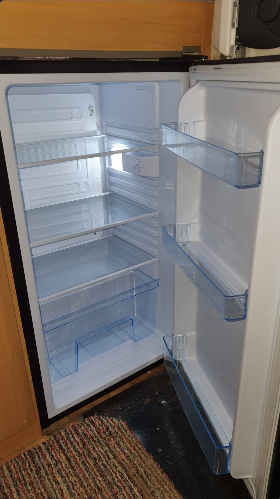

Another vote for the 240v domestic option....
I found one on Amazon for £130...
Already had solar/batteries and Victron eco mode inverter... So it was a no Brainer for us.
Chose one exactly the same size as the one I removed (and got £150 for it on ebay)
Chose an option without a freezer compartment...
Bonus More useable space inside than the 3 way...
Sits and fridges 24/7 through most of the season...
Doesn't care about the heat
Doesn't care about being level
Doesn't care which way the wind blows
Etc etc.
It was easier to fit than I expected. A small dog leg bracket screwed to the spare door hinge hole on top of the fridge and the underside of the worktop.
Childproof locks from Temu and that was all.

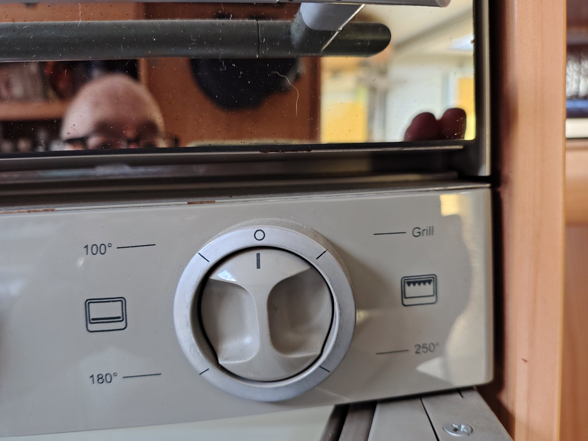

i took the fridge out my hymer not long after buying the van went for a ne w 3 way as i wanted to maintain continuity in case it got sold 10 years on wish i hadn’t bothered as others have said easy to remove once electric and gas connections have been removed and i needed to remove the fridge door to get it out of the van door , having removed the fridge from the housing i took the oven of and later replaced the oven with a microwave the air fryer replacing the oven
