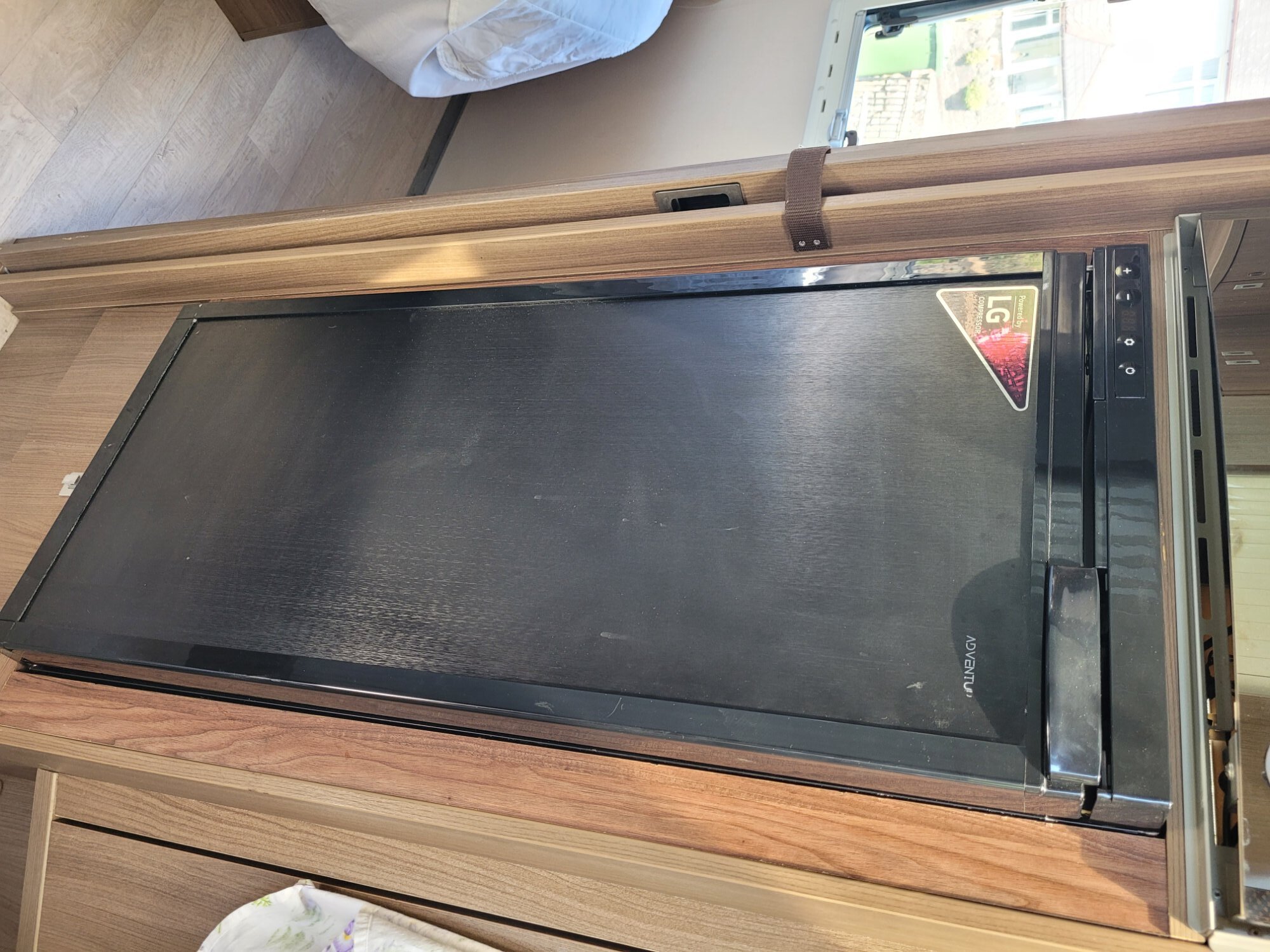

Dometic fridge removal.

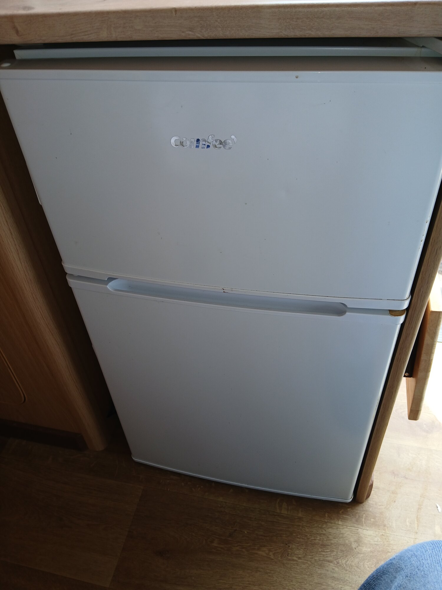

AO I found a great source and selection of fridges. In fact, it was one of the few places where I could get close to the physical size I wanted.

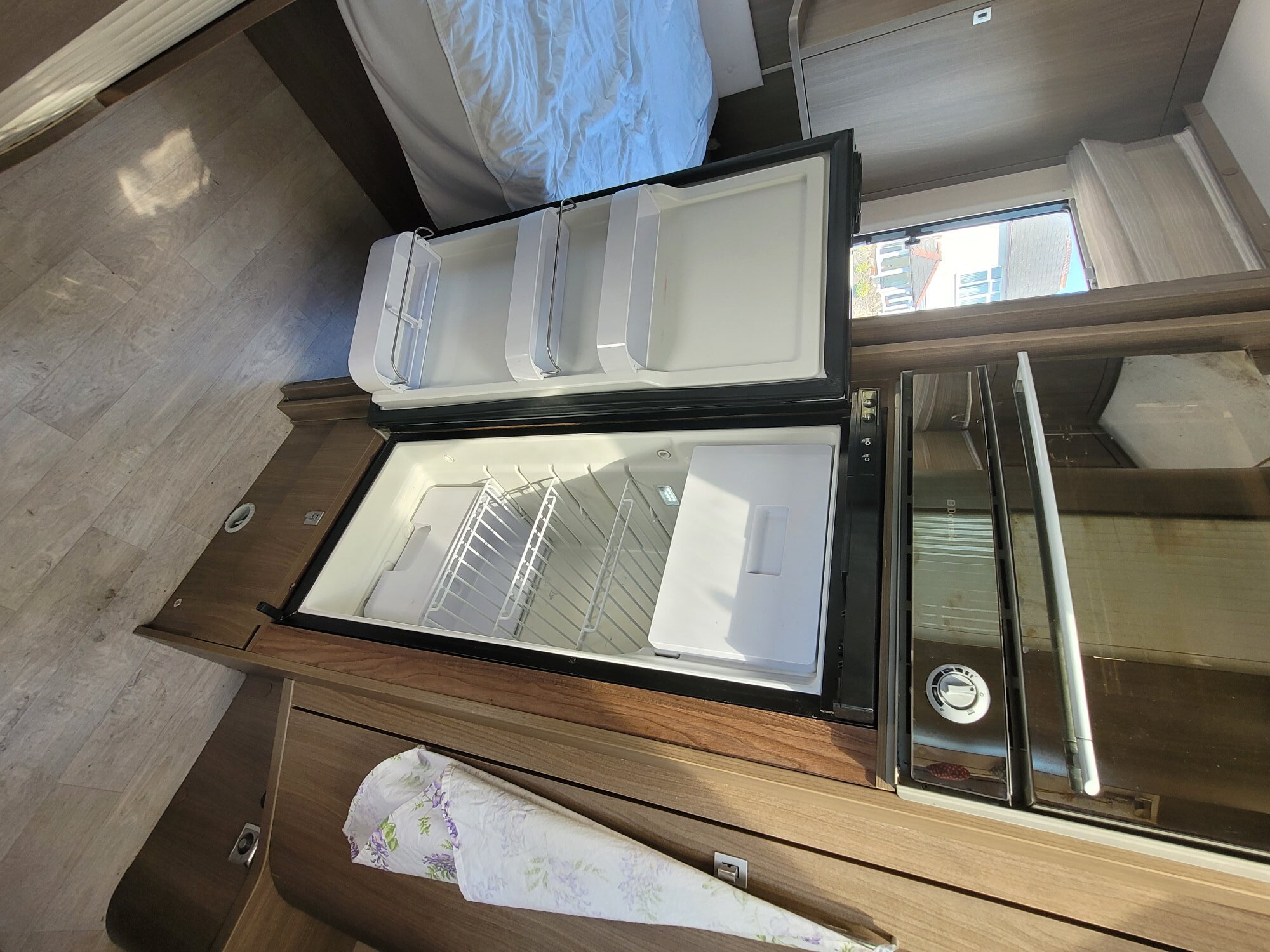

Despite my 240V fridge/freezer being physically smaller than the one I removed (albeit by only an inch or so sideways and height), I got a significantly larger freezer space :)

Can't see one but the freezer is 2star. It's a Comfee.

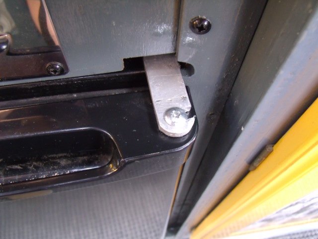

It just reminded me looking in it, that I also replaced the glass shelves with plastic.Here's a pic of the bracket I made.

The other thing I changed is moving the 240V outlet from a cupboard under the fridge up to behind the fridge on a new socket so I could just plug it in without having to mess around with the new fridge's plug.

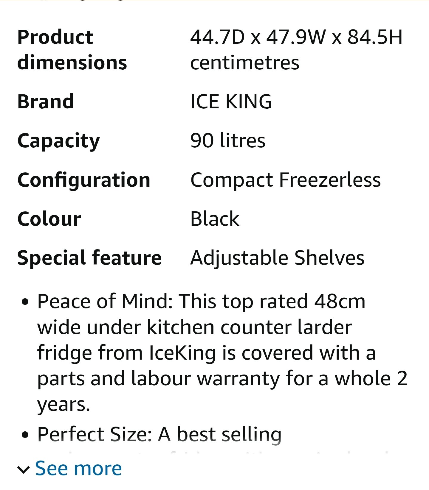

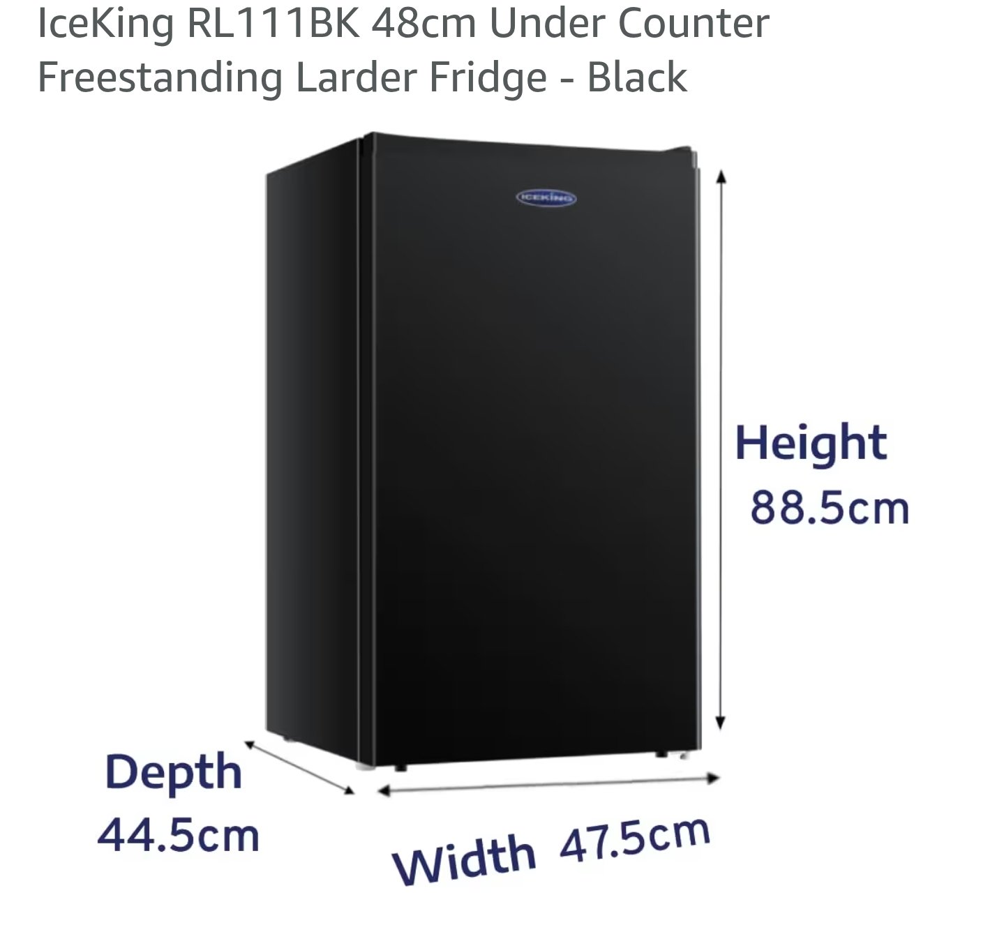

This is the one I fitted.... I could've had black/white/silver....
With freezer or without...
I went without to give us more useable space and we usually have our Waeco 12v compressor cool box with us that we use in freezer mode on longer trips.

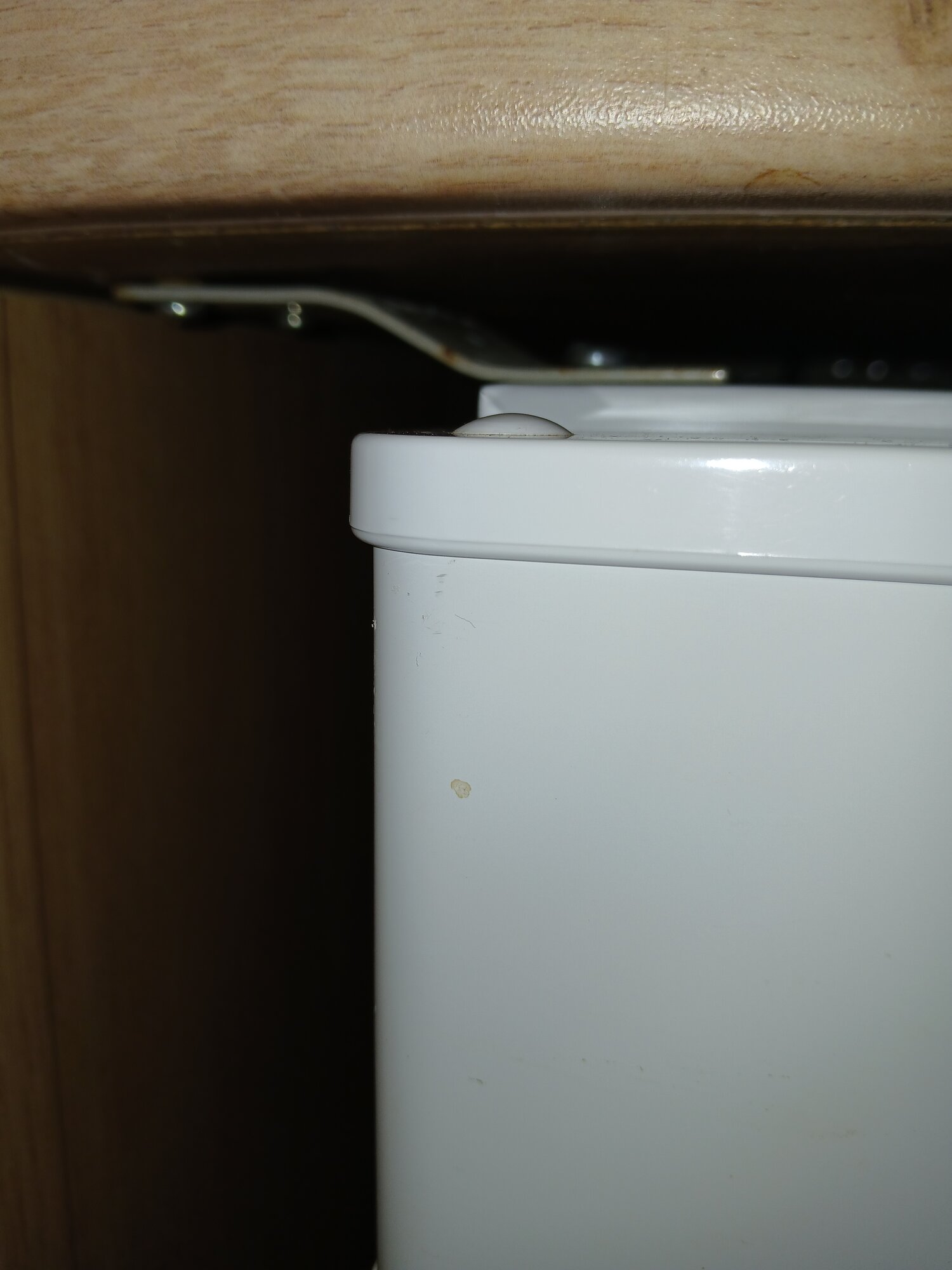

Fitted pretty much perfectly.... Couple or so brackets and a catch for the door..
Turned the gas tap off on the manifold and disconnected the gas pipe at the manifold and fitted a blanking cap at the manifold but left the pipe in place incase I ever have a use for it (highly unlikely)
And used the the 240v socket from the cookers single electric hob (that we've never used)
