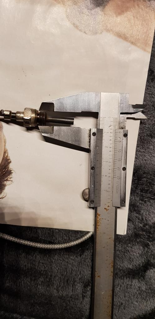

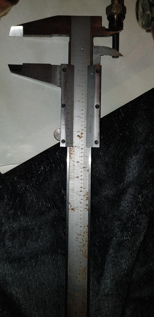

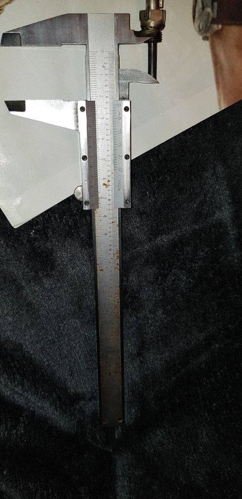

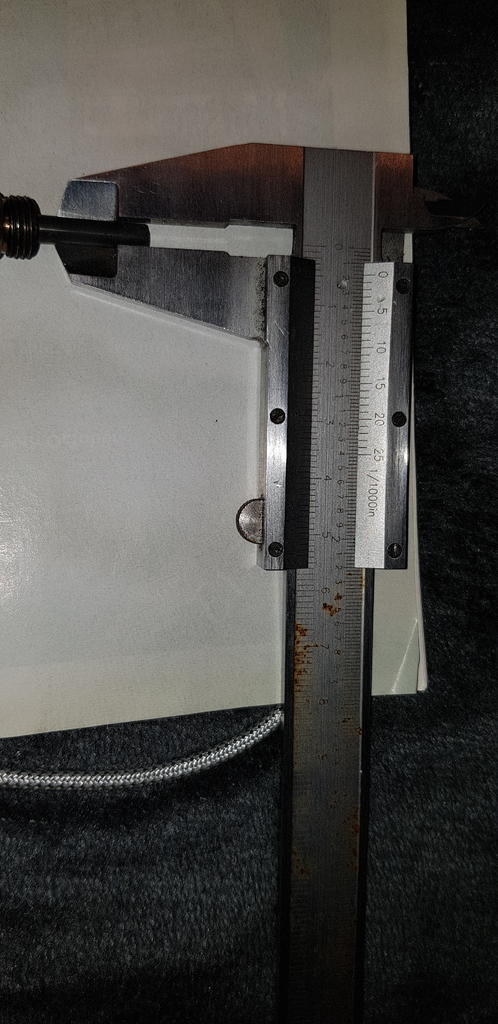

Do you have your old plug if so can you measure it up for me please,. Thread size, pin length and diameter. :cheers:
