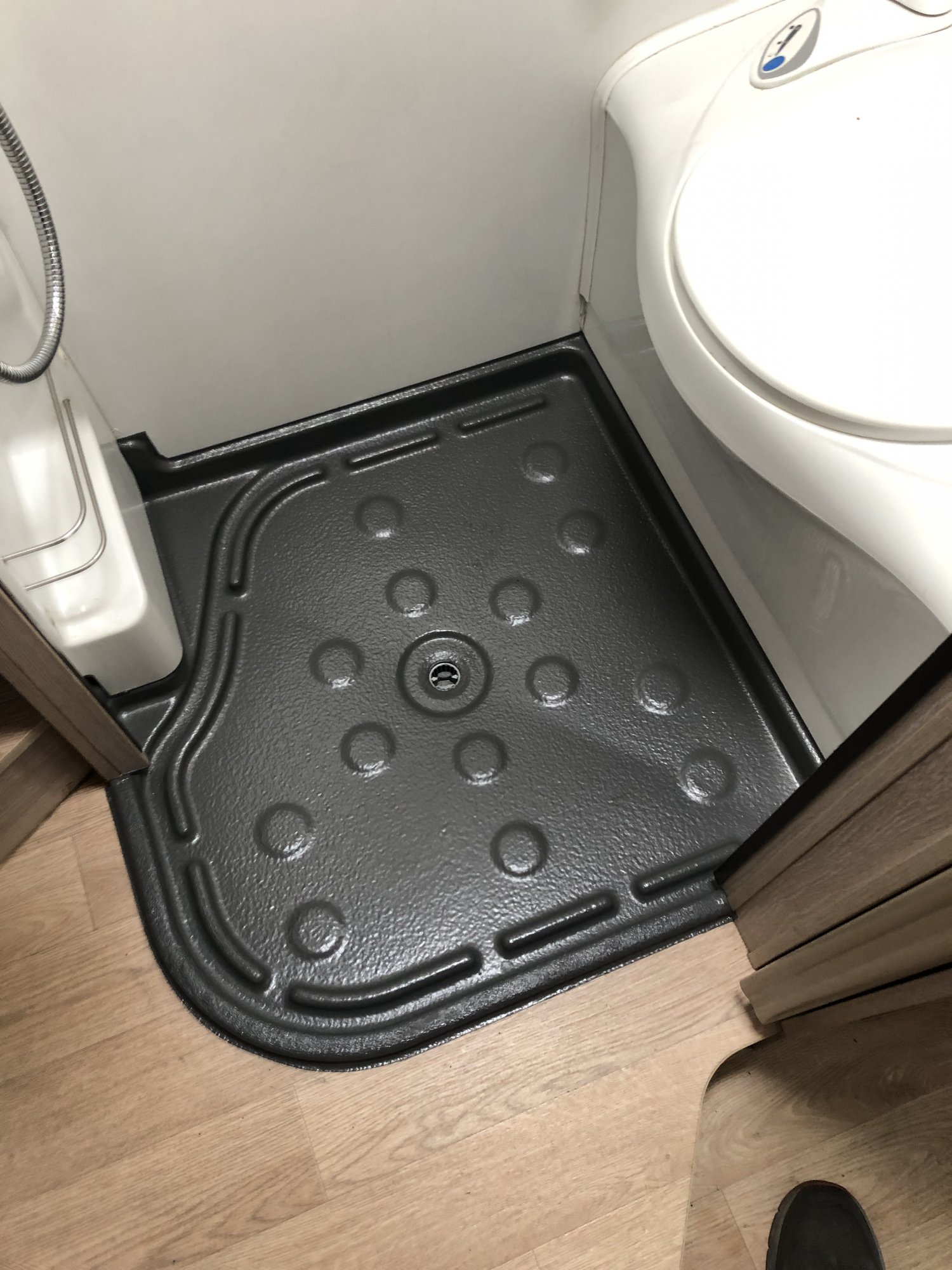

Finally decided to use Speedcoat at Ludlow. Great people, great job and very pleased with the result.
Hello.
It was all done in situ. They started at around 10am and it was finished around 15.30.
£375.

Cheers :) .... Did they come to you or you have to go to them somewhere?
Did they do any work to give extra support underneath for yours?
Hi
They could have injected more support underneath but in our case it was not necessary and could have lifted the tray.
We went to the main place in Ludlow after telephoning several other concessionaires but receiving no reply.
We always thought Ludlow the best option anyway although a bit of a track for us.
Contact David at Ludlow. He will do you a good job and quickly too.
