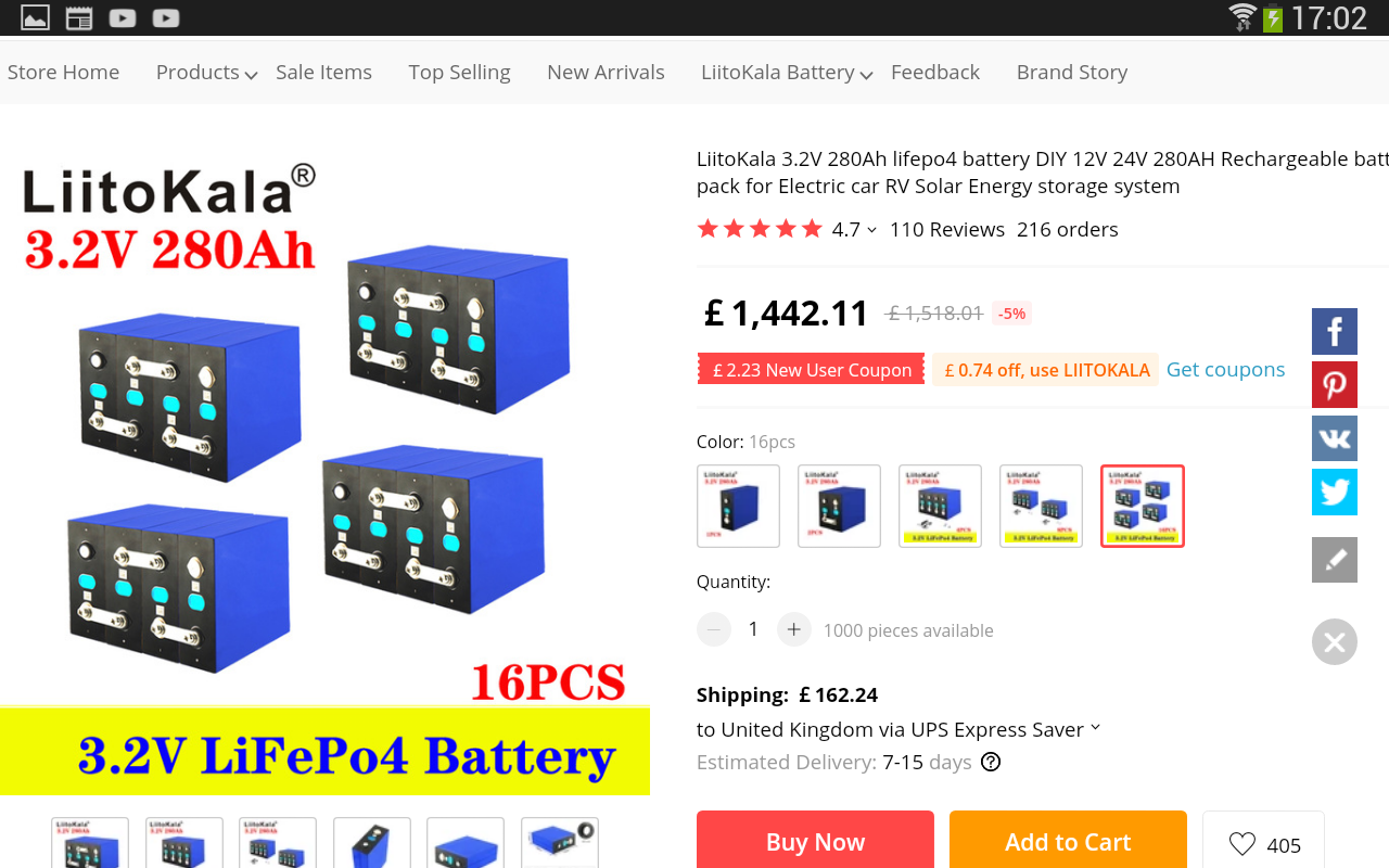

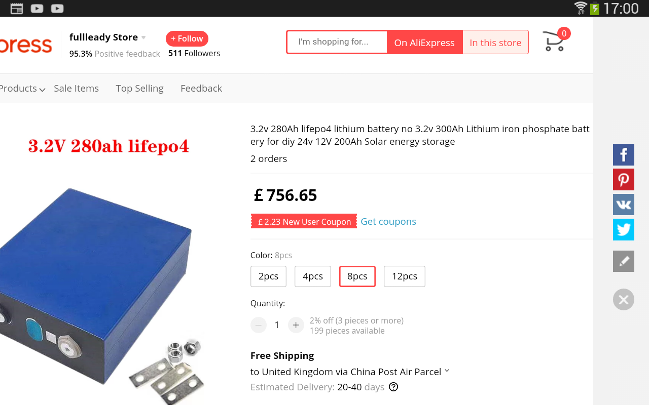

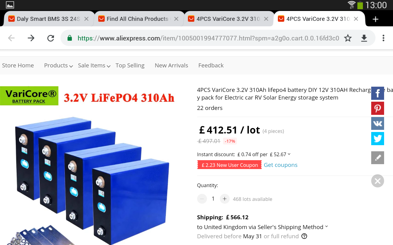

The way I read the screenshots in the first post is this:
FIRST ONE: 16 x 3.2V 280Ah Batteries for £1,604. this would give you a 12V 1,120AH Battery bank
SECOND ONE: 8 x 3.2V 280Ah Batteries for £756. this would give you a 12V 560AH Battery bank (or get two kits? 12V 1,120AH for £1,512)
THIRD: 4 x 3.2V 310Ah Batteries for £978. this would give you a 310AH Battery bank.
add in cost of BMS - need 4 for first, 2 for second, 1 for third. Around £40 each say for a decent one?
then the packaging, boxes, bits and pieces.
Of the ones you listed, the last one is much more expensive than the others per AH, the middle one appears best value
