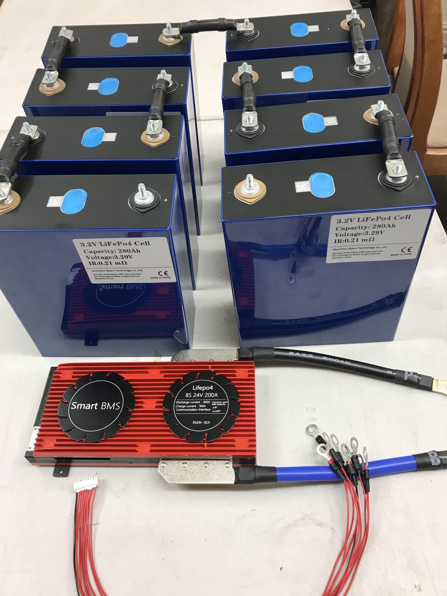

Ho so pritty. !
And daily bms nice. 24v or 12
Ho so pritty. !
24 voltHo so pritty. !

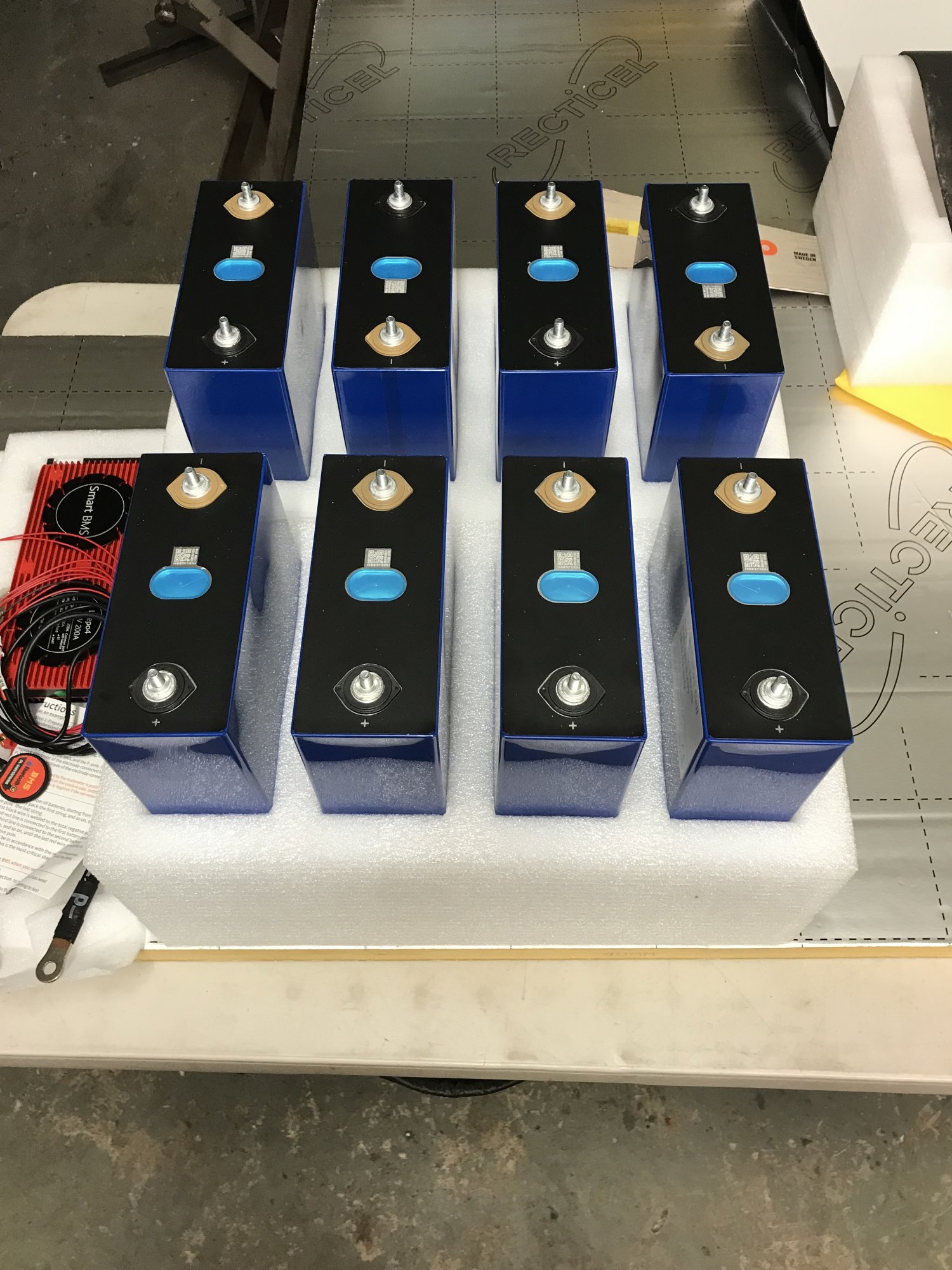

I’ve decided life is to short and I’m not prepared to mess around to much. I’m just going to make a simple pocketed box lined with high density foam. No top or bottoming balancing. Even the idea of heating them seems overkill. Just a small duct from your plumbed air heating should be enough for them if they are inside. An idea Wildebus mentioned.All good, that looks lovely.
I wanted my front teeth for Christmas once ! I now want Chinese batteries.
Are you compression or free standing ?

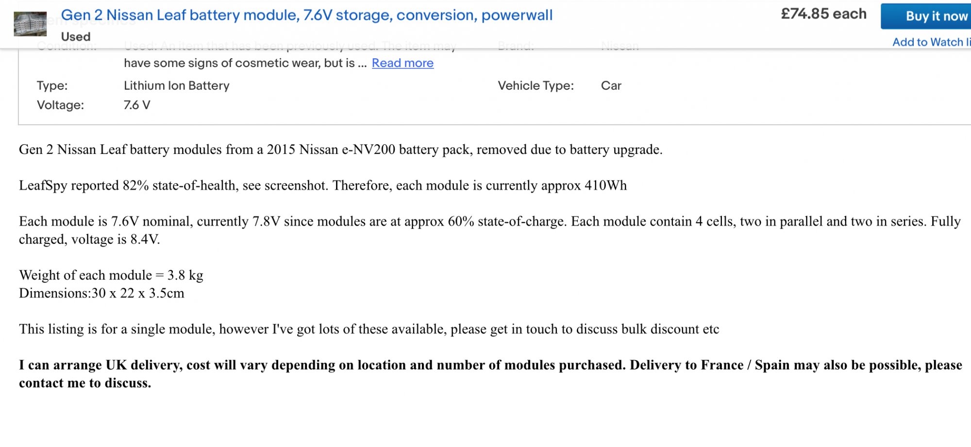

Doing some maths ....
7.6V battery with 410Wh Capacity - converting to numbers people like to think of for Leisure Batteries, that is 53Ah@7.6V
For a typical 12V system, you would need a pair of them in series (to double the voltage) and drop the voltage through a converter to make it suitable for a 12V system, giving you maybe 12V @85Ah (minimal losses in conversion and no power wasted - a big if)
And you then need a Charging system which will run at 16.8V (8.4V is quoted as the fully charged voltage and you are in series so doubling up). That would be a challenge I think.
A typical 12V 100Ah Lead acid battery is quoted as having 1200Wh (12V 100Ah Lithium is 1280Wh), so ignoring any voltage complications, they are a third of the power. To get in the realm of 1200Wh, you need 3 of them, which would be £225.
Not bad if they were lithium batteries pre-packaged, but for what would be a DIY build, more expensive I think than brand new cells that would be a lot easier to configure, use and recharge.
I think there a few people who have repurposed Leaf Batteries in the US, but I don't know if they would do so now and doubt it at that kind of price.
