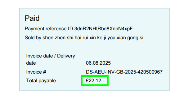

I also ordered this https://amzn.eu/d/1AvE0BL hoping to have a bit more info on what is going on, but it just occurred to me, which battery should I be fitting it too, LB or VB? btw I only paid.
