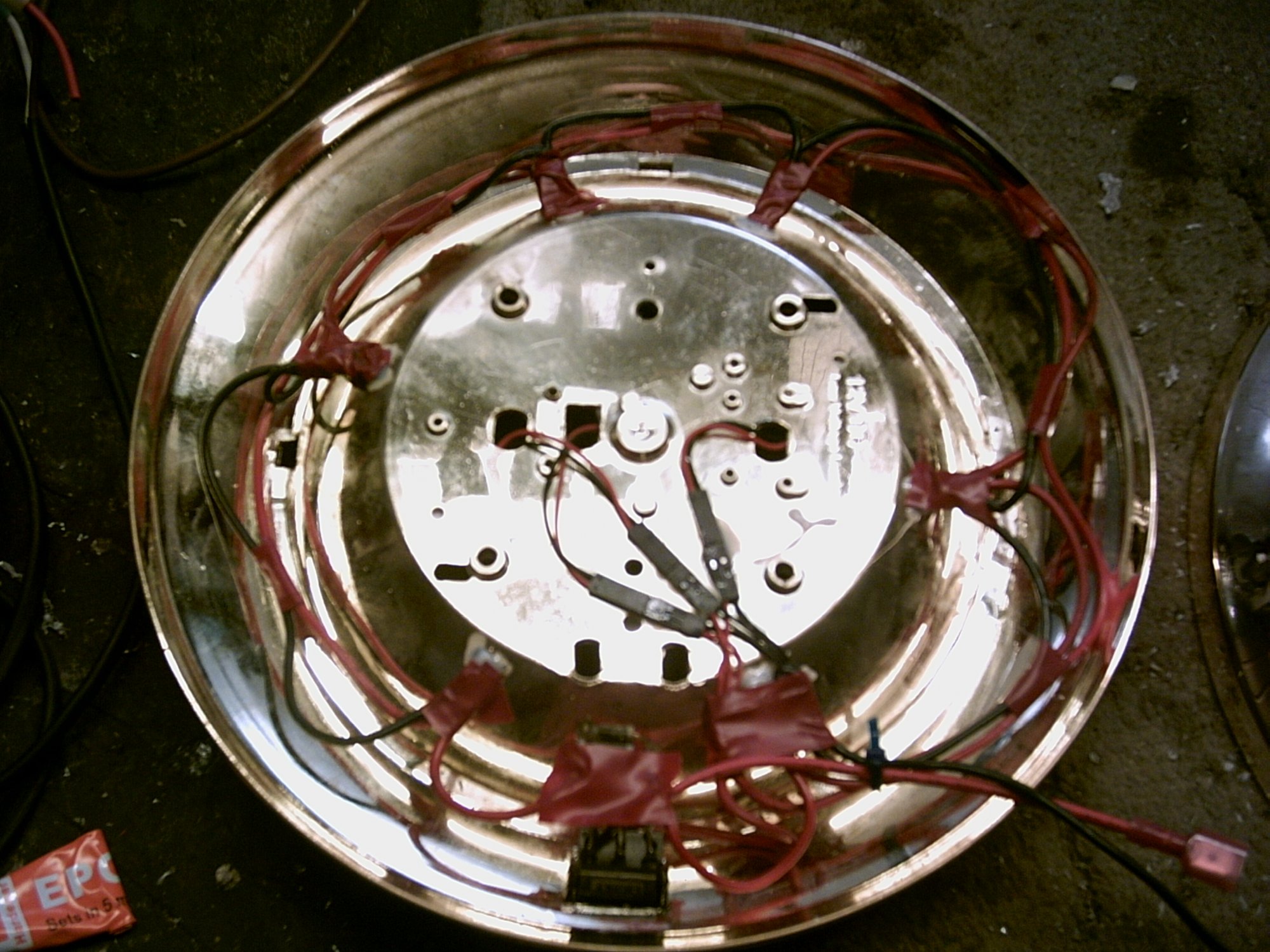

Must be something wrong with battery or lights, i can run all of mine and very little drop with the batteries., then again i built my own lighting units with switchable white or soft.Cheers Bill, My controller fortunately can be set up for Lithium, the charger is whatever Swift fitted in 2007, but the only adjustment is on or off as lithium wasn't really a thing or AGM, we don't use a lot of power, main thing would be charging my chair batteries so would be done on the move mainly, I jsut bought a 5a charger for it as the 2a one would take forever, other than that jsut the usual phones and tablet, and the odd laptop charge and as few lights on as possible, we've always been fairly frugal, this battery drops off a cliff if you put two lights on at the same time, but I've dragged it kicking and screaming for four years.
