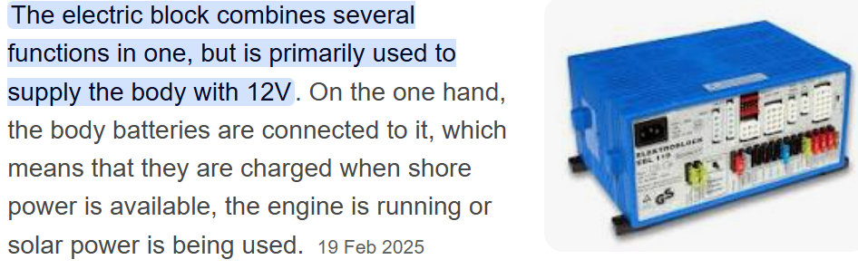

It is an "Electrobloc" not Electric Block, also referred to just as ELBs
It is made by Schaudt (who is now owned by Lippert, an American company) , who in a way are the German version of Sargent - they make lots of different versions of the ELBs. In the same way as if you have a British motorhome, chances are you have a Sargent system, if you have a German Motorhome, you probably have an EBL system.
I fitted an Ablemail AMT12-2 maintainer to one of those EBL119s just a few days ago as it happens :)
For driving, the EBLs just have a relay split-charge setup, no B2B, and is activated by the D+ signal rather than a voltage like a VSR is.
As an aside, your info says "batteries are charged when solar power is being used". Just for clarification, the EBLs (or at least most, including the one in the image) do not have a solar regulator/controller in them. They have a connection where you can connect up the output of the solar controller, but you need the controller - connecting up a panel to that connection would mean putting 20+V onto the battery.

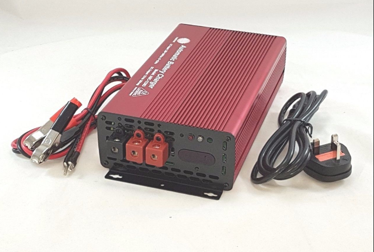

Have you thought about the numax duo 30amp.
No good for liths mind you if you plan to change.
