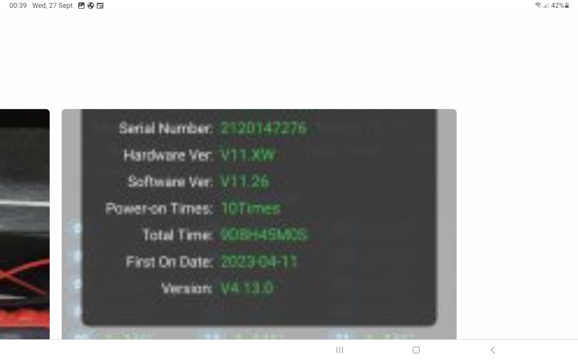

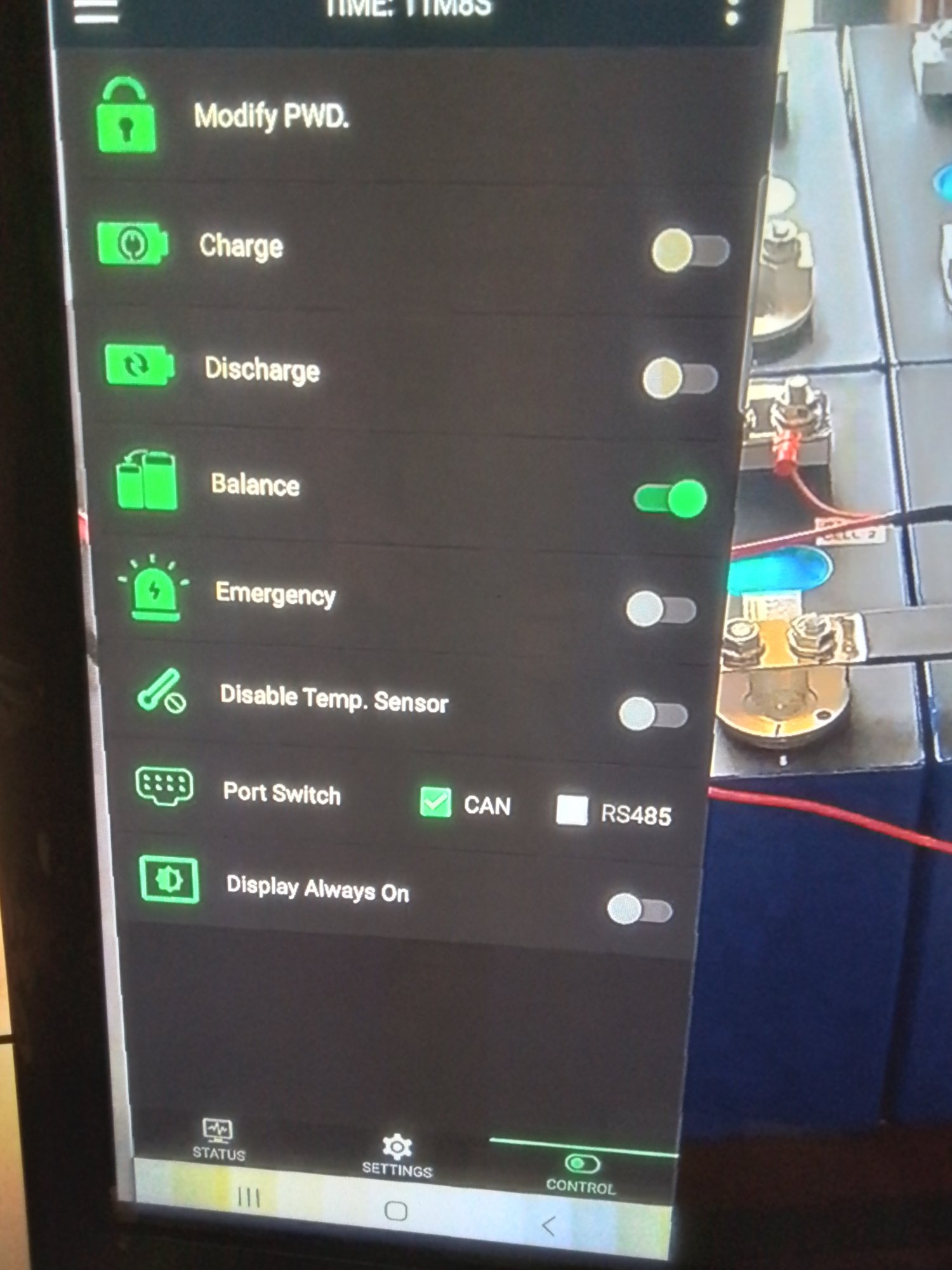

The new software on JK BSM has now 2023 got can bus output or rs-485 port. But is it a software upgrade or new mother board. ...?
Jk bsm as YouTube live may 2023 by
Will my 2022 model have this or can it ?
See post 45 above, the link is there. (y)
Yes thanks just read posts up to now rs485 is what I will use but want usb port for other sensors.
But it's rs-485 I didn't look up that rs-32 unit or is it better for my China battery cell bms ?
Software or hardware? For can bus ! In picture above-mentioned. .?

The new software on JK BSM has now 2023 got can bus 485 port. But is it a software upgrade or new mother board. ...?
Why not simply use a RS485 port to USB adaptor? (Keep the adaptor close to the RS485 port and extend with lead on the USB side.)
Because the cerbo will only see 1 of the 2 batteries I want them both showing on main screen ie 560amp hour not just 280
As They run off 1 product code , as do victron battery's but they show up on main screen.

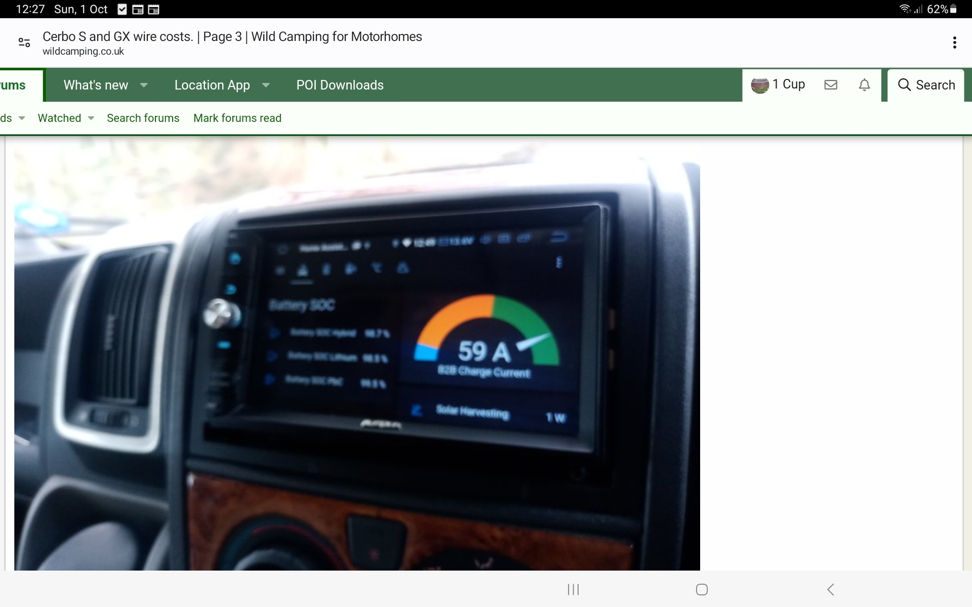

Here is something the geeky ones might want to have a look at .... :D (the key reason for posting this is at the end for the TL:DR folk)
There is a system called "Home Assistant" - this is a nice system and can use and collate information from a variety of sources - including Victron kit.
For example, this is a display I often have active on my dash radio unit so I can see what the B2B is doing:
HA Display B2B by David, on Flickr
A screen grab of that setup...
Screenshot 2023-09-30 at 14-12-35 In-Dash Monitor – Home Assistant by David, on Flickr
This is using data from multiple Victron BMVs fed into the Cerbo GX and then read by Home Assistant (HA)
