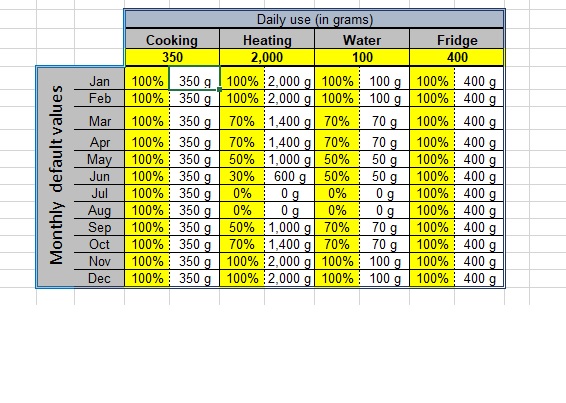

This is the table I use in my UK planing spread sheet.
The fridge and cooking are very similar.
The biggest usage is heating during most months.
Based on experience since 1973.
