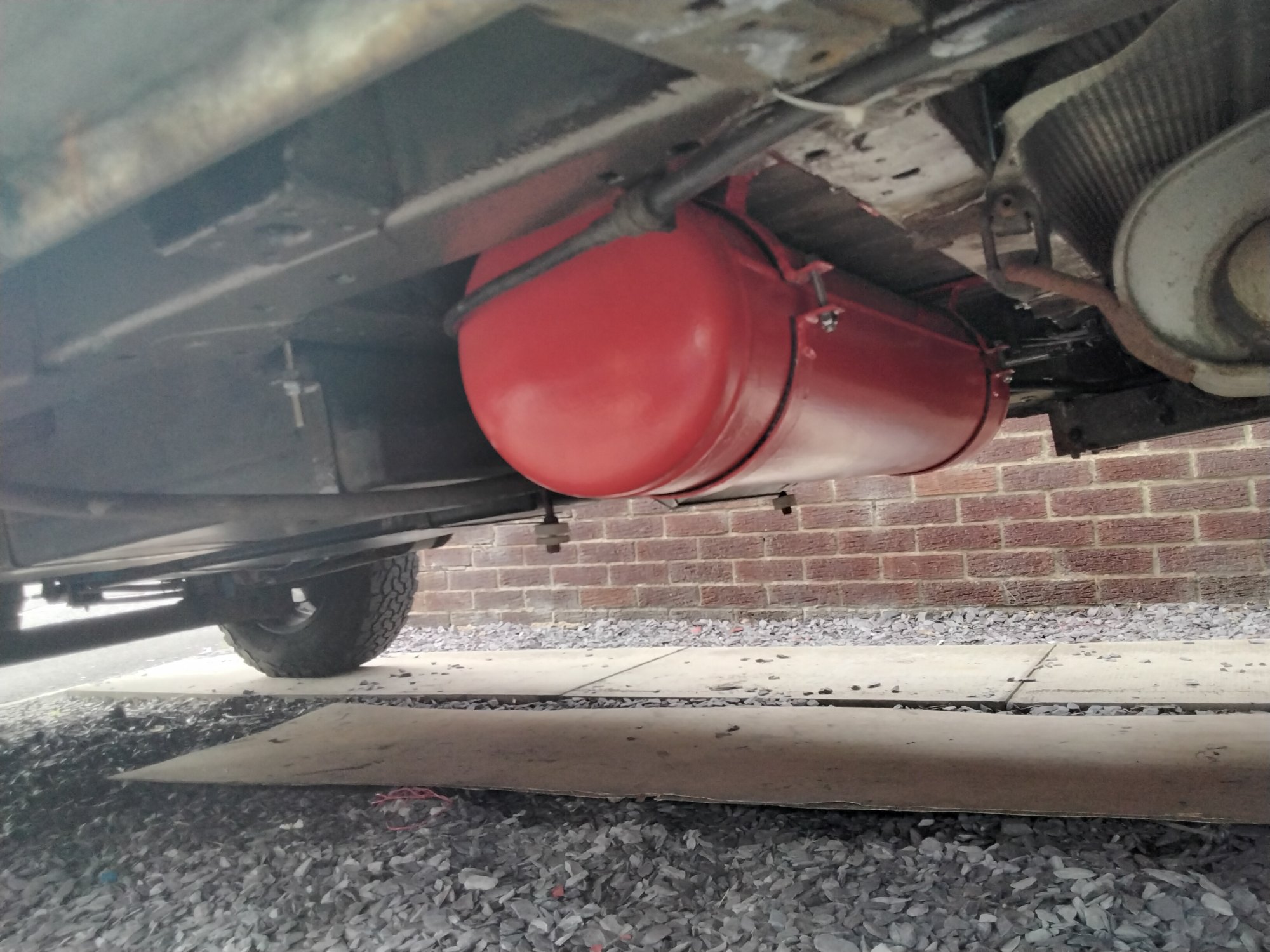

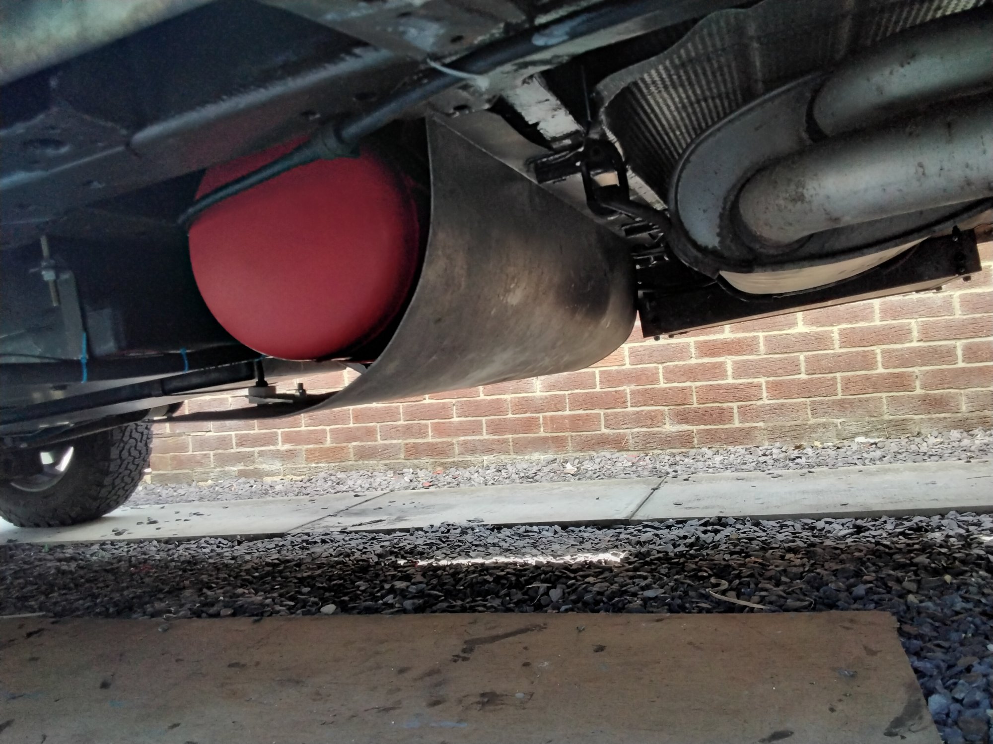

I only ever had a 38ltr underslung tank and have never run out of gas.and as you can see its well protected by the alloy guard.
I only ever had a 38ltr underslung tank and have never run out of gas.and as you can see its well protected by the alloy guard.View attachment 142503
Thats a good size but even with that I would be tempted to want a Calor backup as a long stay in say the Scottish islands we would eventually run out.
